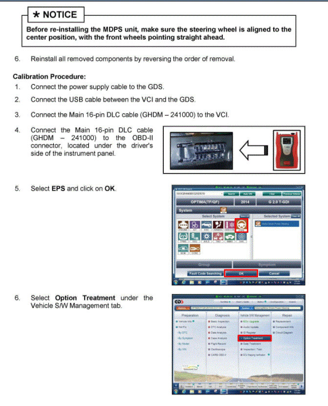

I replaced the flex steering coupler now I don’t have power steering and now the EPS an ESP lights are on.
Sep 25, 2021 at 6:41 PM
  • 110,194 POSTS
First, there is a technical bulletin regarding this component. If I understand correctly, Kia is replacing them free of charge. It isn't a recall, but they recognize a problem.

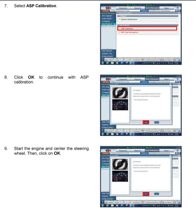

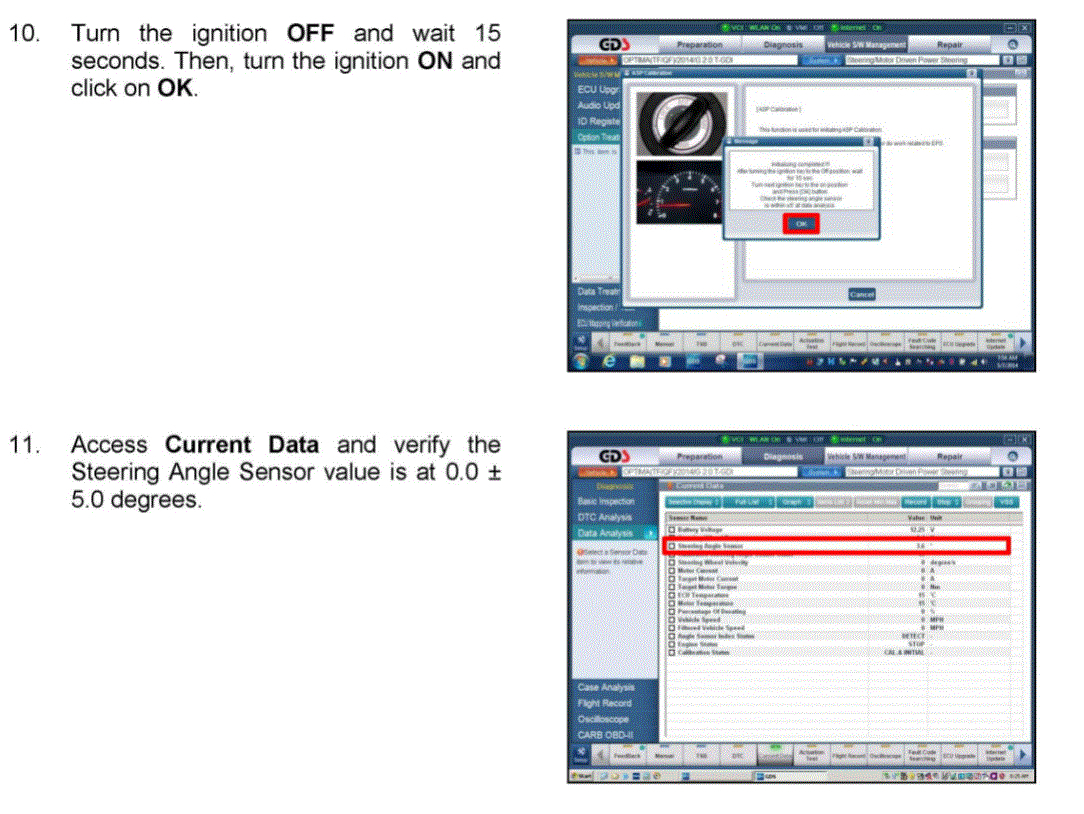

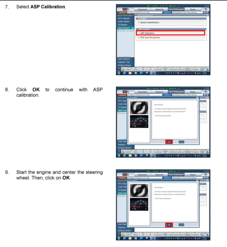

As far as the new problems you have, the system needs to be recalibrated after doing the work. You will need a scan tool that can communicate with the modules involved.
I attached the recalibration procedures below.
