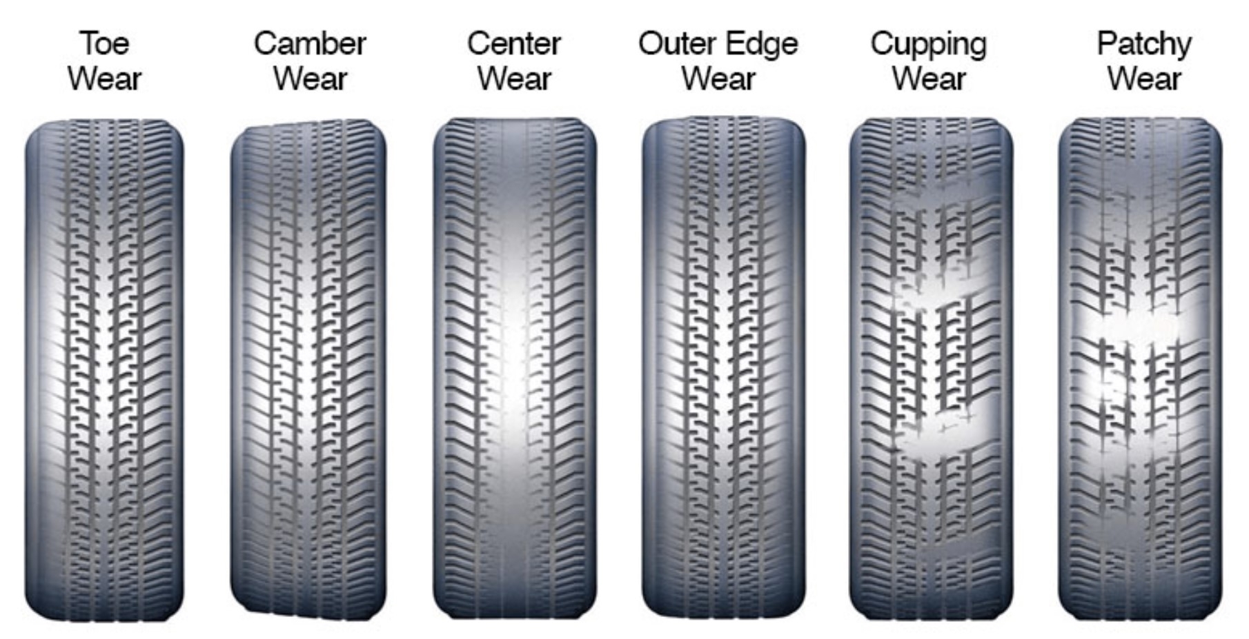

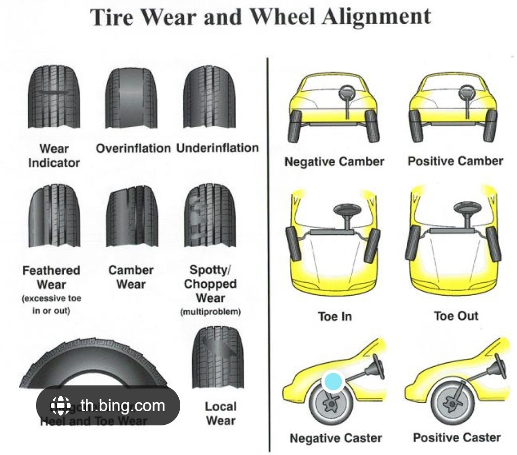

Any change in tire size or do you have the original tire size? What about your tires condition? Do any of them have more tread than the others, especially on the right side?
