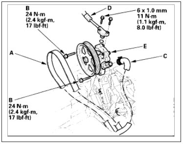

Good afternoon. Where do I disconnect the power steering pressure line on the driver side? What tools do I need?

Removal and installation:
Replacement
Place a suitable container under the vehicle.
Drain the power steering fluid from the reservoir.
Remove the drive belt (A) from the pump pulley.
Remove the pump mounting bolts (B).
Cover the auto-tensioner, alternator, and A/C compressor with several shop towels to protect if from spilled power steering fluid. Disconnect the pump inlet hose (C) and pump outlet hose (D) from the pump (E), and plug them. Take care not to spill the fluid on the body or parts. Wipe off any spilled fluid at once. Do not turn the steering wheel with the pump removed.
Connect the pump outlet hose and inlet hose to the pump. Tighten the pump fittings securely.
Install the pump in the pump bracket with the mounting bolts.

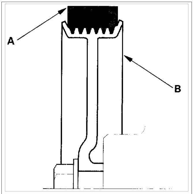

Install the drive belt (A). Note these items during belt installation:
Make sure that the belt is properly positioned on the pulleys (B).
Do not get the power steering fluid or grease on the auto-tensioner, alternator, A/C compressor, and drive belt or pulley faces. Clean off any fluid or grease before installation.

I wanted to get what our manual shows to you first. Your other questions. If you see in the picture, letter C and D is the hose. It does not appear from what I see that you need any special tools.
