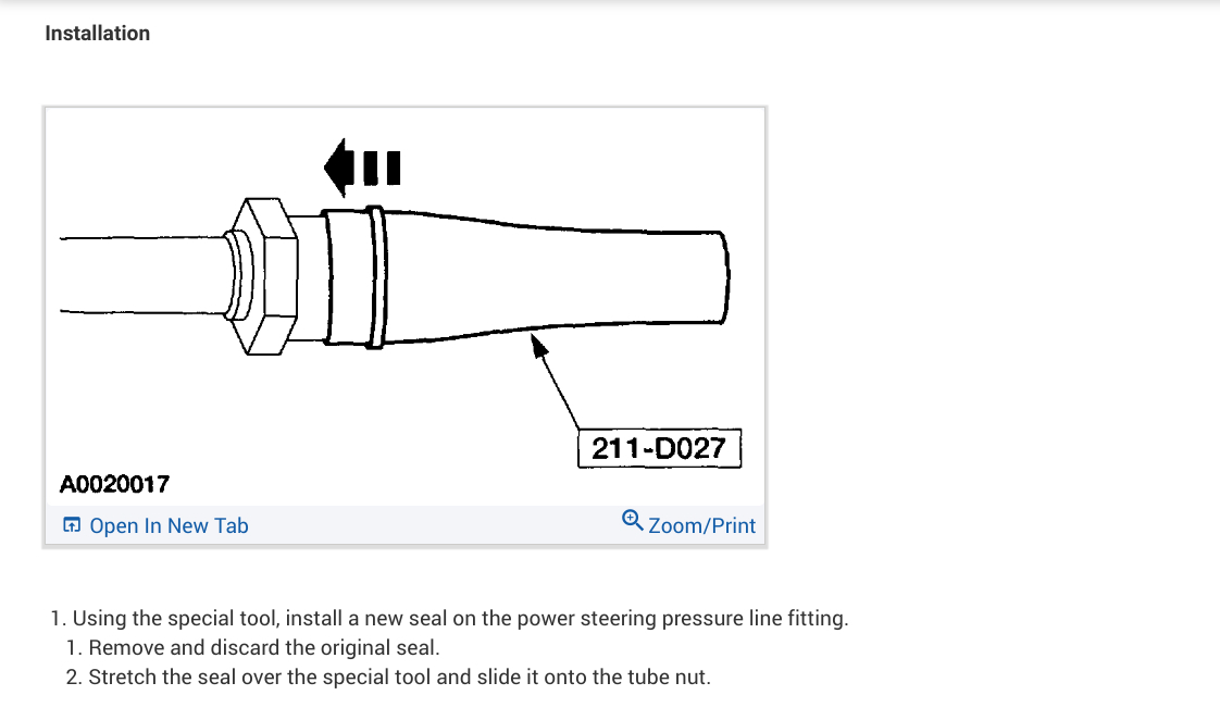

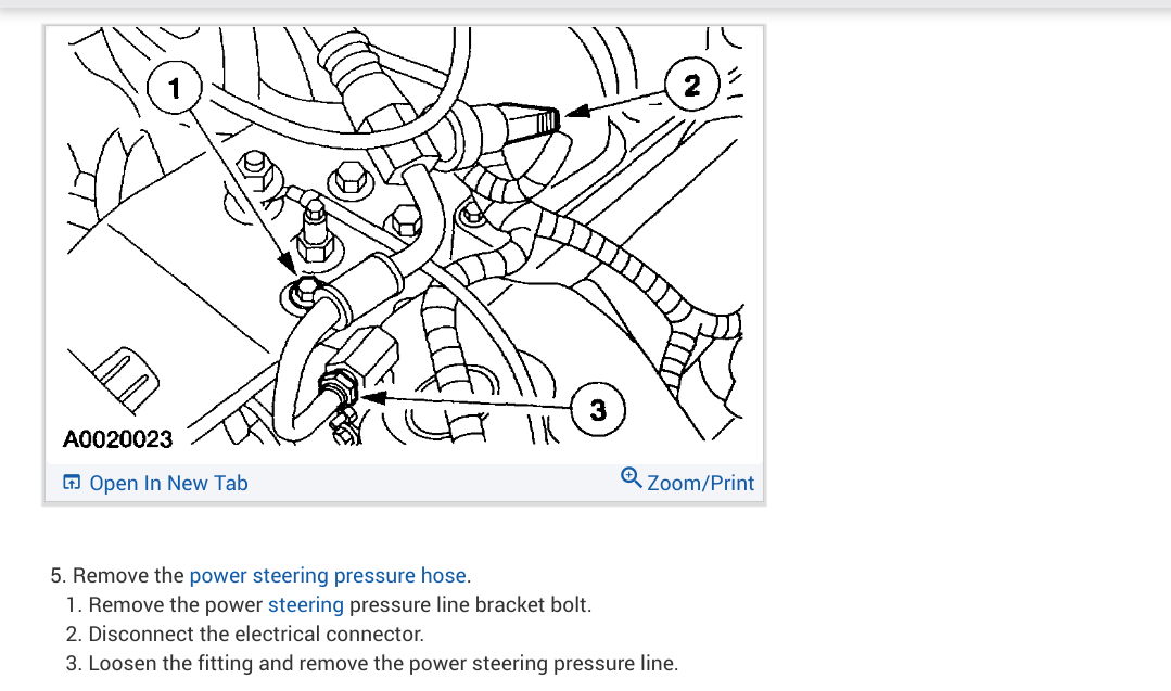

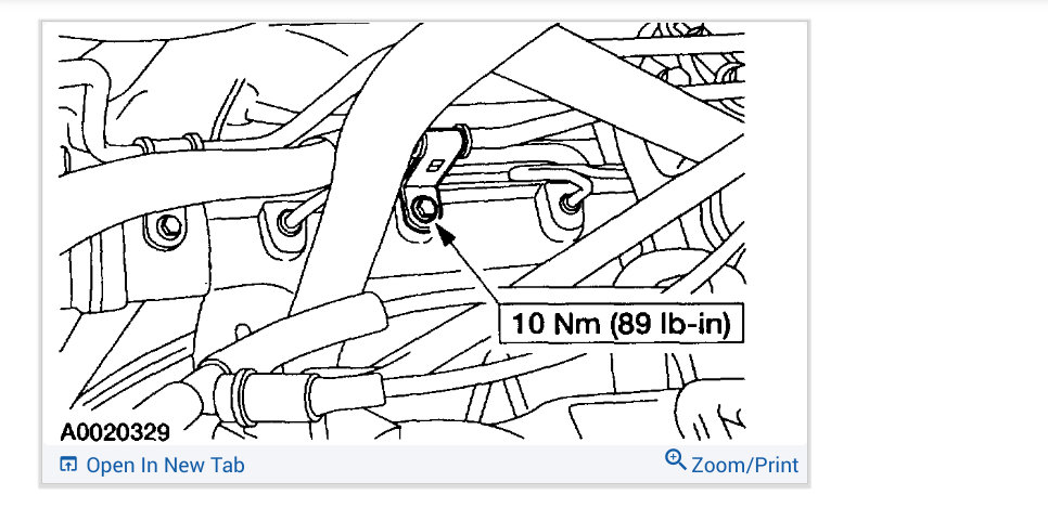

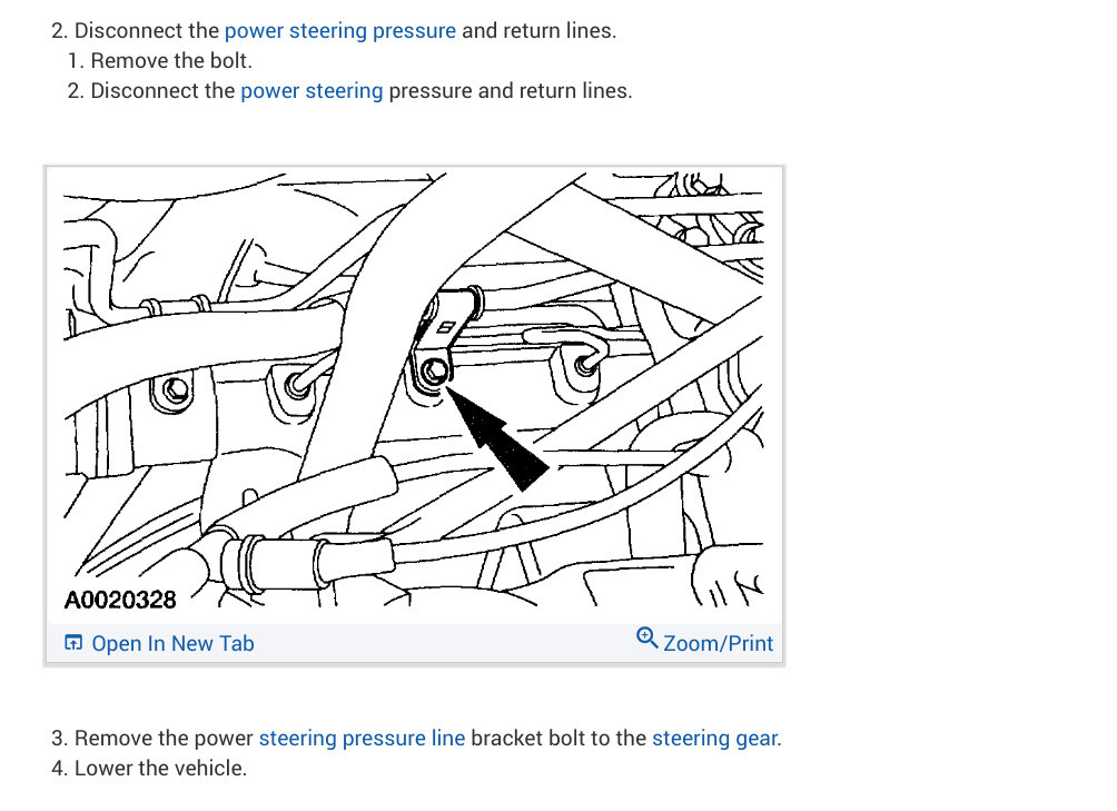

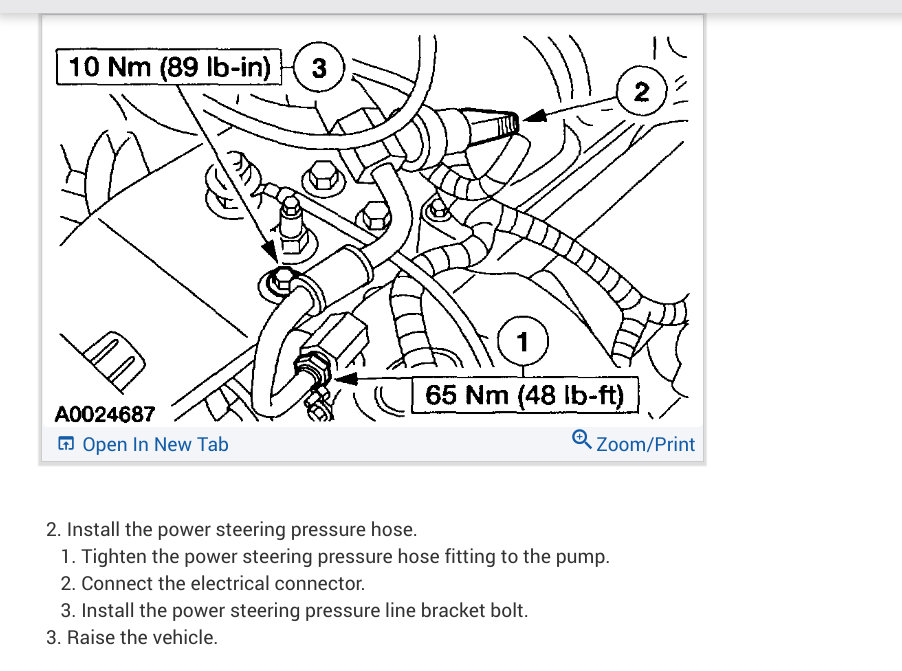

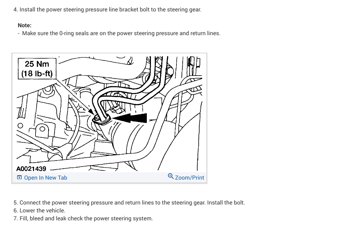

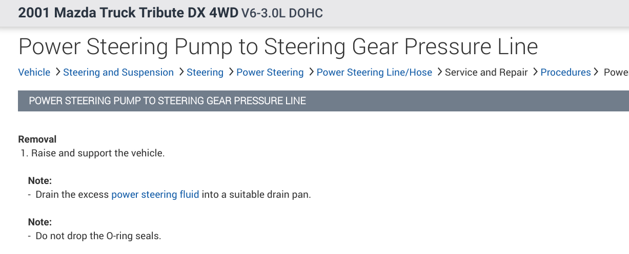

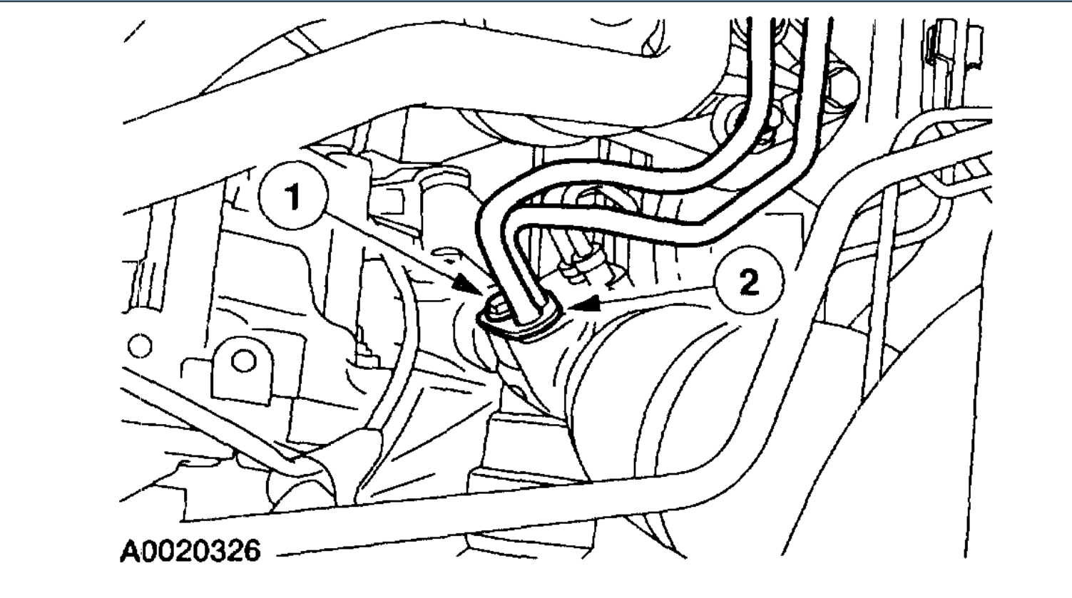

I have included the information that you requested, the instructions for the removal and installation of the pressure power steering line for your vehicle, in the diagrams down below. I hope that this helps.

Do you have step by step instructions not just pictures?

The diagrams I sent earlier are the step by step instructions from the vehicle manufacturer for the high pressure power steering hose replacement for your vehicle. They just happen to have pictures to help you understand what they are explaining. Please keep us informed on how everything turns out.

The answer I got was not detailed enough.

The diagram is too hard for me to follow.
