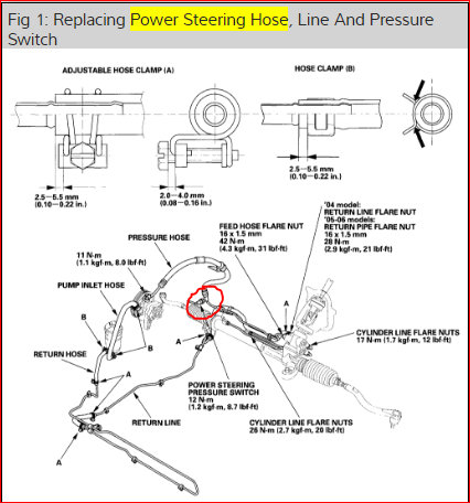

How to remove the power steering pressure hose? I have removed everything but am stuck on the sub-frame? It just will not come out. What am I missing? The line is undone, need to pull it out of the sub-frame. I have undone the clamps, undone the hose, just need to pull it out.

I am attaching a picture for you with the pressure switch circled in red. Do you think this could be the hang up pulling out the pressure hose? Sometimes there are clamps (metal or plastic) that are used to attach to frame/body to keep secure. Hope this helps! Let me know if you have any questions.
