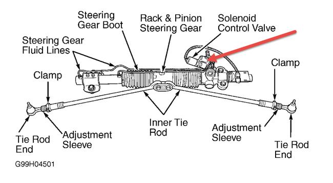

you need a scan tool to check for electrical problems. the item I have pointed out in pic may be your problem but without ascan tool to check it your screwed. Because the body module an dvehicle speed sensor tell the solenoid how large to open the orfice in that.

this particular vehicle has a bcm?
the info can only be provided through bcm and not pcm?
if so then yes I am screwed. currently own a Verus
Jun 24, 2014 at 10:36 AM
HMAC300
  • 48,601 POSTS
all OBD2 cars and a lot of OBD1 vehicles have a bcm. actually the pcm tells the bcm a few things then the bcm opens the solenoid so it varies the orfice to give better control over power steering. if the verus can read the bcm then it should give you codes.

Negative on Verus (older Verus) reading bcm, it only reads pcm/ecm. I took a look again and no solenoid on the power steering system unless I'm looking in the wrong area.

if you don't have variable assist steering then you won't have the solenoid.
