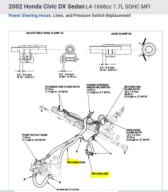

How do you replace the power steering hose that goes to the power steering rack and returns to the reservoir?
2002 HONDA CIVIC
189,000 MILES • 1.7L • 4 CYL • 2WD • AUTOMATIC
IFYUSER
  • 54 POSTS
Power steering low side return hose from power steering rack to reservoir It's the low pressure one.

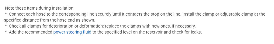

The directions I was able to find are somewhat vague. I did attach them below for you. As far as the low pressure/return line, do you need to replace the entire thing? It has both metal and rubber components. In most cases, the steel doesn't fail unless it is rusted.
Take a look through the directions below and let me know if they help or if you have questions.
Take care and let me know.
