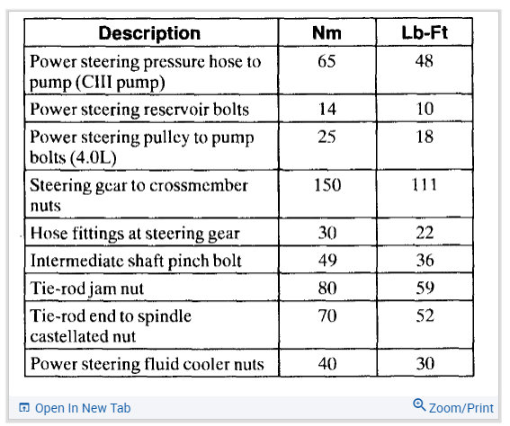

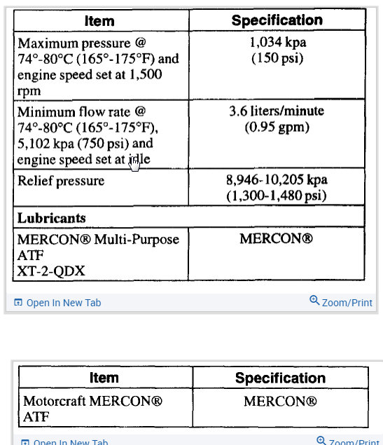

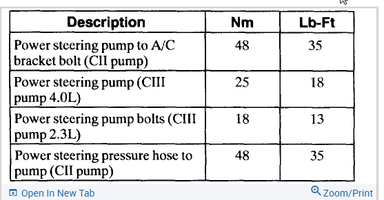

What is the specified torque value for the clamp plate nut that secures the pressure/return line ends to the rack and pinion and also the pressure line to pump torque value?
Dec 12, 2019 at 11:09 PM
Looks like each of these has the numbers you are look for. Let me know if you need more. Check out the diagrams (Below). Please let us know if you need anything else to get the problem fixed. Thanks
