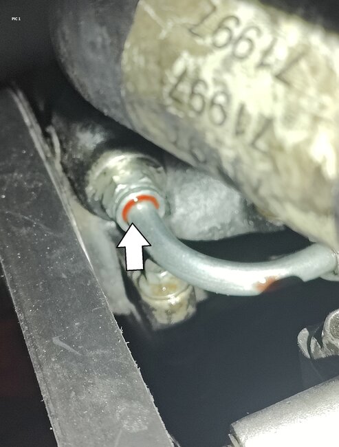

My power steering line is leaking at the pump as shown in Pic 1. I have already changed teflon o ring that goes below the threads that go into the pump (Pic 2).

Yep, the outside seal is not what is leaking it is the internal seal is bad which cannot be replaced separately so you will need a new hose, sorry. Thanks for the images, they helped.
