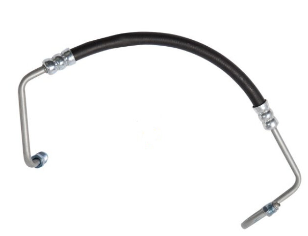

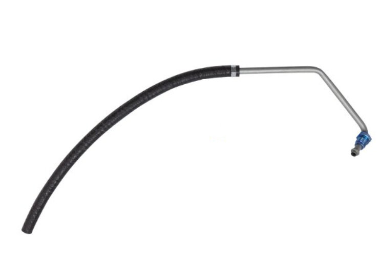

The system is somewhat basic. You have a pump that pressurizes fluid. It travels through the high-pressure hose to the steering gear. In this case, it has a Saginaw 708 series integral power steering gear. Pressure is equalized on two sides of the gear allowing it to assist when turning. From there, the fluid is recirculated back to the pump via a low-pressure hose.
In most cases, the low-pressure hose will simply be clamped on at the pump. (See pic 1) The high-pressure hose will have a steel threaded connector at both ends. (See pic 2)
Let me know if this helps or if you have questions.

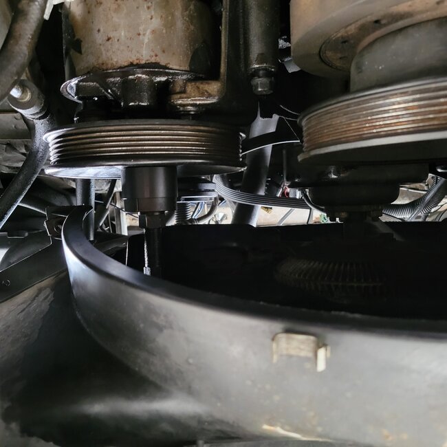

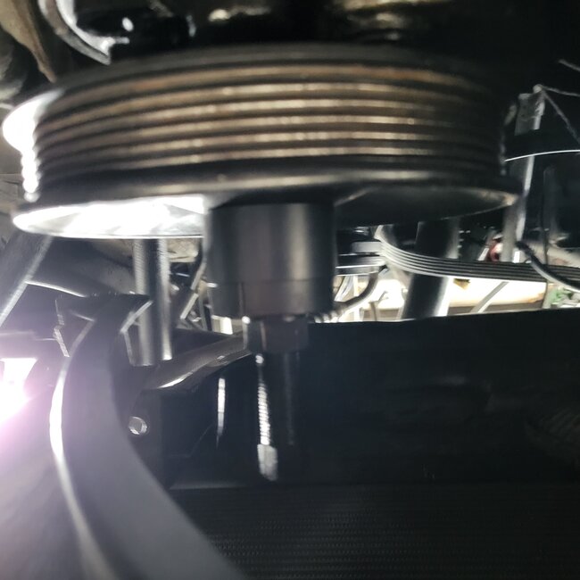

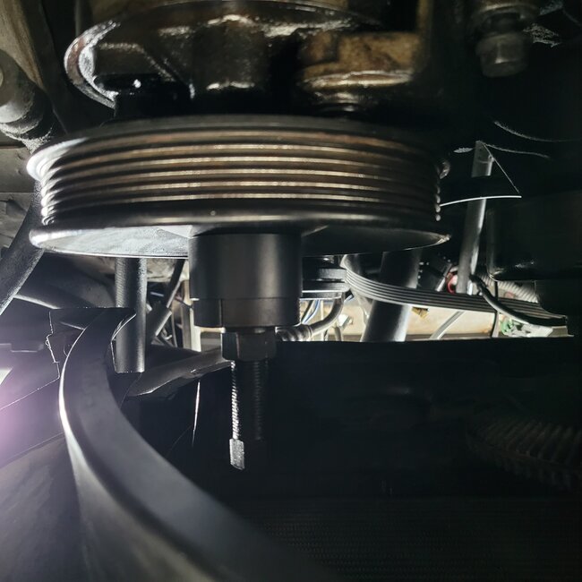

I bought a power steering pump pulley puller so I can get at the mounting bolts and remove the pump to swap it out. However, It's proving to be near impossible. I can't seem to get enough force or space to hold the nut at the base of the puller and ratchet the driving bolt in. Any suggestions? I couldn't find anything about it in my Hanes manual. They conveniently only show how to remove the mounting bolts after the pulley is removed.

These pictures are from underneath my 95' Chevy G30. The power steering pump has the puller on the pulley and its in the fan shroud.

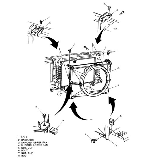

Anything to make it a bit more difficult. LOL If you can't get a good angle to it with the shroud on, then you need to remove it. There are six screws that hold it on, two on top, in the middle, and at the bottom. See pic below.
It will be likely that the fan blade itself will need to be removed. I can usually work them off a little at a time. Just be careful not to puncture the radiator with the shroud, It can happen.
Let me know if this helps.
See pic below.
