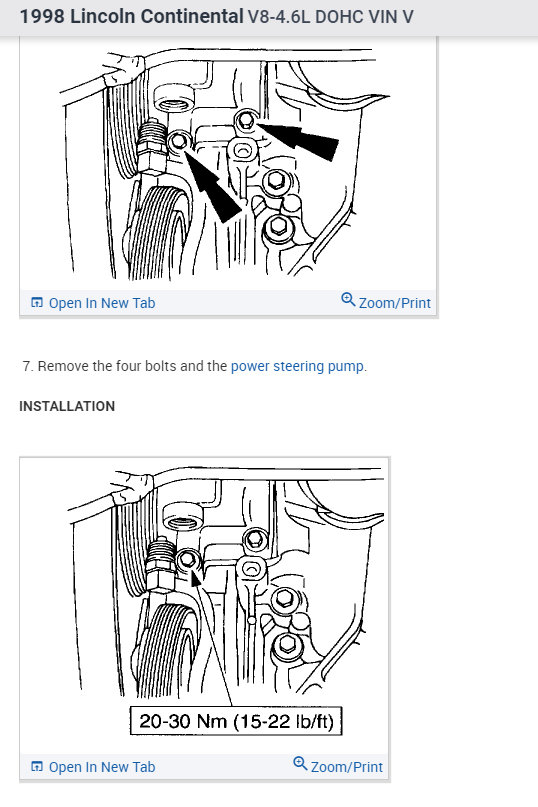

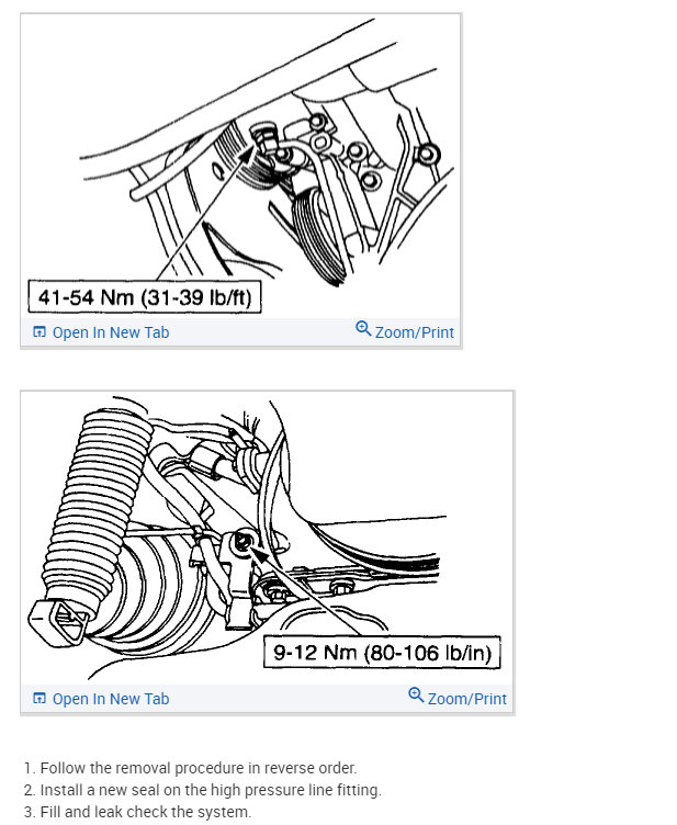

Installed new rack and pinion but now as soon as I start it fluid comes out of power steering pump. Don't know what I could have done wrong.
Tuesday, November 16th, 2021 AT 7:38 AM
SQM
  • 6,383 POSTS
Does the fluid leak from where the hose connects to the pump?
It could have a bad threads or cross threaded. Did it have an O-ring/washer when you remove it?
If the bolts are not torqued properly, it can leak as well.
Let me know what you are experiencing.
Thank you
https://www.2carpros.com/articles/how-to-replace-a-power-steering-pump
