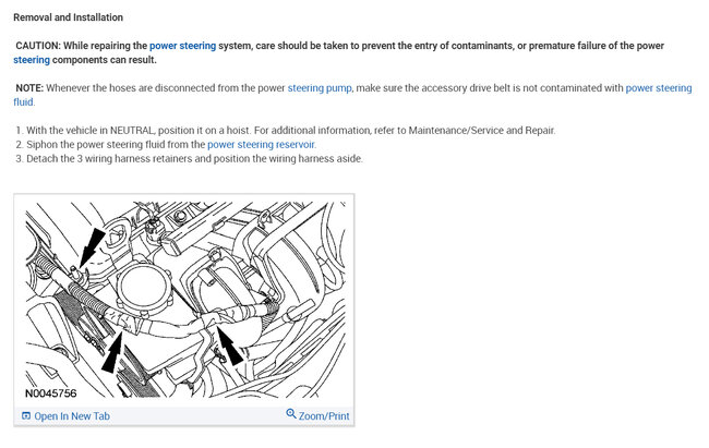

The high-pressure pipe burst, replaced the pipe still seems to be leaking around the front of near the pump, but sure what to do now.
Oct 16, 2022 at 3:25 PM
  • 55,433 POSTS

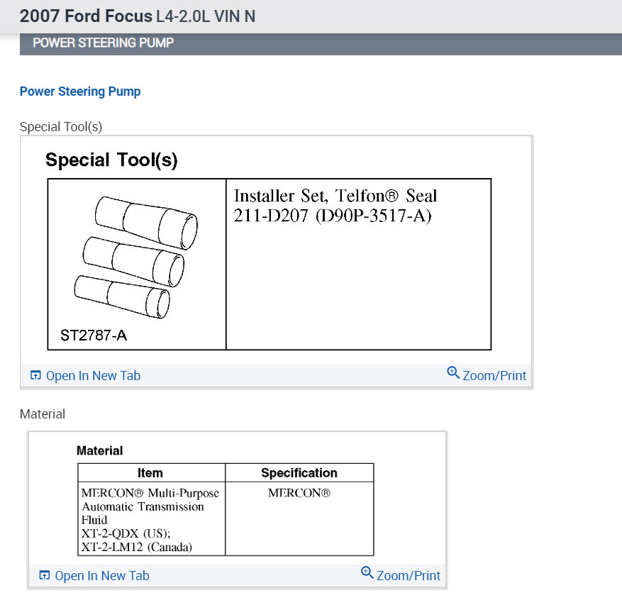

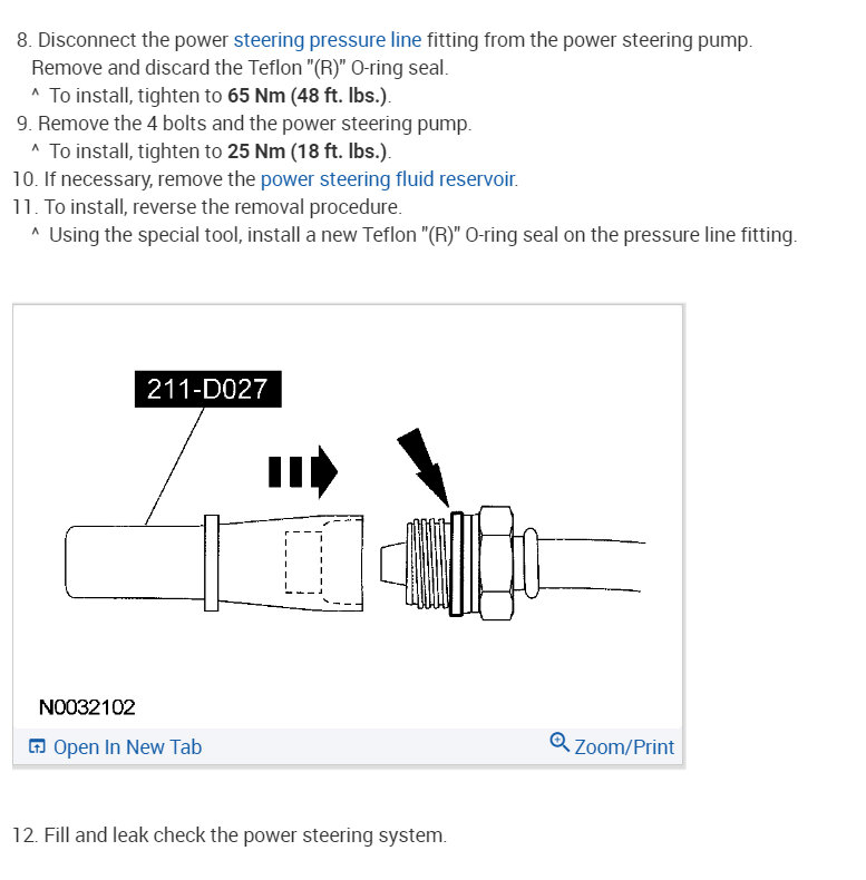

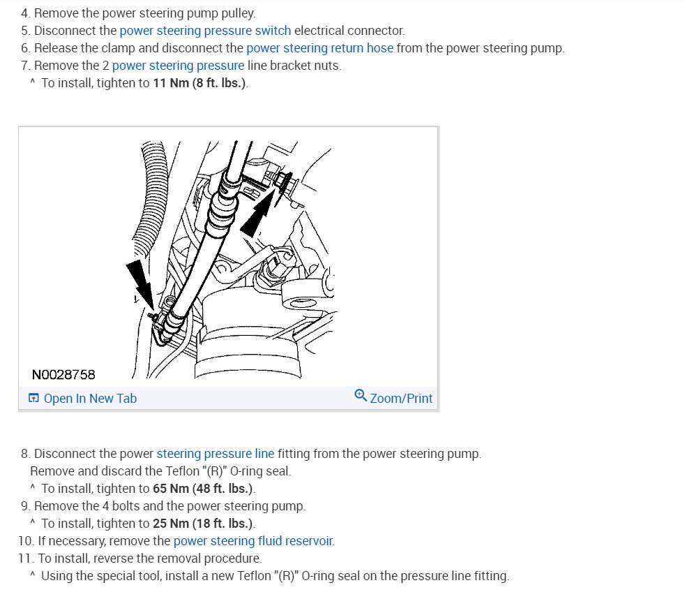

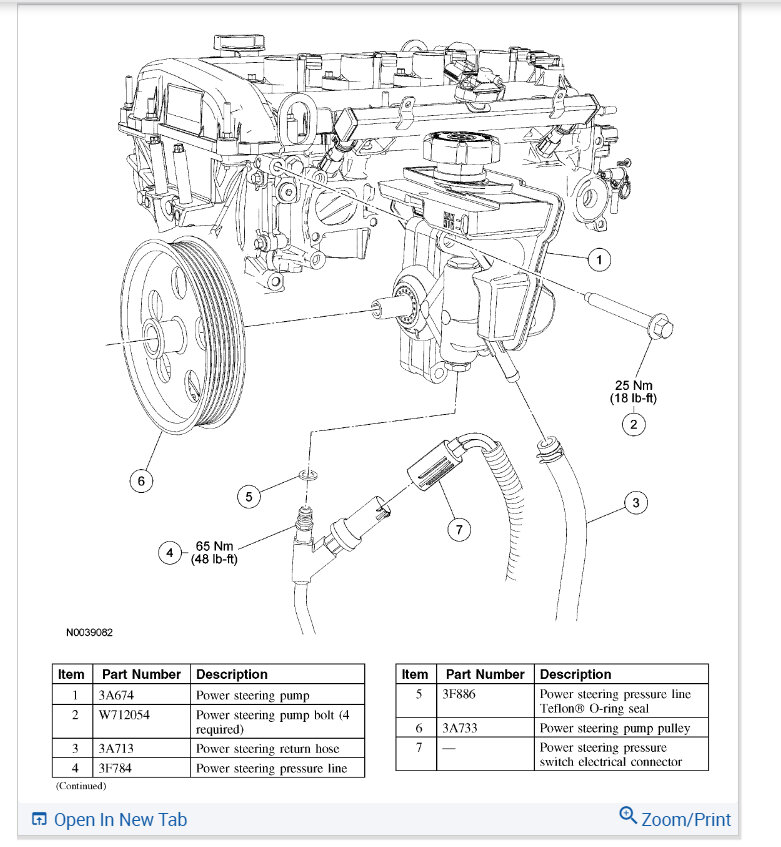

It happens, it sounds like the pump seals have gone out. here is how to replace the pump step by step in this generic guide with instructions in the images below to show you how on your car:
https://www.2carpros.com/articles/how-to-replace-a-power-steering-pump
Check out the images (below). Please let us know if you need anything else to get the problem fixed.
