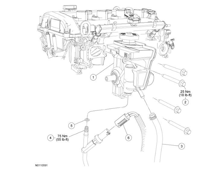

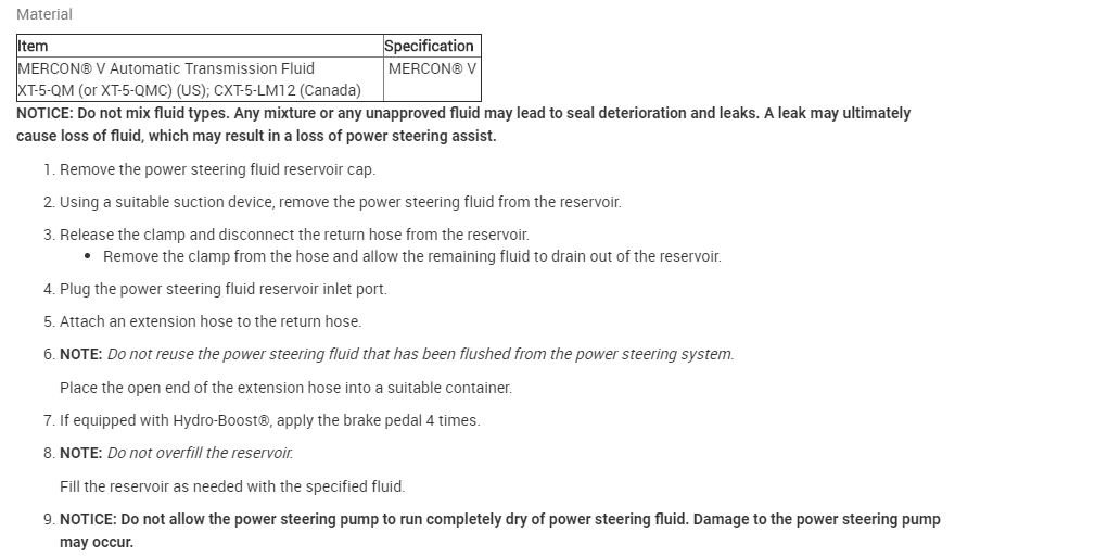

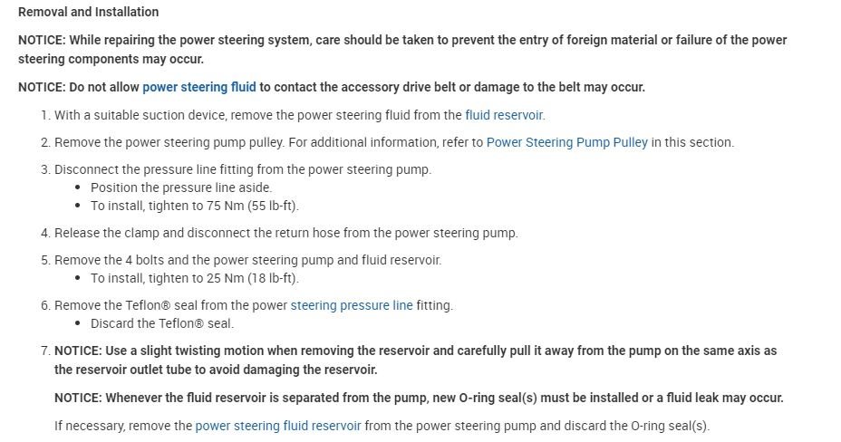

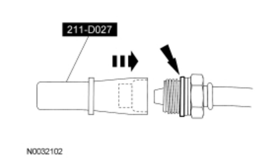

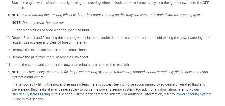

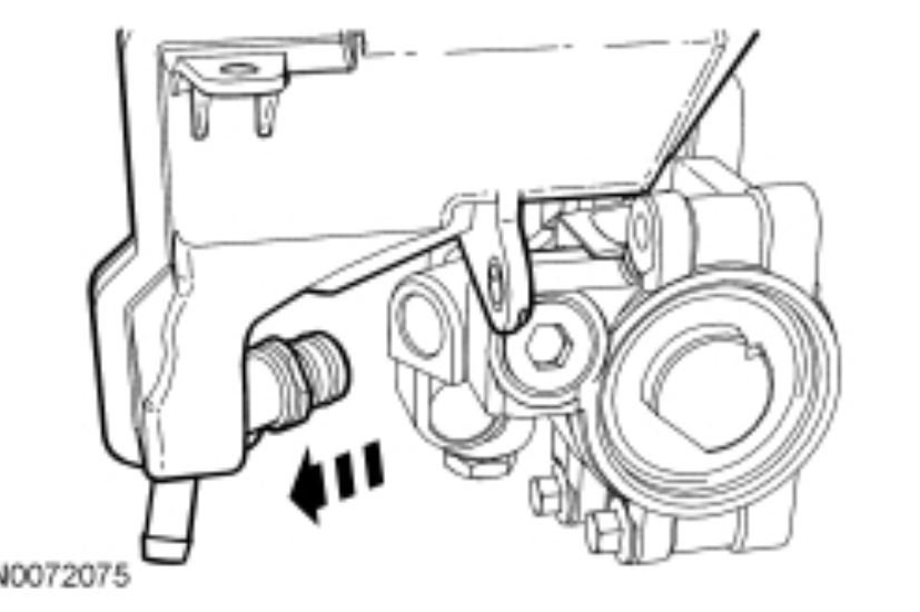

Good morning,
The Barrs leak was a very bad idea. That will eventually fail the seals in the steering rack. That product has brake fluid in it which swells the seals and the seals will expand and fail,
Yes, it sounds like the pump has failed and needs to be replaced. Before you replace the pump, I would flush the steering system of all the old fluid so no contamination gets into the new pump.
https://www.2carpros.com/articles/power-steering-fluid-flush
https://www.2carpros.com/articles/how-to-replace-a-power-steering-pump
I attached the procedure for flushing as well as the replacement of the pump.
