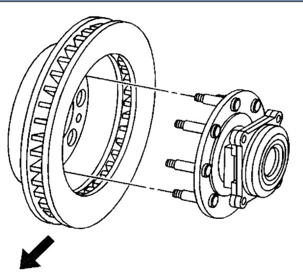

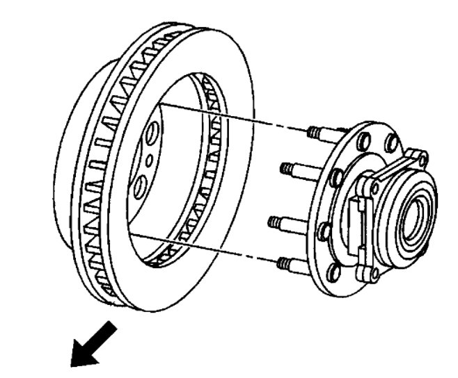

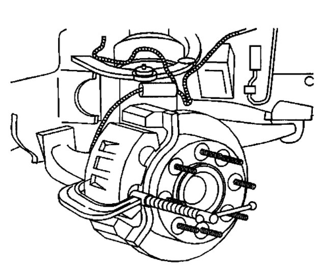

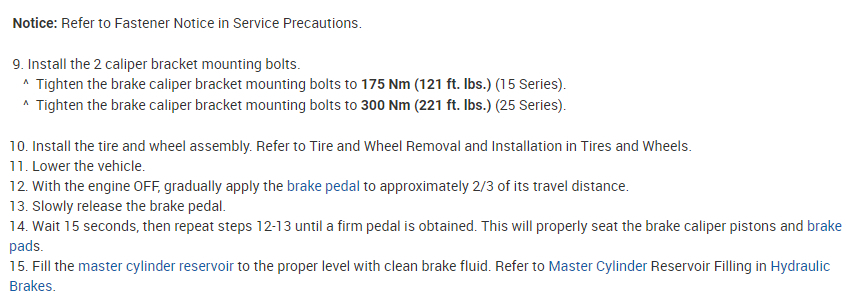

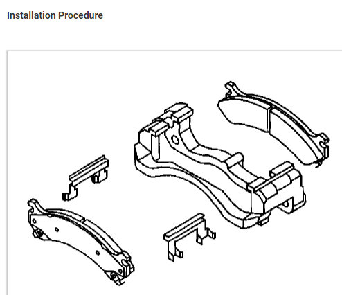

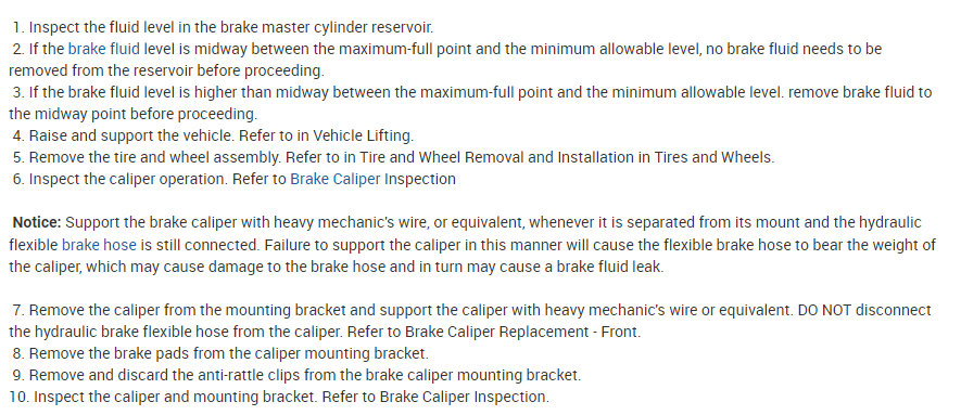

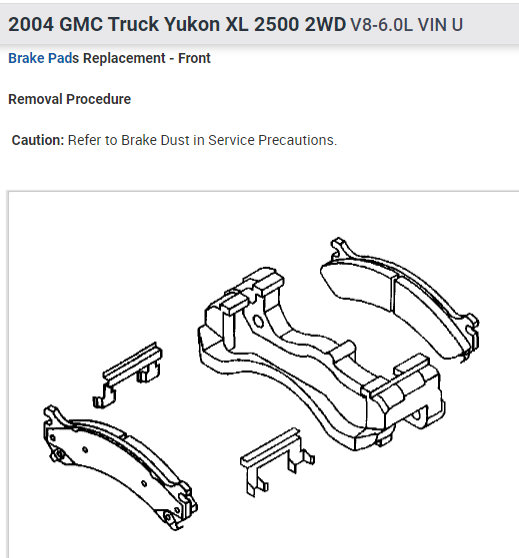

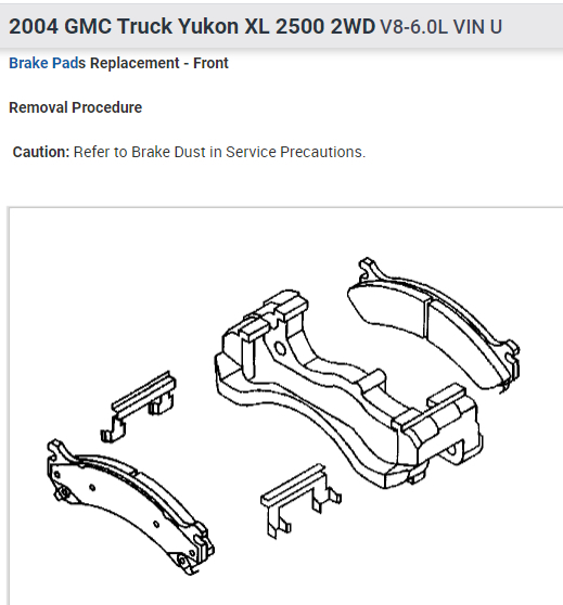

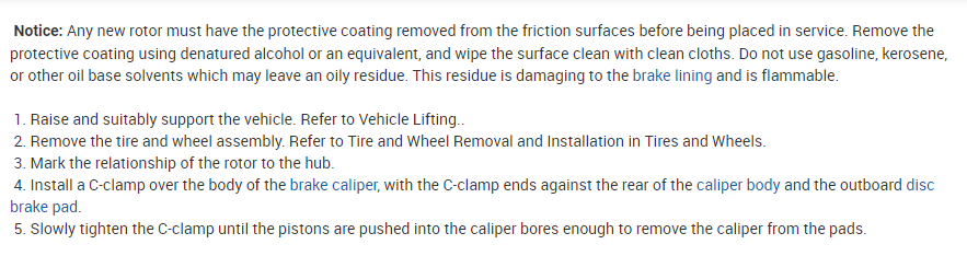

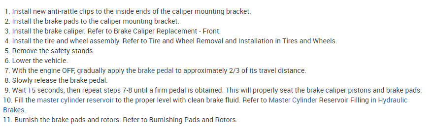

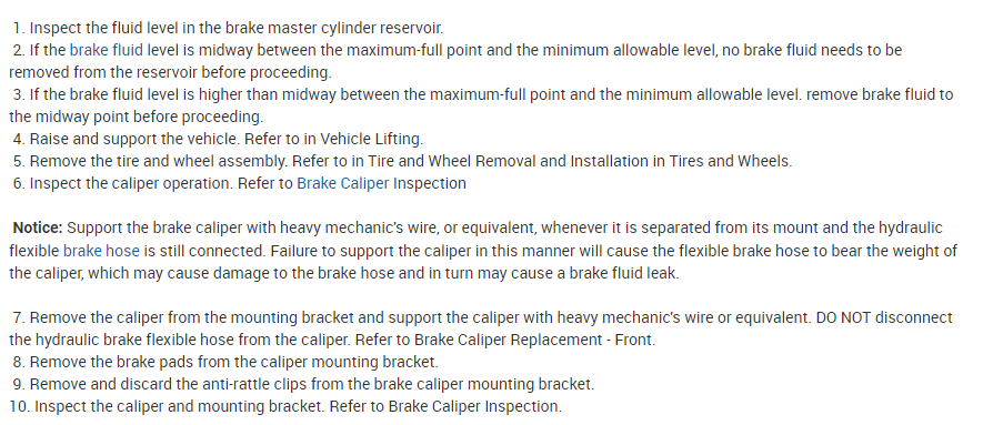

The brake noise is obnoxious and would I be able to do them I have a bunch of tools
Tuesday, April 23rd, 2013 AT 12:19 AM
DANNY L
MECHANIC
5,648 POSTS
Hello, I'm Danny.

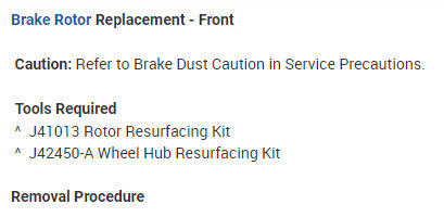

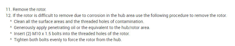

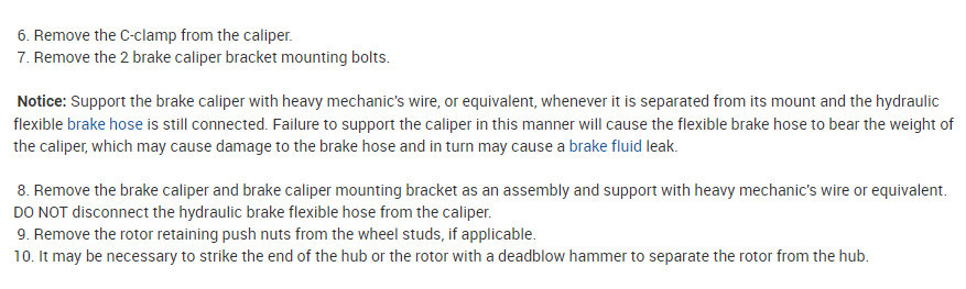

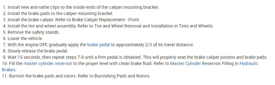

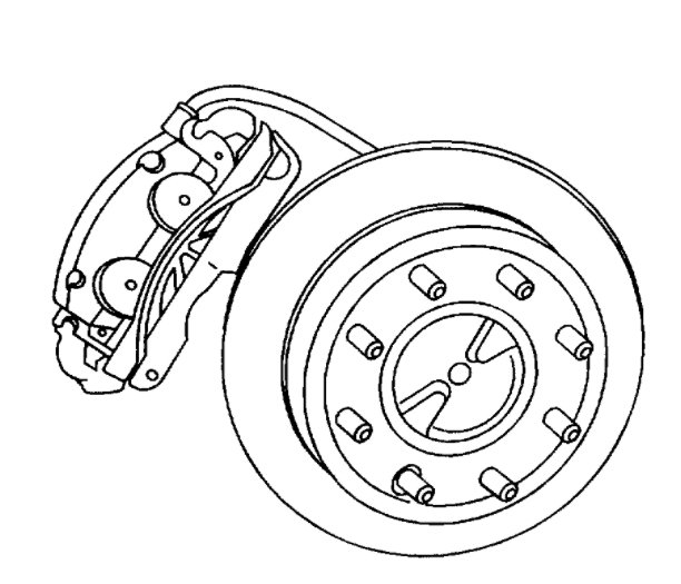

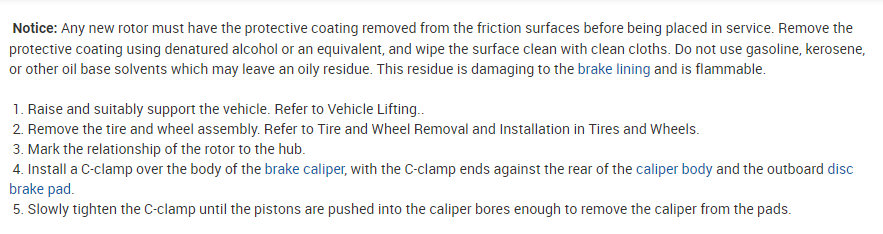

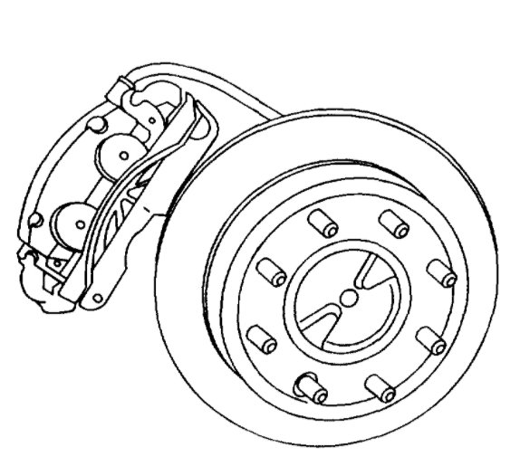

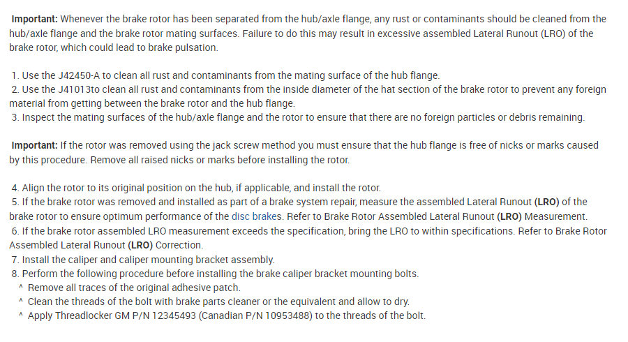

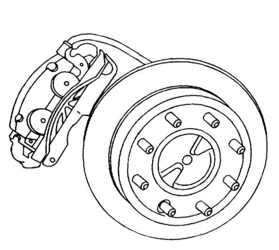

Here is the information you requested. This is a tutorial showing what is involved on how to change front brake pads and brake rotors:
I've attached picture steps below on how to change the front brake pads and rotors on your truck. Hope this helps and thanks for using 2CarPros.
