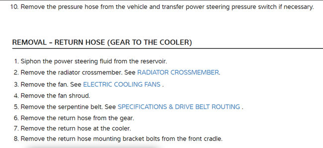

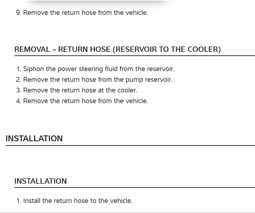

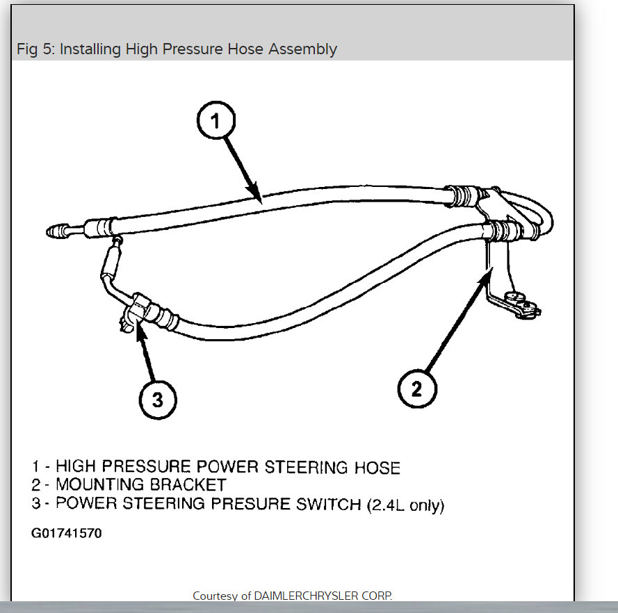

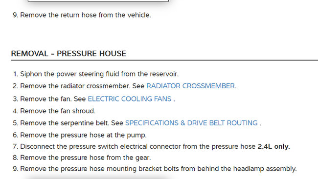

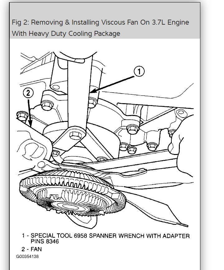

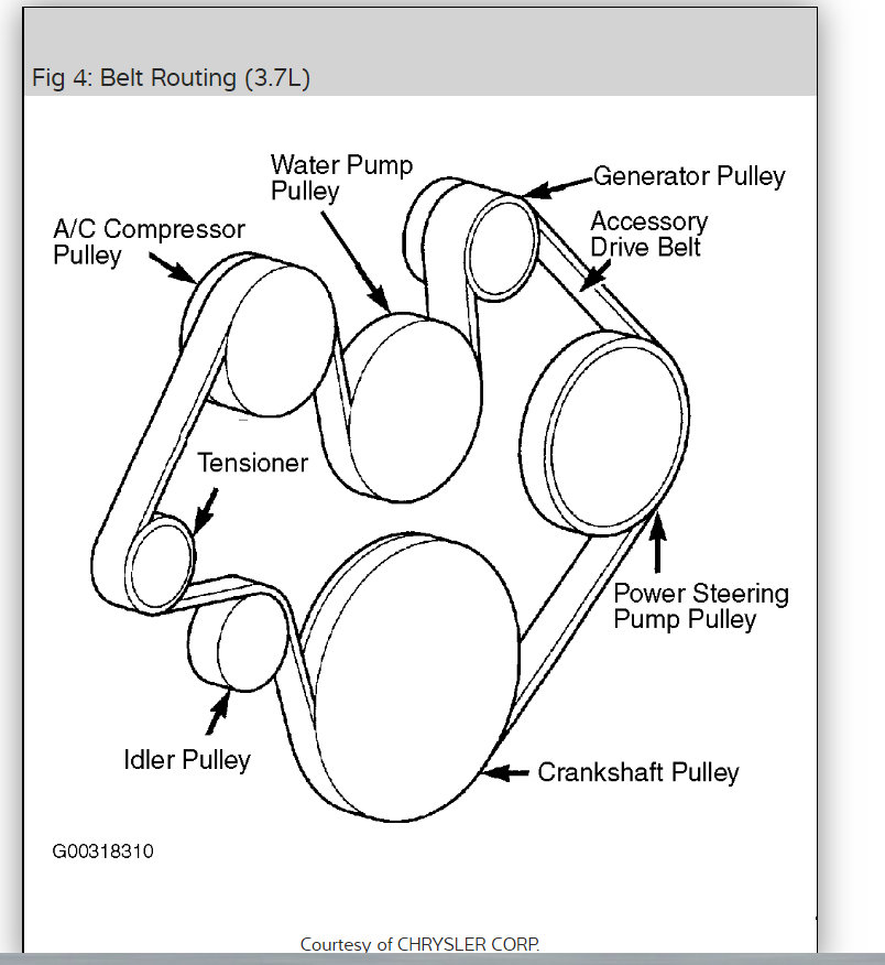

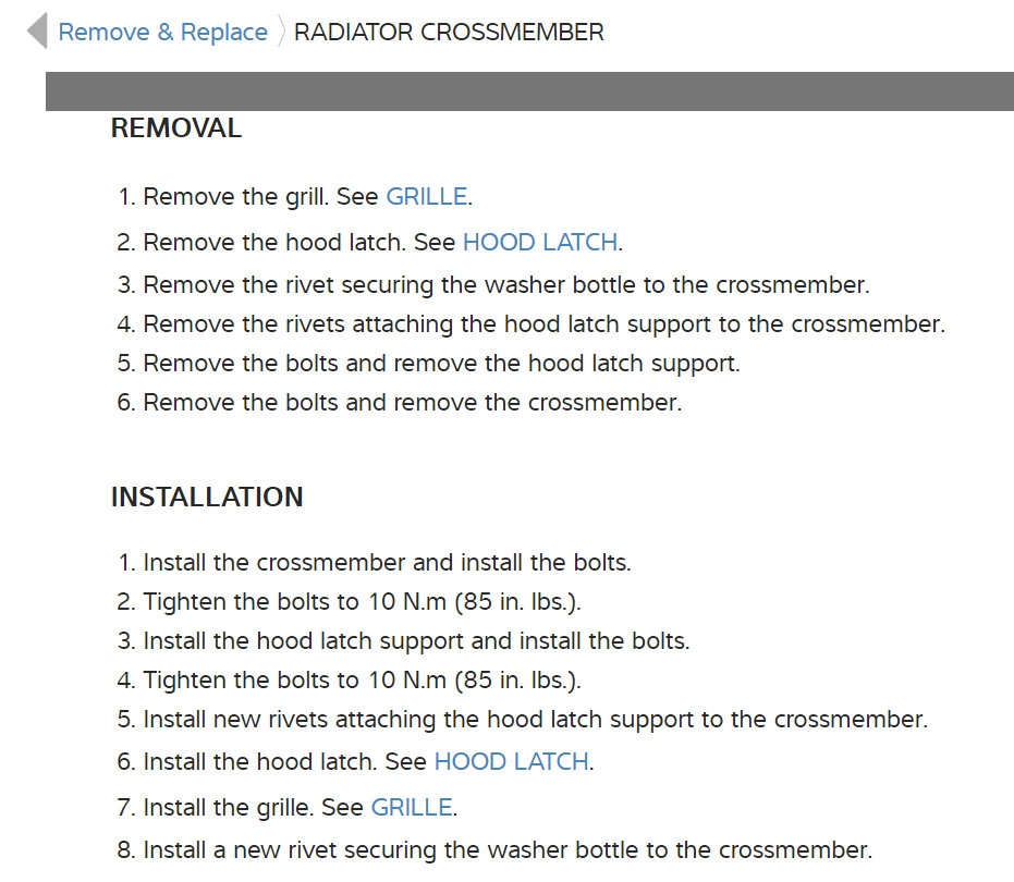

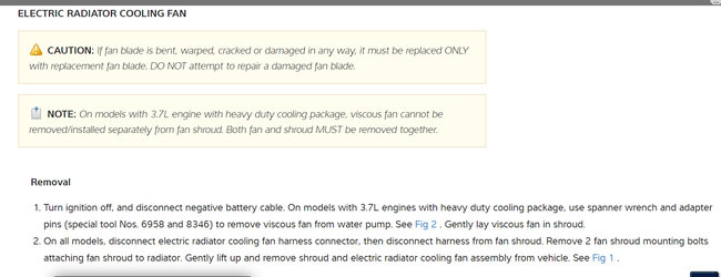

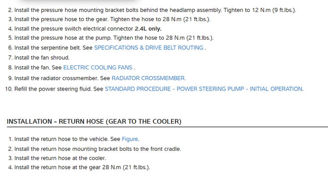

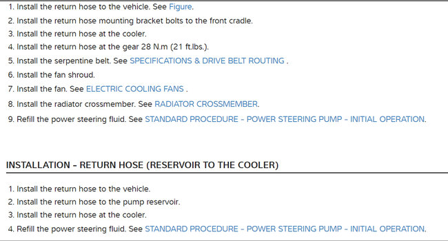

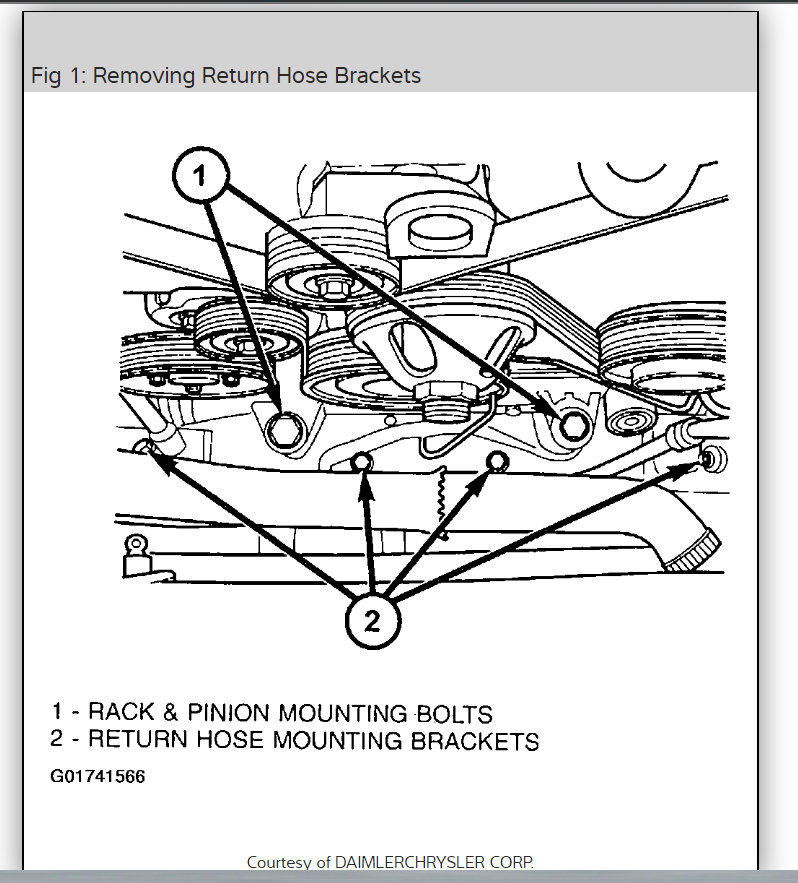

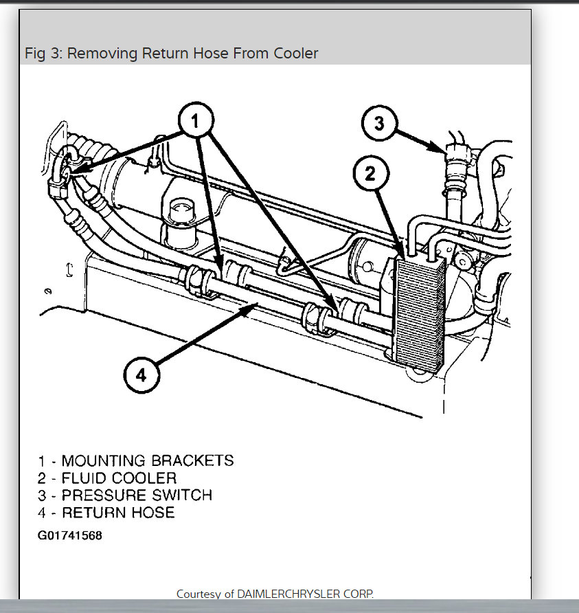

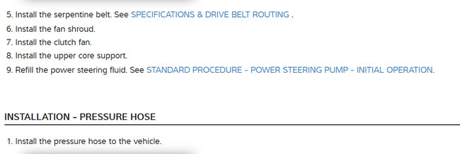

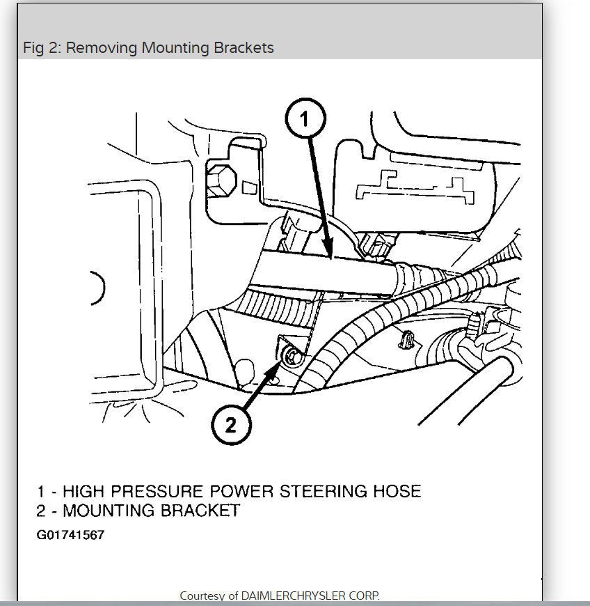

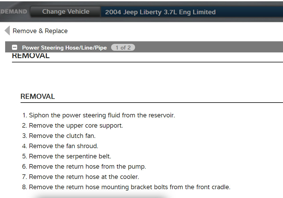

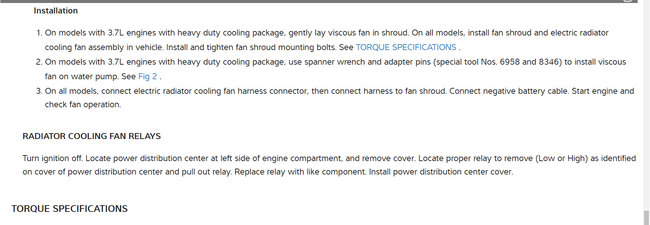

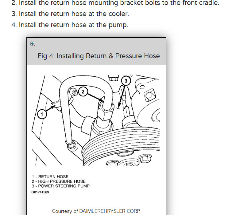

My power steering stopped working and I recently went to a mechanic and he said the power steering hose is leaking and I need to get it replaced. I bought the correct hose to replace it with but just need a little instruction on how to remove and replace it because it doesn't appear to be in a very accessible spot.
Jun 22, 2019 at 1:58 PM
SCGRANTURISMO
  • 4,897 POSTS
In the diagrams down below I have included the step by step instructions for how to replace all of your vehicle's power steering hoses. Please go through the guide and get back to us with how everything turns out, or if you have any additional questions.
