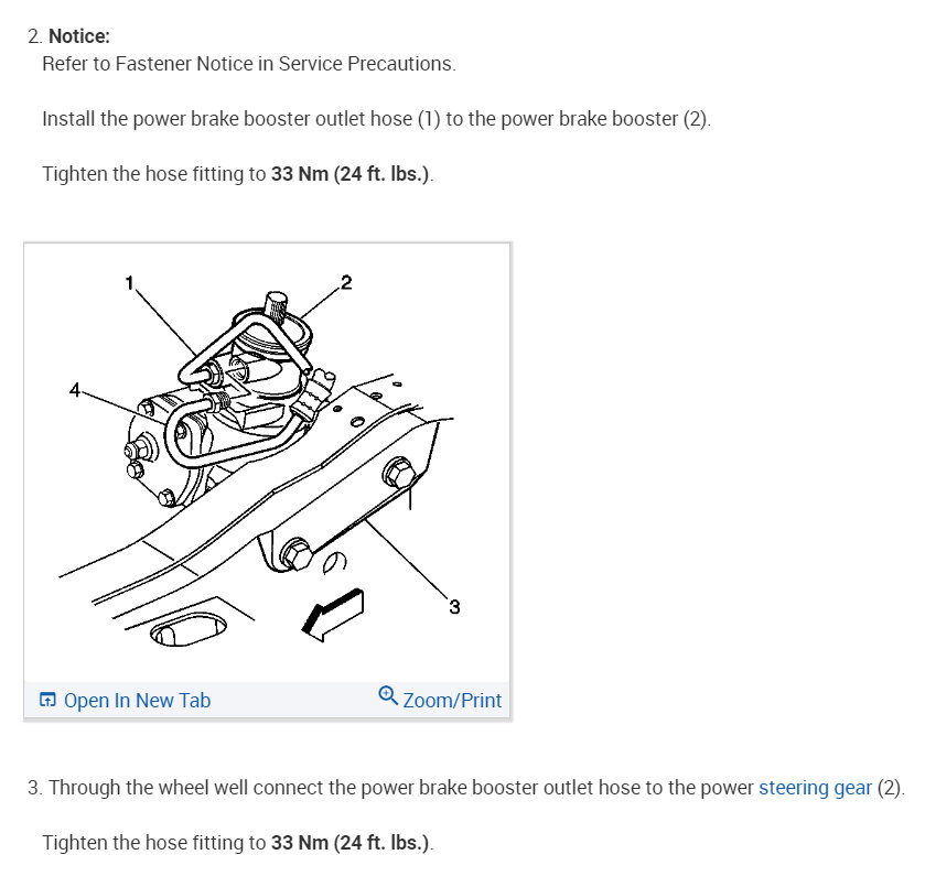

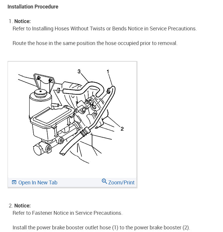

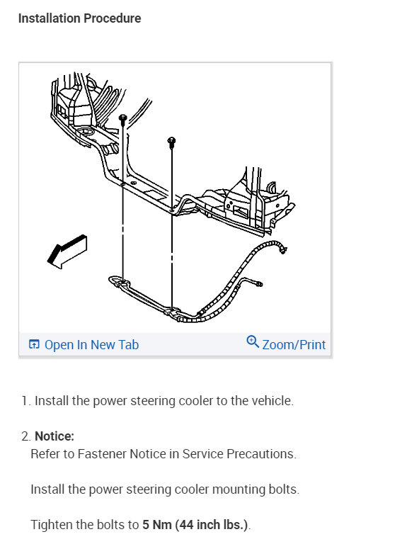

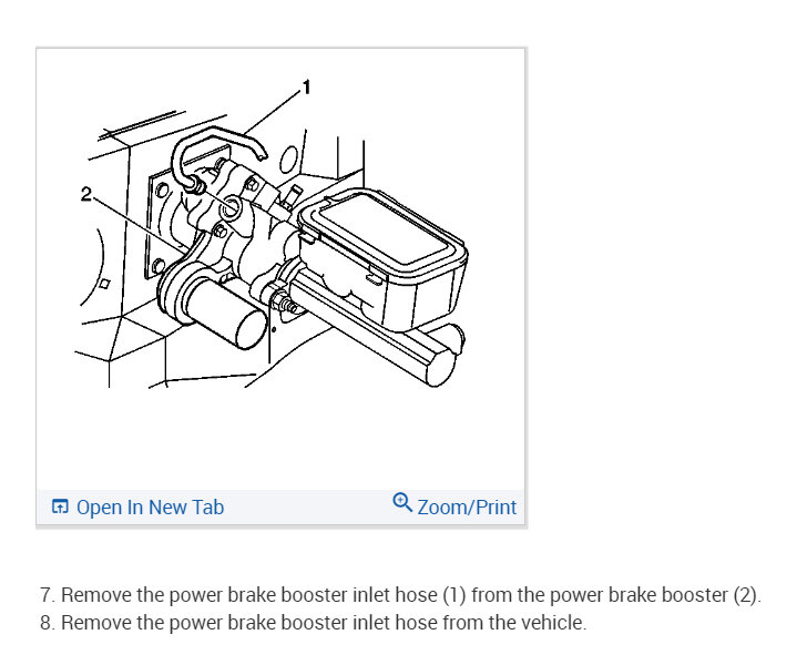

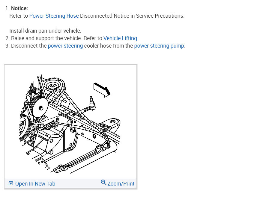

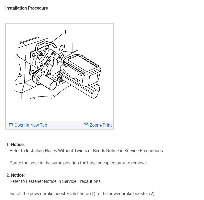

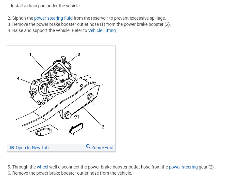

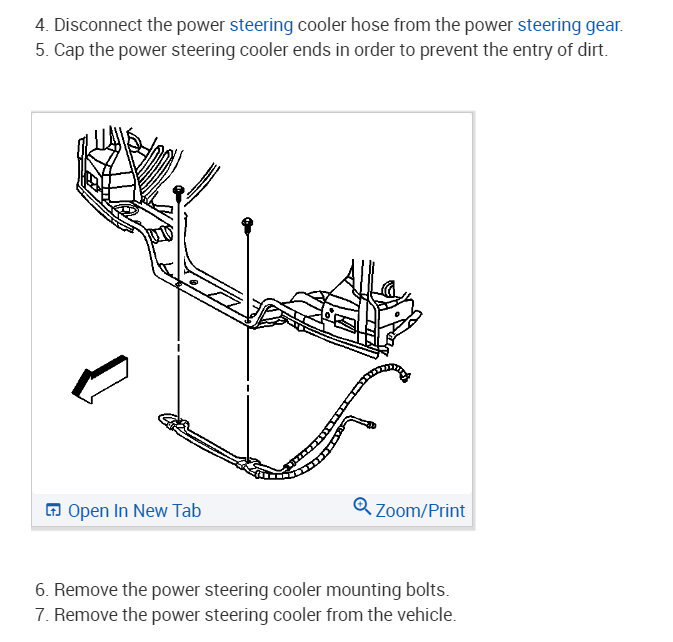

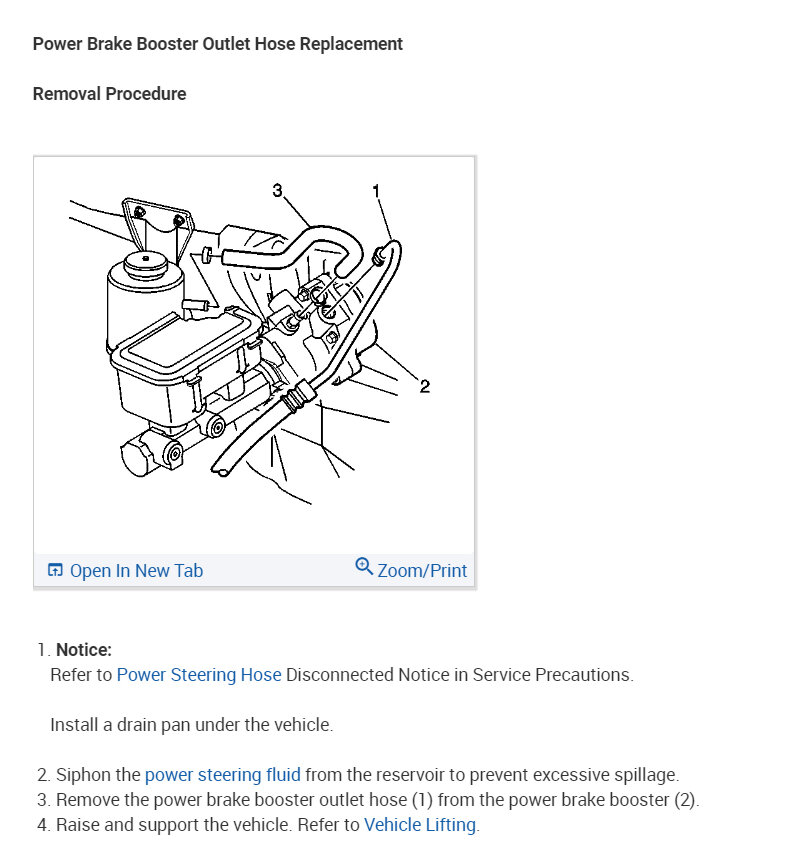

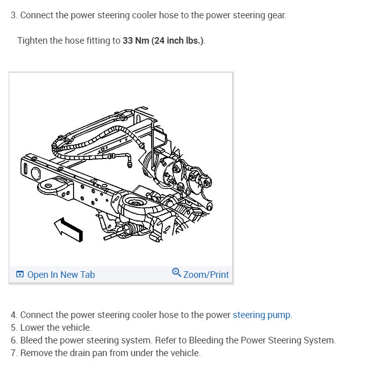

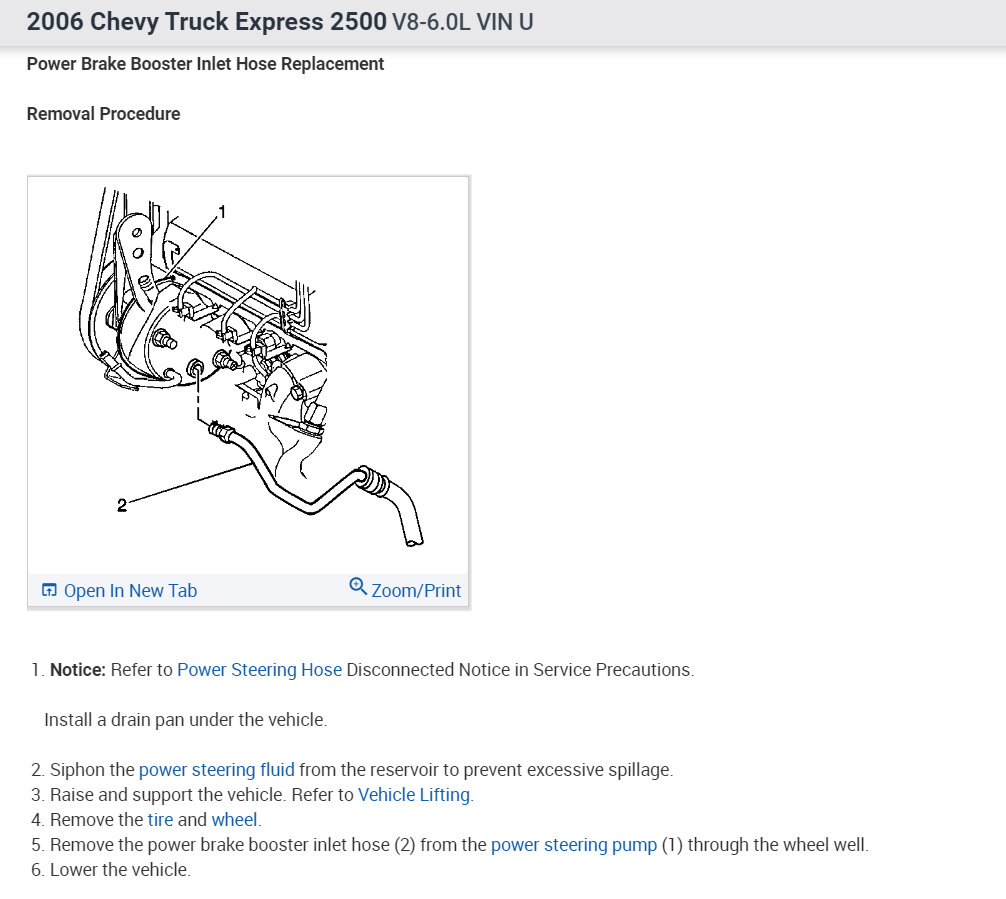

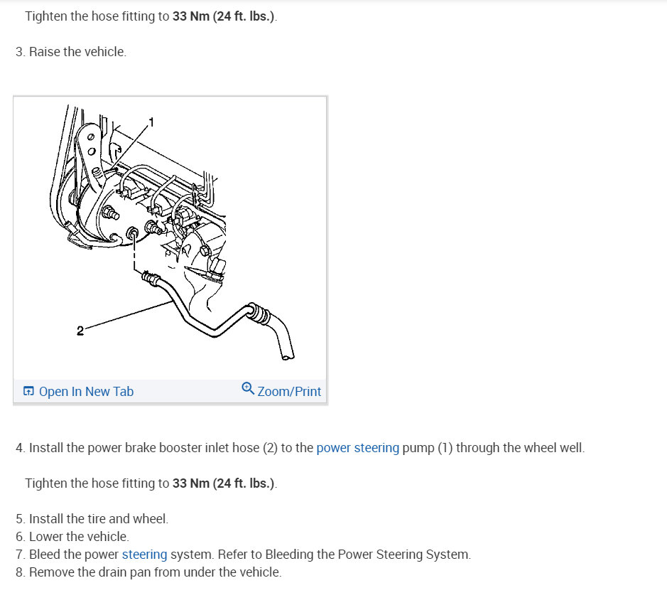

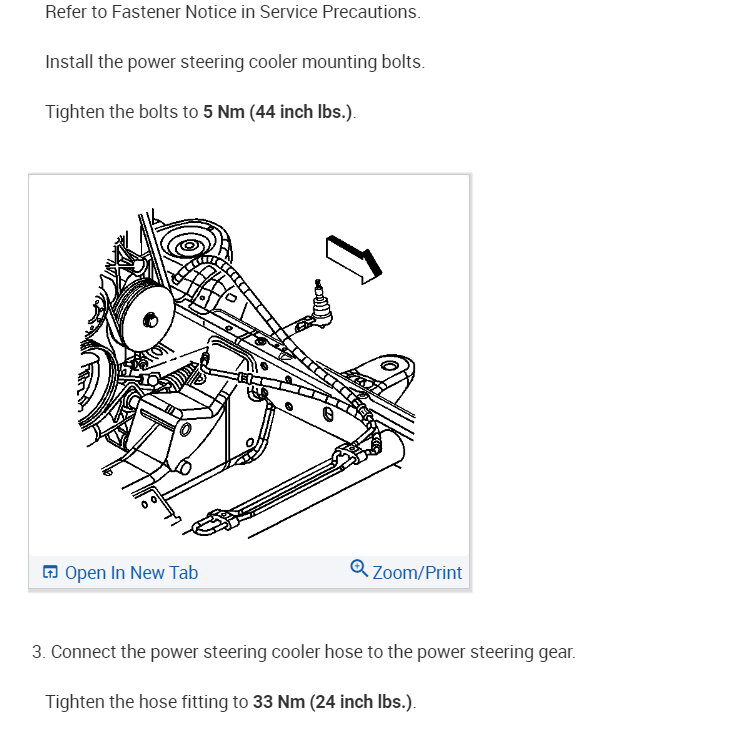

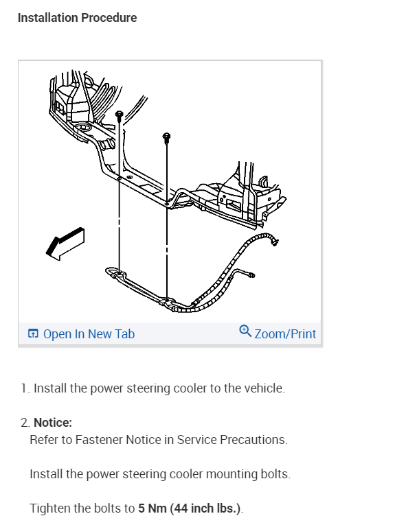

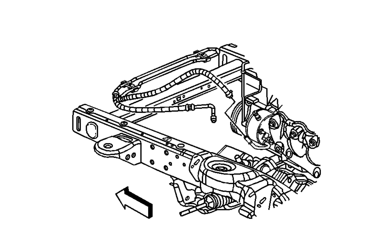

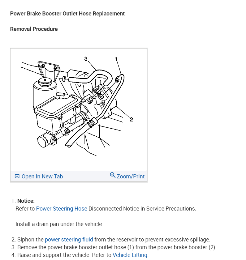

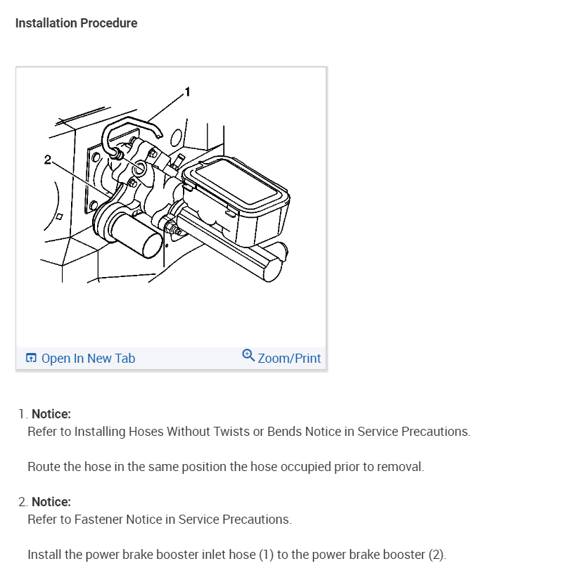

Can I get a power steering hose diagram?
15,000 MILES • 6.0L • V8 • 2WD • AUTOMATIC
DIGIOVANNI
Don’t know where hoses go? Power steering hose diagram?
Nov 17, 2022 at 1:33 PM
  • 55,627 POSTS
I have found the diagrams of how the power steering hoses are replaced which I have included in the images below. Check out the images (below). Please let us know if you need anything else to get the problem fixed.
