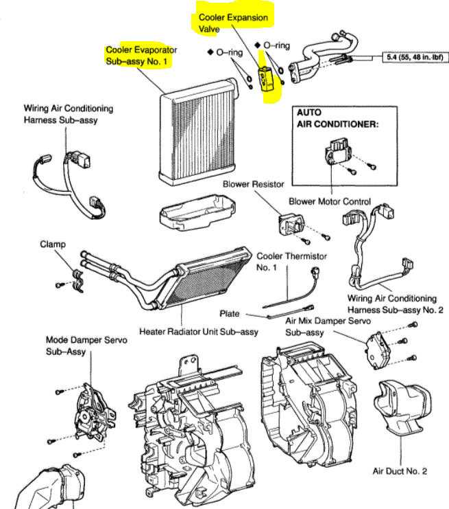

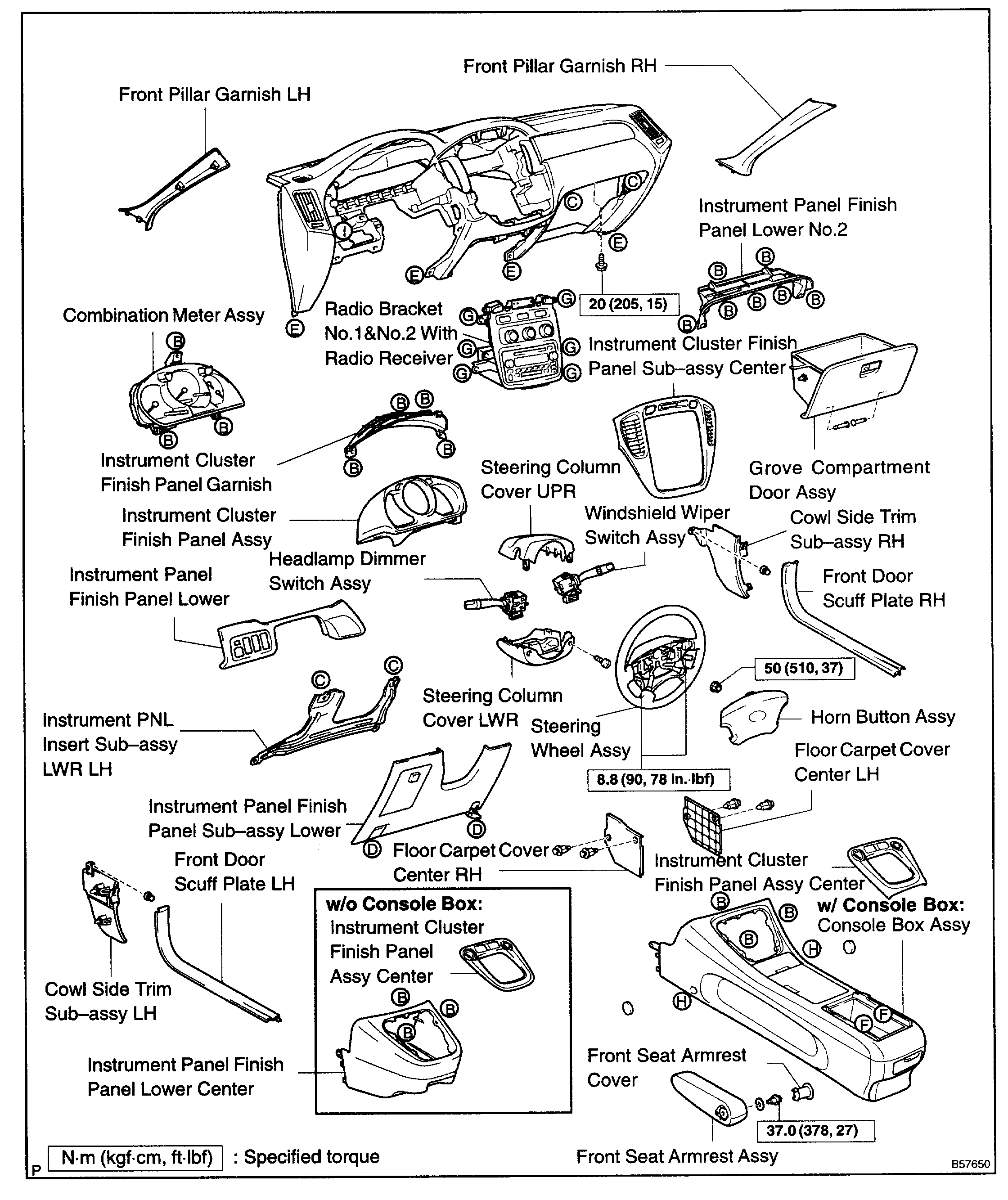

Hi, back again with some questions.
first i would like to know the location of the A/C evaperator and expansion valve, i had changed out condenser compressor , i know its under the dash but can i get a better diagram as to where exactly?? and how to get to it,,
second question.

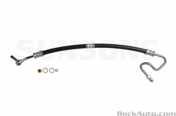

power steering is leaking from the bottom hose, what hose would that be, a pressure hose or returning? i ordered a pressure hose ill add to the picture but i need one for the bottom behind right below the rear of the engine.
by the way is there a way website that i can search up parts location in my vehicles, i had gone through the owners manual no where did it show the location of A/C evaporator. or maybe i didn't see it or maybe that's not where to look for it, maybe online service information?
greatly appreciate your time.

The line you have above appears to be a high pressure hose. Is that the one that leaks?

The one that is leaking is at the bottom of the engine towards the rear of engine.

Looking at the hose and where you say it goes, it sounds like the pressure hose. Often times, the return line will have a standard type hose that can even be clamped on.

Yes, i might have to get that hose in and match it up, then go from there. i might have purchased the wrong hose due to the problem being in the wrong place, and the hose i purchased didn't come with a return hose so possibly is for the upper part by the reservoir. thank you anyway and i appreciate your time.

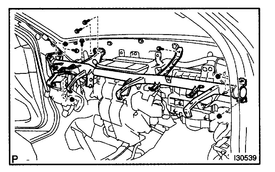

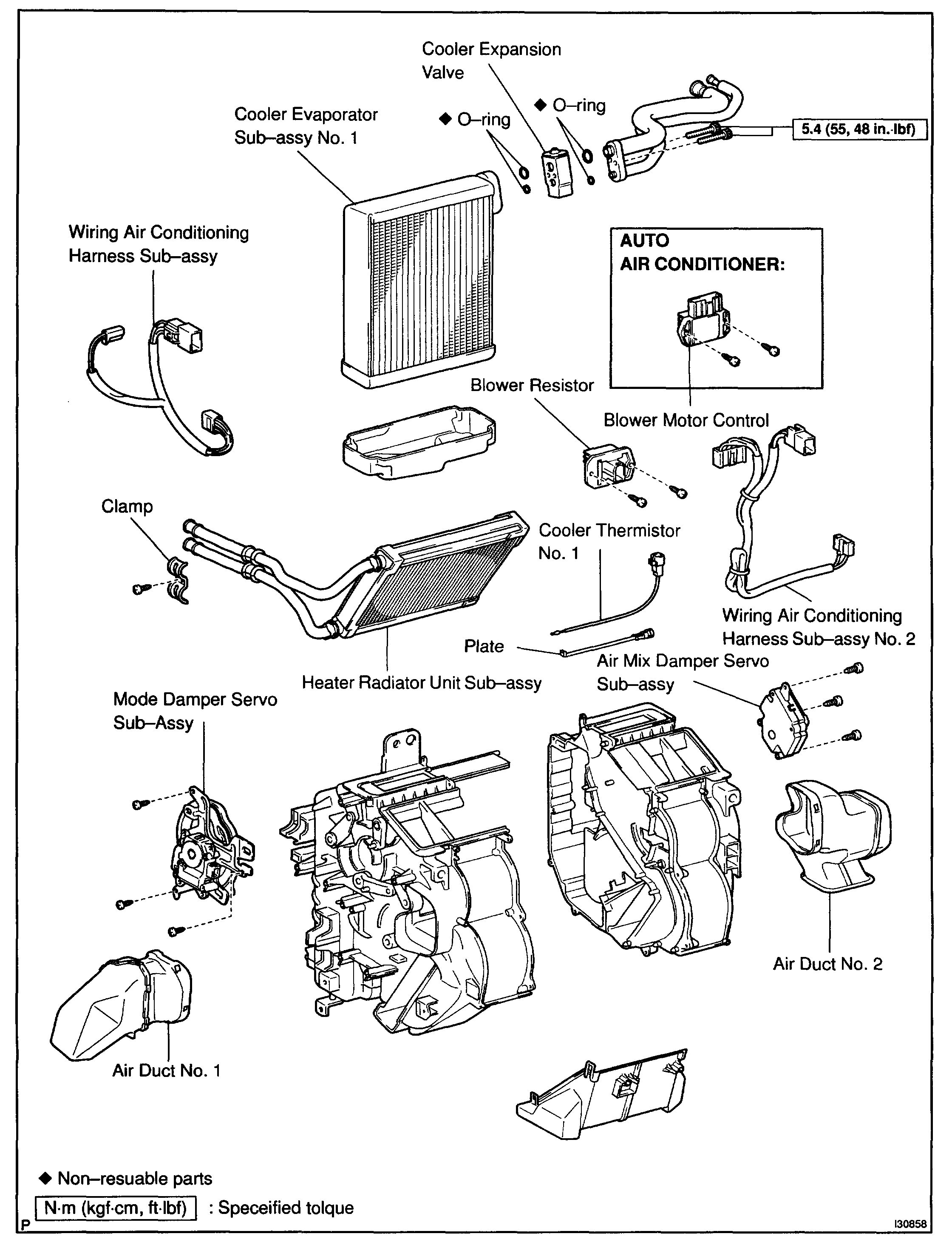

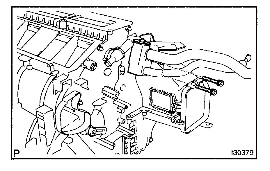

so i have changed out the 1662744 condenser and compressor, but i'm curious as to where exactly the evaporator and expansion valves are located. i believe it is under the dash but i need some help getting to it. is there a diagram of sort i can follow . i tried looking online and owners manual but couldn't seem to find any links to location.
i appreciate your help in advance.
Sep 19, 2020 at 12:21 PM (Merged)
  • 110,194 POSTS

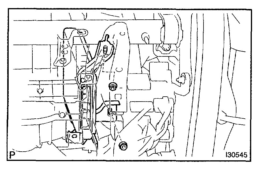

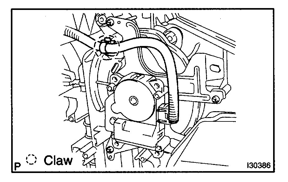

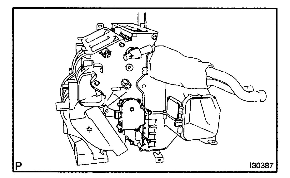

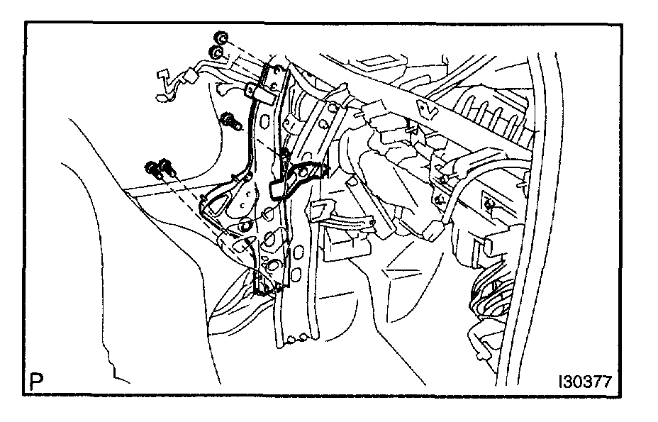

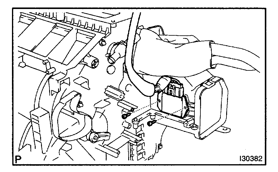

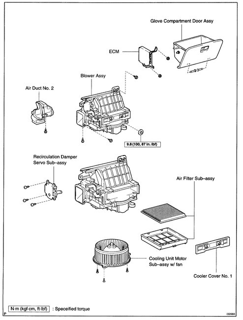

The evaporator and expansion valve are under the dash and take a lot of work to access. If you look at pic 1, it shows the two components.
____________________________
Here are the directions to remove and replace.
2003 Toyota Truck Highlander 2WD L4-2.4L (2AZ-FE)
Air Conditioning Radiator Assy
Vehicle Heating and Air Conditioning Evaporator Case Service and Repair Procedures Air Conditioning Radiator Assy
AIR CONDITIONING RADIATOR ASSY
Heater And Air Conditioner

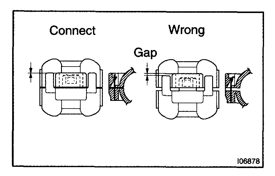

1. DRAIN HFC-134A (R134A)
pic 6

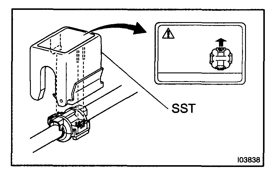

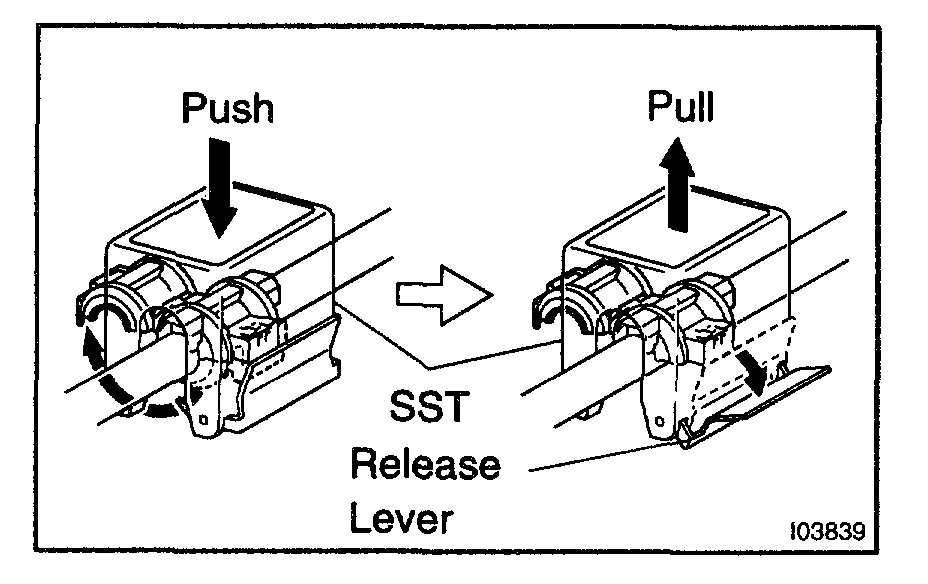

2. SEPARATE COOLER REFRIGERANT SUCTION PIPE NO.1
a. Install SST to piping clamp.
SST 09870-00015
HINT: Confirm the direction of the piping clamp claw and SST using the illustration showing on the caution label.
pic 7
b. Push down the SST and release the clamp lock.
NOTE: Be careful not to deform the tube, when pushing SST.
c. Pull SST slightly and push the release lever, then remove the piping clamp with SST.
pic 8
d. Disconnect the cooler refrigerant suction hose No.1.

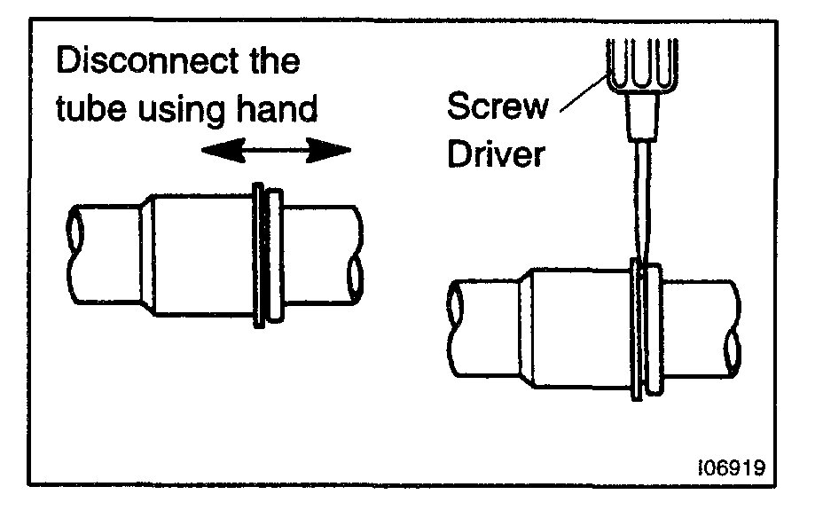

NOTE:
- Do not use tools like screwdriver to remove the tube.
- Cap the open fittings immediately to keep moisture or dirt out of the system.

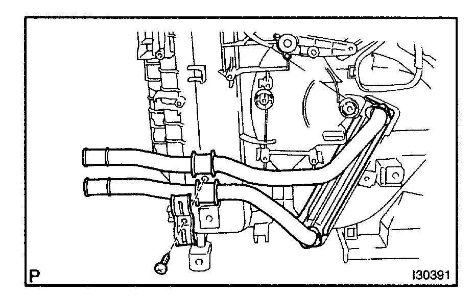

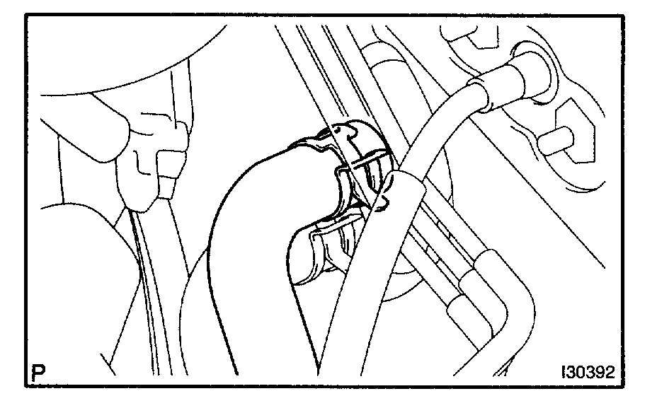

4. SEPARATE HEATER OUTLET WATER HOSE
a. Slide the clip and disconnect the heater outlet water hose.
5. SEPARATE HEATER INLET WATER HOSE
a. Slide the clip and disconnect the heater inlet water hose.

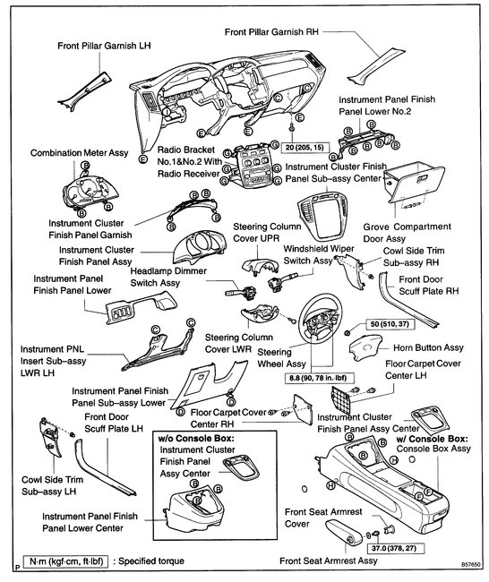

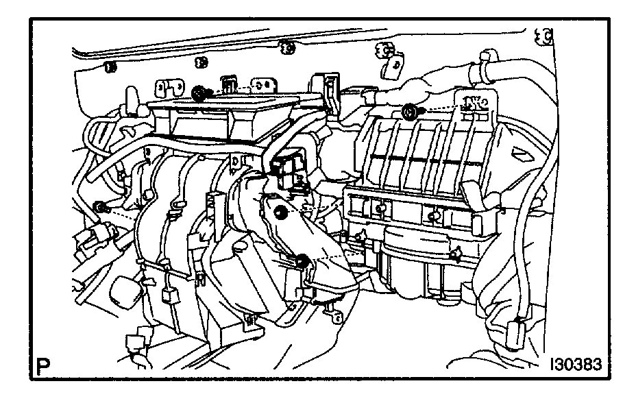

6. REMOVE INSTRUMENT PANEL SAFETY PAD SUB-ASSY
SST 09950-50013 (09951-05010, 09952-05010, 09953-O5020, 09954-05021)
HINT: Refer to the instructions for removal of the instrument panel safety pad sub-assy.
pic 10

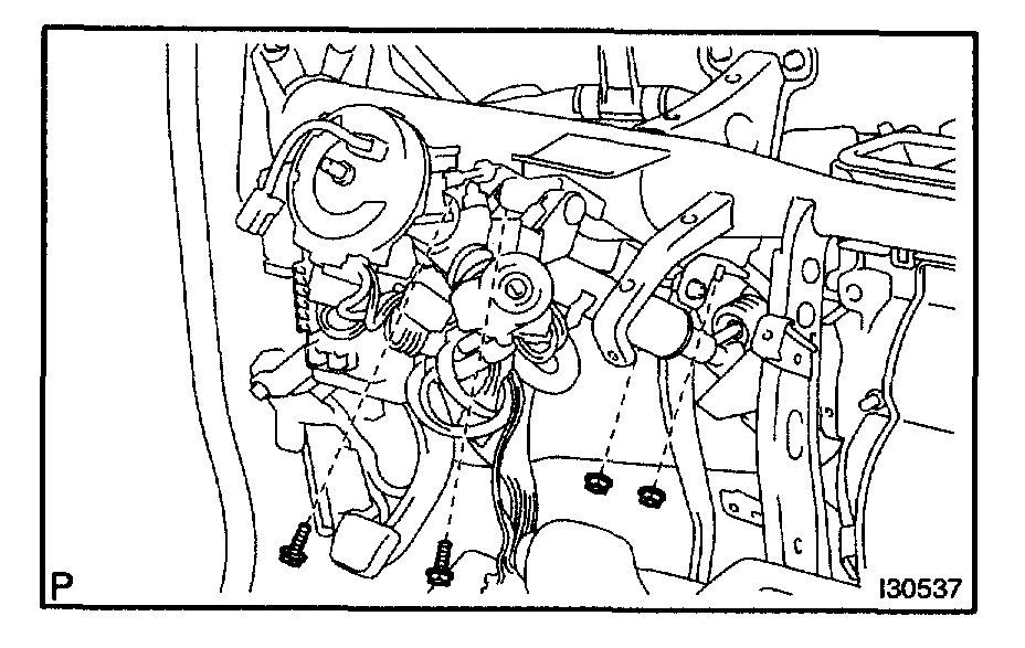

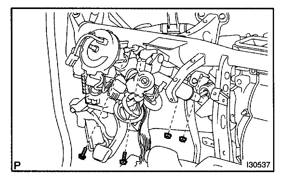

7. SEPARATE STEERING COLUMN ASSY
a. Remove the 2 bolts and 2 nuts, disconnect the steering column assy from the instrument panel reinforcement assy.

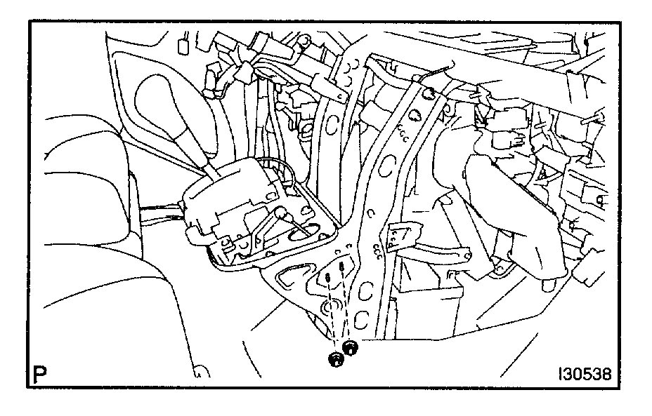

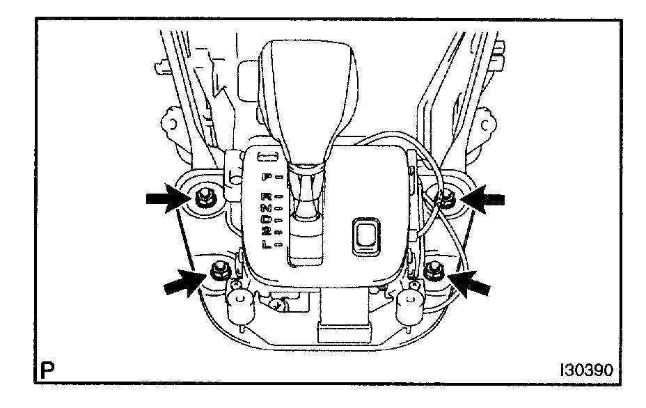

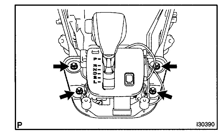

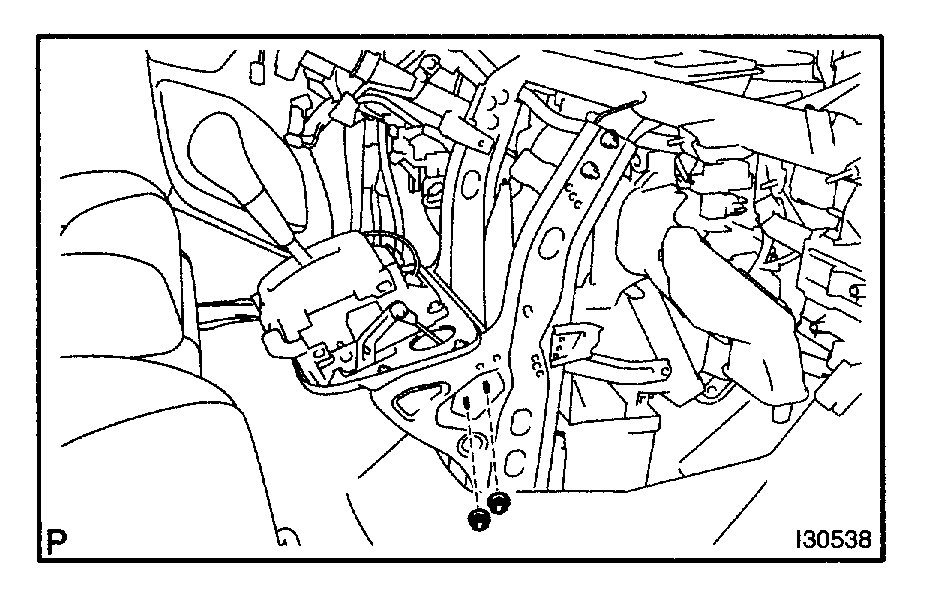

8. SEPARATE FLOOR SHIFT ASSY
pic 11
a. Remove the 2 nuts and disconnect the shift cable.
pic 12
b. Remove the 4 nuts and disconnect transmission floor shift assy.

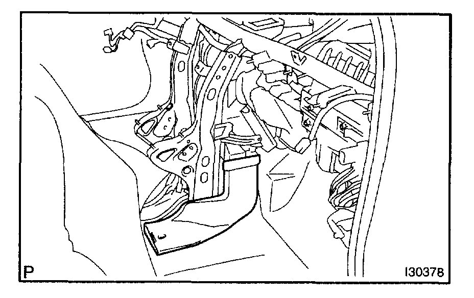

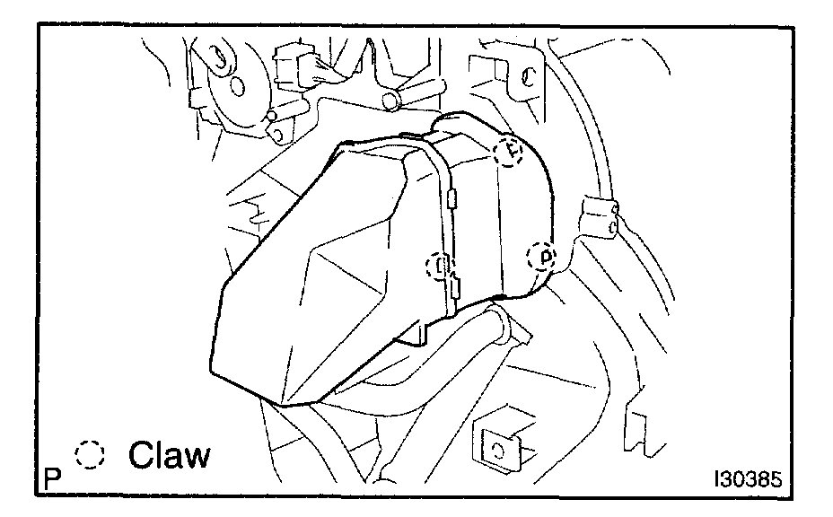

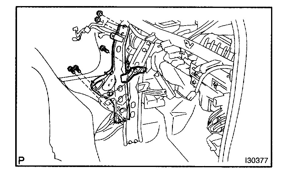

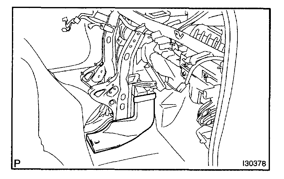

9. REMOVE AIR DUCT REAR NO.2
a. Remove the side scuff plate.
b. Remove the floor carpet.
HINT: Turn up the floor carpet to a certain extent so that the air duct rear No.2 can be remove.
c. Remove the air duct rear No.2.
10. REMOVE AIR DUCT REAR NO.1
HINT: Remove it in the same way with the air duct rear No.2.
pic 14

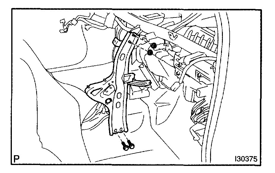

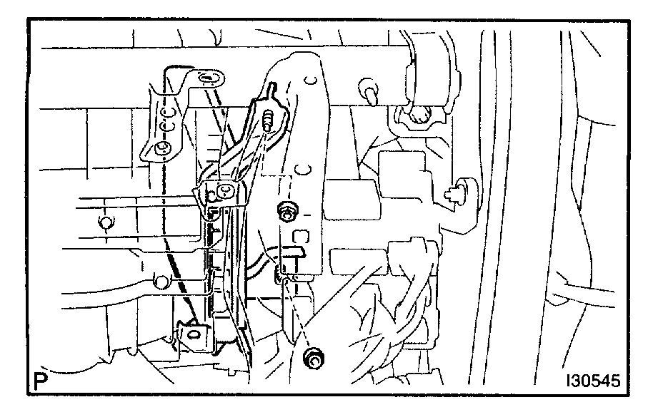

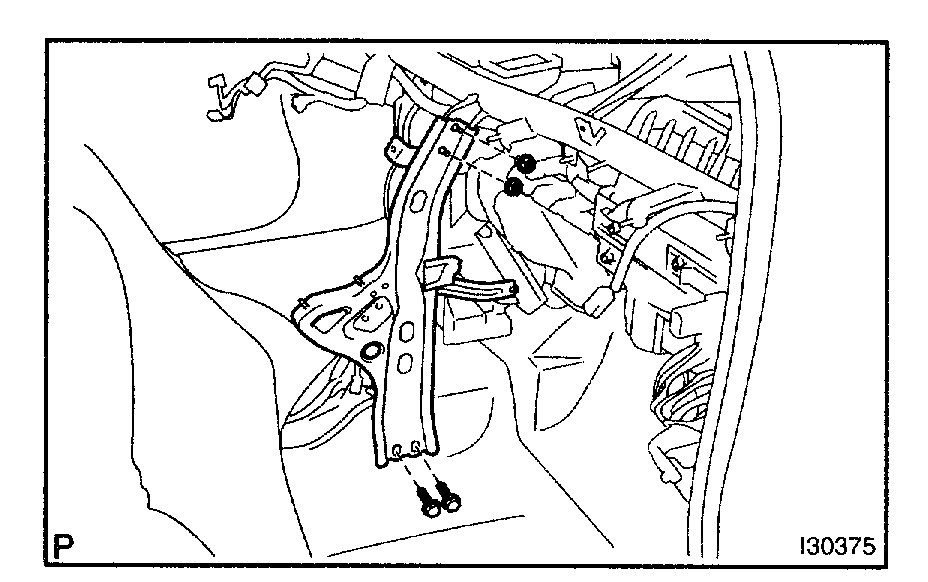

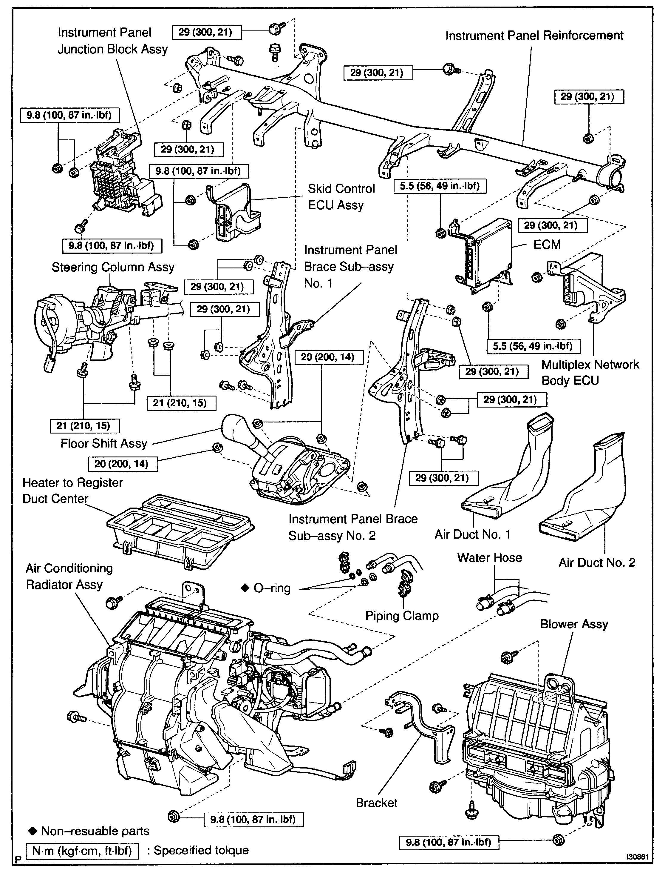

11. REMOVE INSTRUMENT PANEL BRACE SUB-ASSY NO.1
a. Disconnect the connector clamp.
b. Remove the 3 bolts, 2 nuts and instrument panel brace sub-assy No.1.
pic 15
12. REMOVE INSTRUMENT PANEL BRACE SUB-ASSY NO.2
a. Remove the 2 bolts, 2 nuts and instrument panel brace SUB-Assy No.2.
pic 16

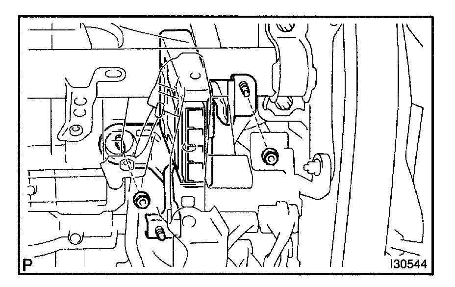

13. SEPARATE ECM
a. Remove the 2 nuts, disconnect the ECM.
pic 17
14. SEPARATE MULTIPLEX NETWORK BODY ECU
a. Remove the 2 nuts and multiplex network body ECU.
pic 18

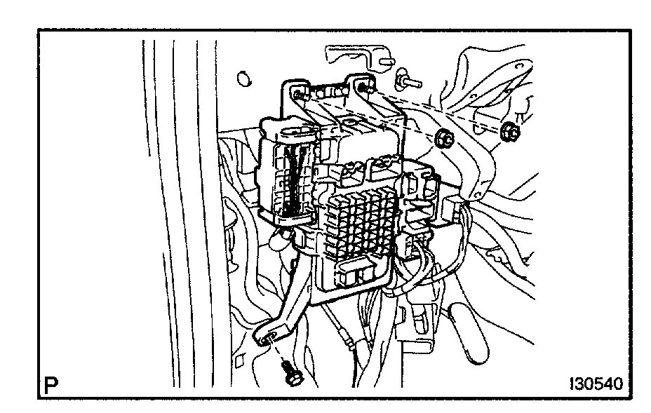

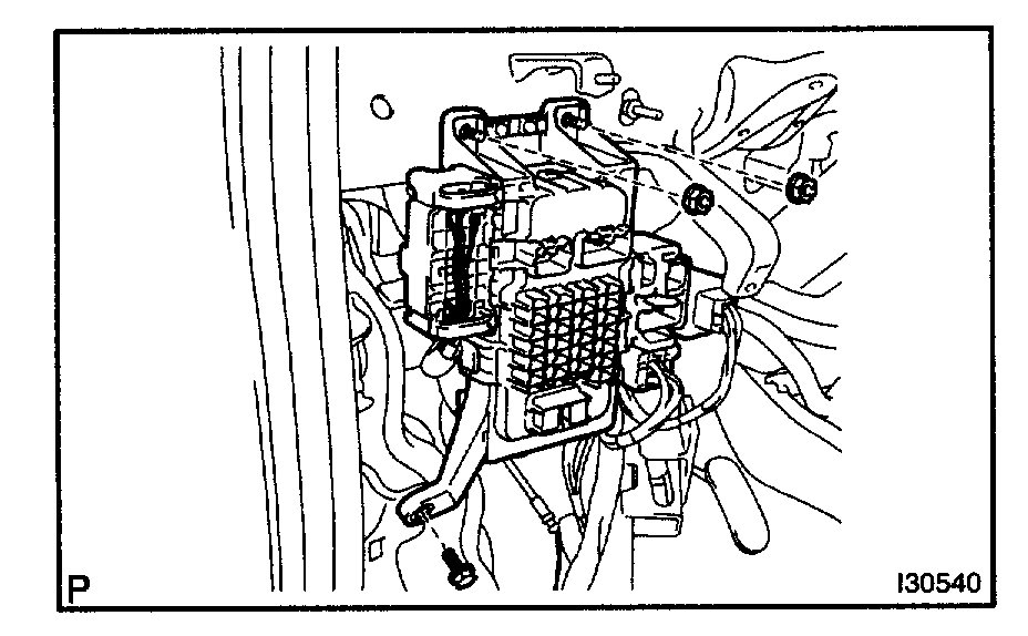

15. SEPARATE INSTRUMENT PANEL JUNCTION BLOCK ASSY
a. Remove the bolt and 2 nuts, disconnect the instrument panel junction block assy.
pic 19
16. SEPARATE SKID CONTROL ECU ASSY
a. Remove the 2 nuts and disconnect the skid control ECU assy.
pic 20

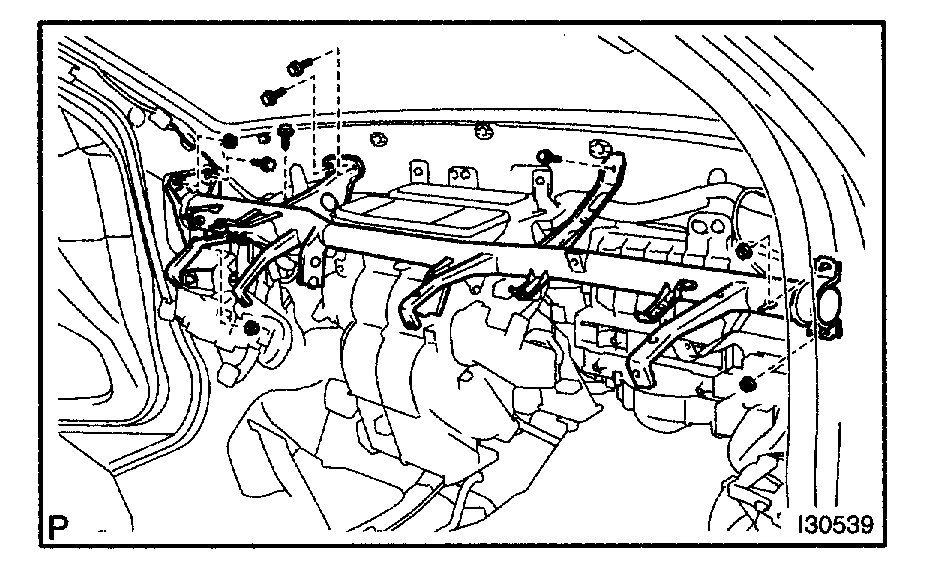

17. REMOVE INSTRUMENT PANEL REINFORCEMENT ASSY
a. Remove the 5 bolts, 4 nuts and instrument reinforcement assy.

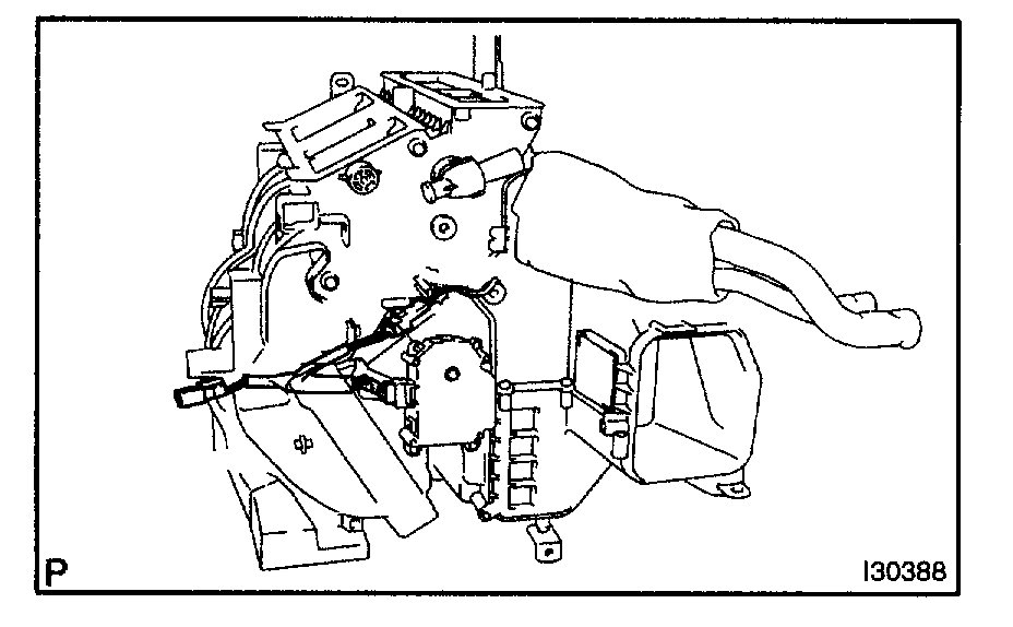

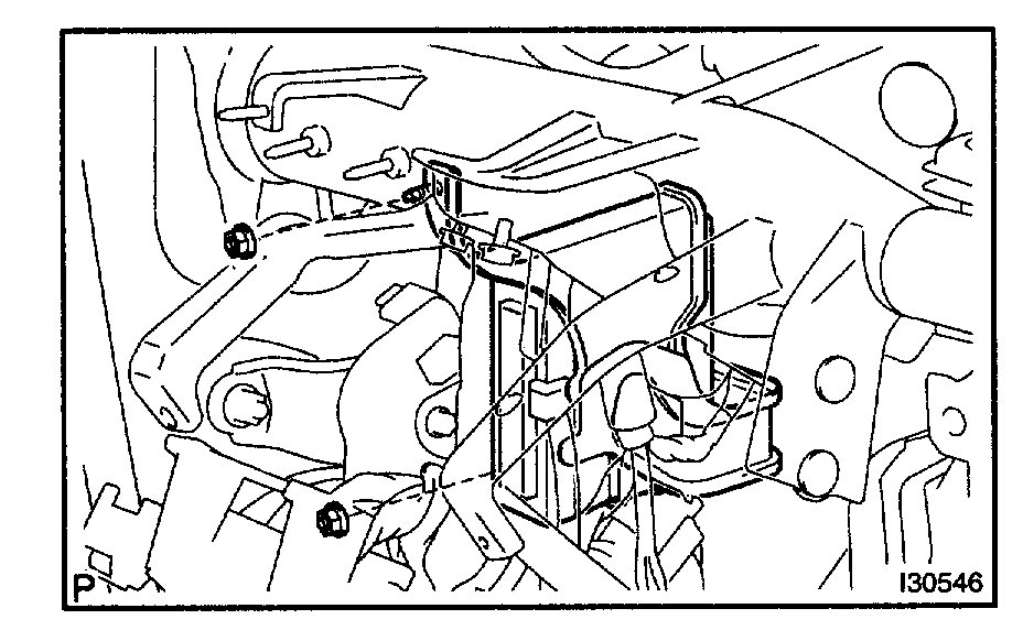

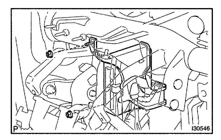

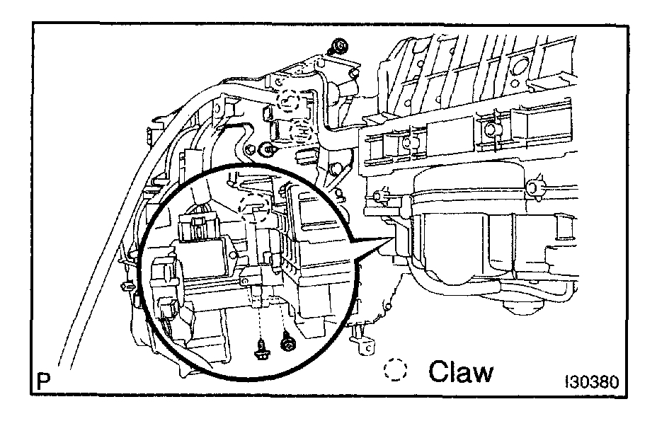

18. REMOVE AIR CONDITIONER UNIT ASSY
pic 21

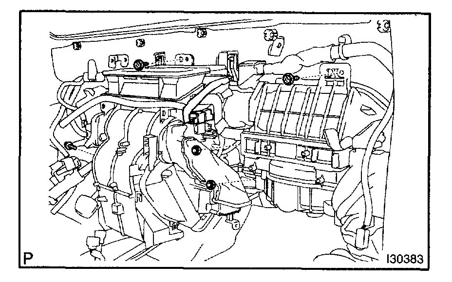

a. Disconnect the connector and clamp.
pic 22
b. Disconnect the connectors connecting the wiring air indicator harness sub-assy and vehicle harness.
c. Remove the 3 bolts, 2 nuts and air conditioner unit assy.

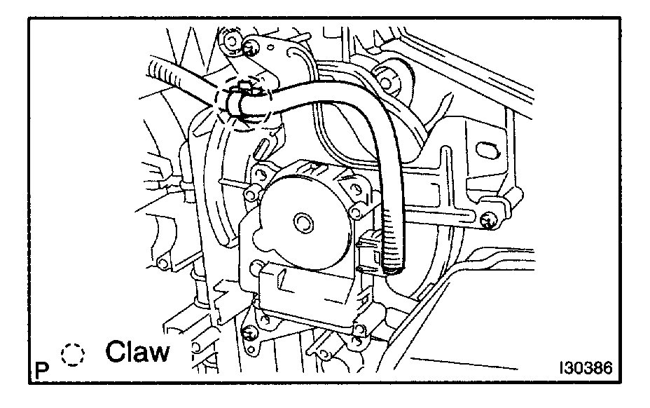

19. REMOVE AIR CONDITIONING RADIATOR ASSY
a. Remove the screw, disconnect the connected part of the duct and take off the air duct No.2.
pic 23
b. Remove the 4 screws and bracket.
c. Disconnect the connection between the blower assy and the air conditioner radiator assy and remove the latter assy.
pic 24

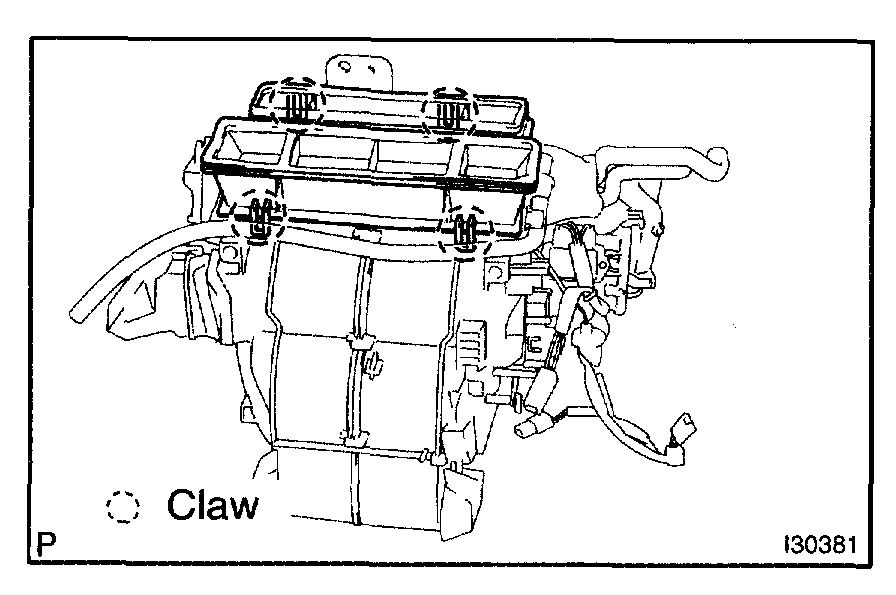

21. REMOVE HEATER TO REGISTER DUCT CENTER
a. Release the 4 claw fittings, remove the heater to register duct center.

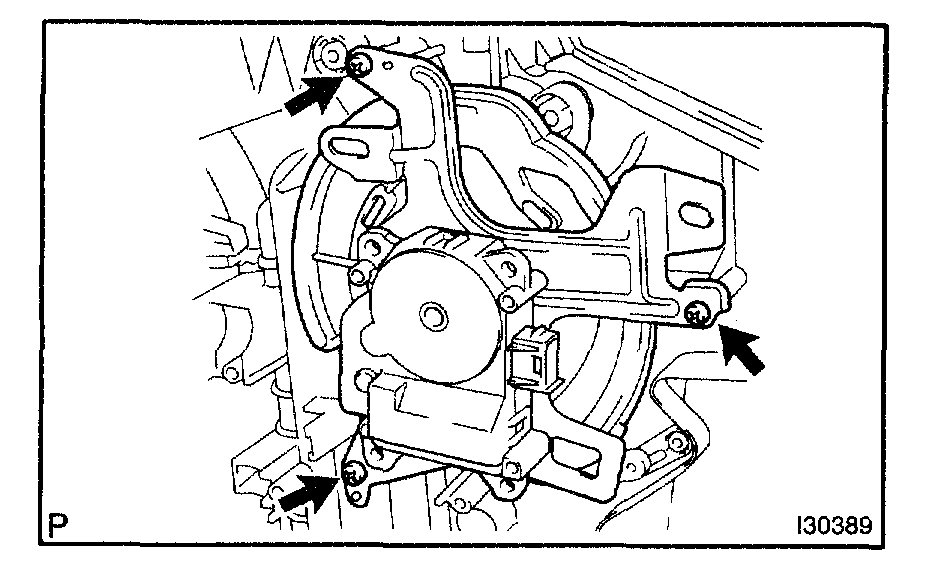

22. REMOVE MODE DAMPER SERVO SUB-ASSY
a. Remove the 3 screws and mode damper servo sub-assy.

24. REMOVE AIR MIX DAMPER SERVO SUB-ASSY
a. Remove the 3 screws and airmix damper servo sub-assy.

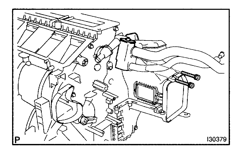

30. REMOVE COOLER EXPANSION VALVE
a. Using a hexagon wrench 4 mm, remove the 2 hexagon bolts and cooler expansion valve.
b. Remove the 2 O-rings from the air conditioner tube assy.
pic 32

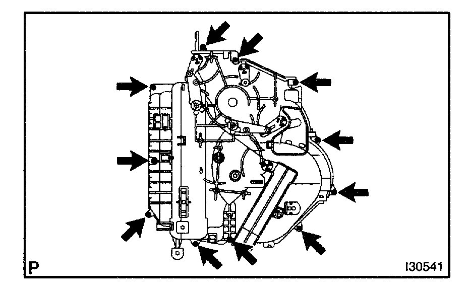

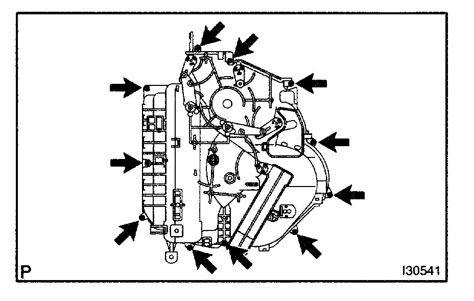

31. REMOVE COOLER EVAPORATOR SUB-ASSY NO.1
a. Remove the 11 screws and disassemble the air conditioner radiator assy.
b. Remove the cooler evaporator sub-assy No.1 from the air conditioner radiator assy.
c. Remove the 2 O-rings from the cooler evaporator sub-assy No.1.
pic 33

35. INSTALL INSTRUMENT PANEL REINFORCEMENT ASSY
a. Install the instrument panel reinforcement assy, 5 bolts and 4 nuts.
Torque: 29 N.m (300 kgf.cm, 21 ft.lbf)
pic 38
36. INSTALL SKID CONTROL ECU ASSY
a. Install the 2 nuts and skid control ECU assy.
Torque: 5.0 N.m (50 kgf.cm, 43 in.lbf)
pic 39
37. INSTALL INSTRUMENT PANEL JUNCTION BLOCK ASSY
a. Install the instrument panel junction block assy, bolt and 2 nuts.
Torque: 8.4 N.m (86 kgf.cm, 74 in.lbf)
pic 40
38. INSTALL ECM
a. Install the ECM and 2 nuts.
Torque: 5.5 N.m (56 kgf.cm, 49 in.lbf)
pic 41
39. INSTALL INSTRUMENT PANEL BRACE SUB-ASSY NO.2
a. Install the instrument panel brace sub-assy No.2, 2 bolts and 2 nuts.
pic 42
40. INSTALL INSTRUMENT PANEL BRACE SUB-ASSY NO.1
a. Install the instrument panel brace sub-assy No.1, 2 bolts and 2 nuts.
pic 43
41. INSTALL FLOOR SHIFT ASSY
a. Install the 4 nuts and floor shift assy.
Torque: 20 N.m (200 kgf.cm, 14 ft.lbf)
pic 44
b. Install the 2 nuts and shift cable.
pic 45
42. INSTALL STEERING COLUMN ASSY
a. Install the steering column assy, 2 bolts and 2 nuts.
Torque: 21 N.m (210 kgf.cm, 15 ft.lbf)
43. INSTALL INSTRUMENT PANEL SAFETY PAD SUB-ASSY
