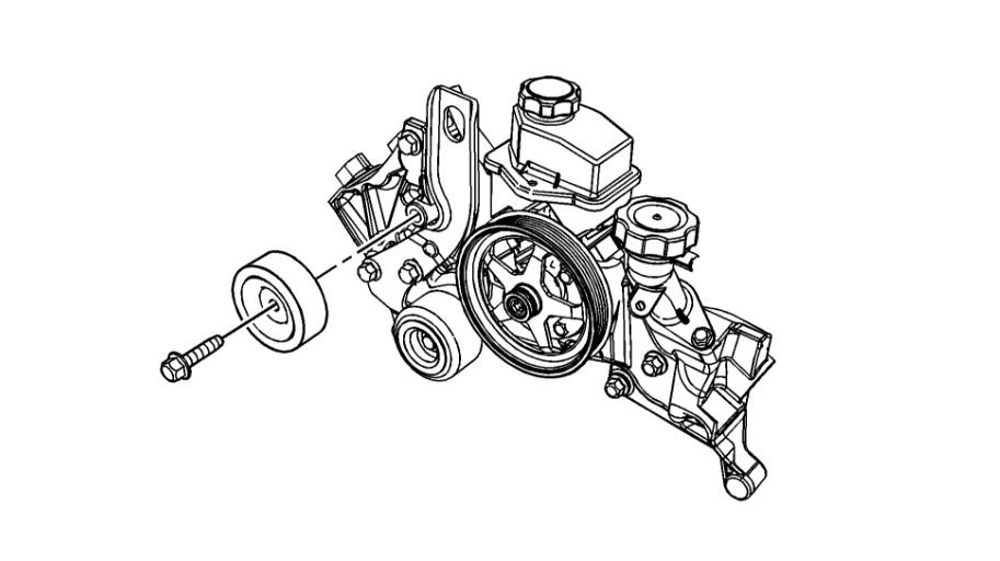

How to take off a power steering hose on the van listed above
(LS model)?
Jun 7, 2018 at 4:58 AM
Good morning.
Not an easy one to do. You need to remove a bit of stuff to access the line and the cradle must be released in the rear to lower the steering rack enough to access the lines for removal.
Removal Procedure
1. Turn the steering wheel to the straight forward position, support it from movement, and remove the key from the ignition.
2. Remove the intake manifold cover.
3. Remove the drive belt.
4. Remove the washer solvent container.
imageZoom/Print
5. Remove the drive belt idler pulley bolt and the pulley.
imageZoom/Print

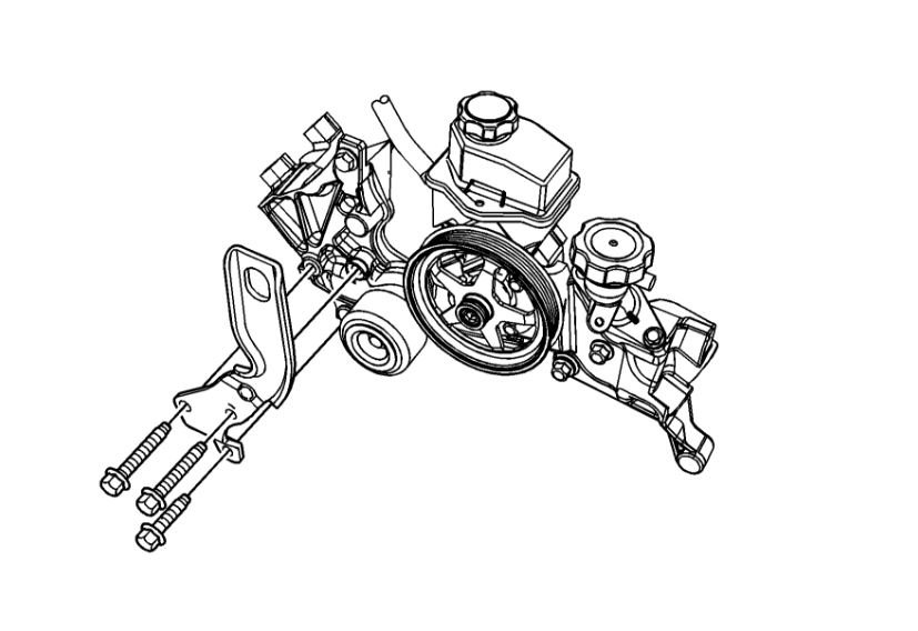

6. Remove the 3 bolts and the engine lift bracket.

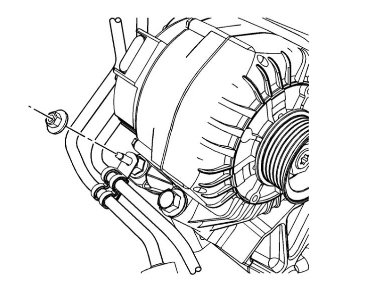

8. Remove the power steering pump and gear inlet pipe/hoses routing clip nut at the generator.
Separate the power steering gear inlet pipe/hose from the routing clip.

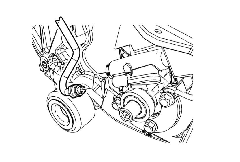

10. Disconnect the power steering gear inlet pipe/hose fitting from the power steering pump. Discard the O-ring seal

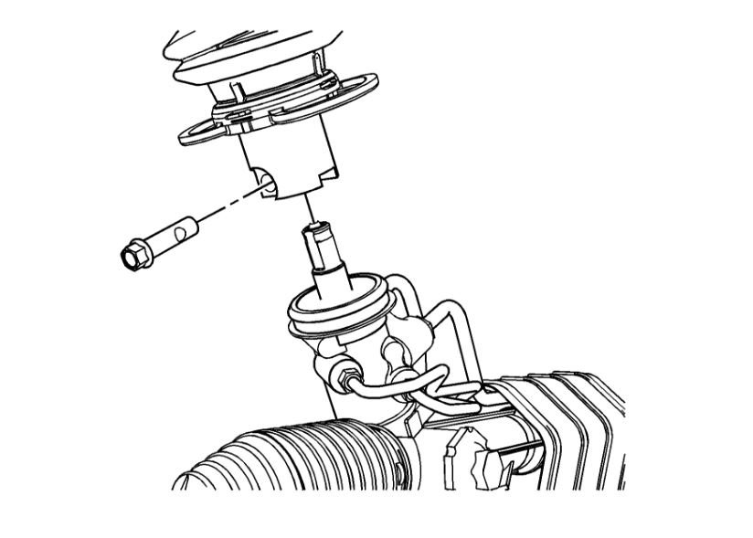

Caution: Failure to disconnect the intermediate shaft from the rack and pinion stub shaft can result in damage to the steering gear and/or intermediate shaft. This damage can cause loss of steering control which could result in personal injury.
12. Remove the intermediate shaft pinch bolt and separate the intermediate shaft from the steering gear.

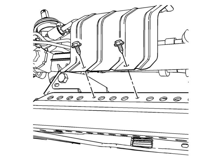

16. Remove the 2 power steering gear heat shield bolts and the shield.
imageZoom/Print

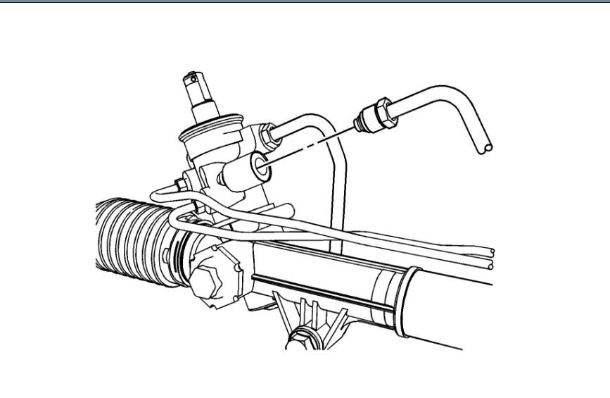

17. Disconnect the power steering gear inlet pipe/hose fitting from the steering gear. Discard the O-ring seal.
18. Remove the power steering gear inlet pipe/hose from the vehicle.
