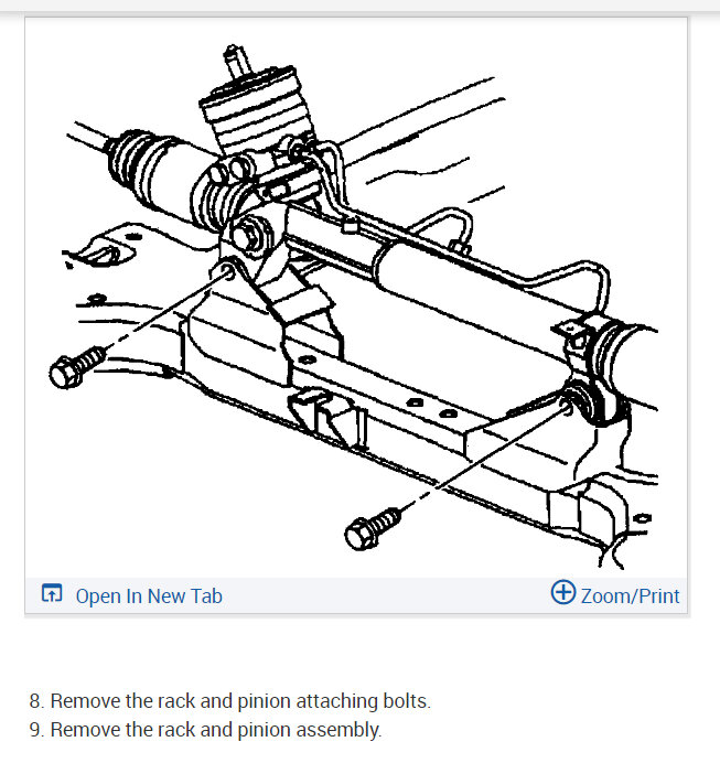

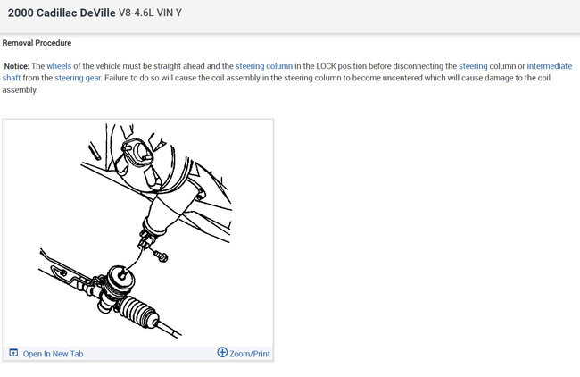

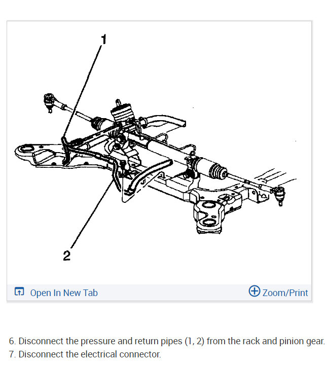

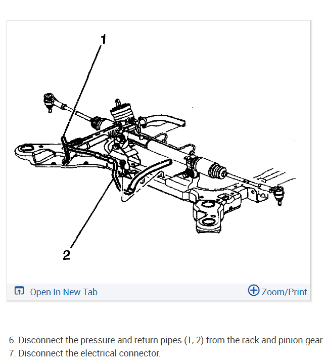

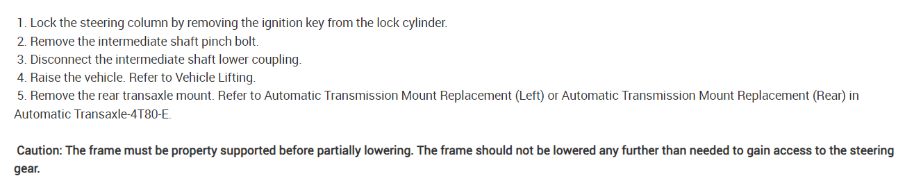

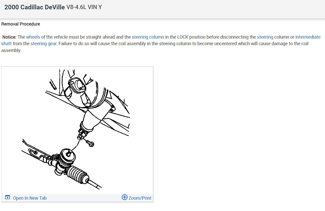

Put 3 pumps on in 2 weeks. Vacuum bled 8 to 10 times each time. Jack car up, still hard. Give it gas and it frees up, easy to steer, at idle hard. No leaks I can fine. Pumps are different brands.
Sep 17, 2024 at 1:50 PM
  • 54,832 POSTS
Yep, this is because the steering rack is bad and needs replacement. here is how. Check out the images (below). Let us know if you need anything else.
