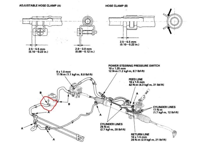

What size hose did you use on the MDX to run to the drain pan? The hose that fit over the return hose. Thanks!
Aug 23, 2020 at 6:04 AM
Experienced Mechanic
52,796 POSTS
I attached a YouTube video for you of the flush process.
I also attached a diagram of the lines and the joint you need to run to the pan.
