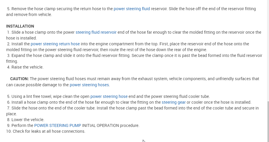

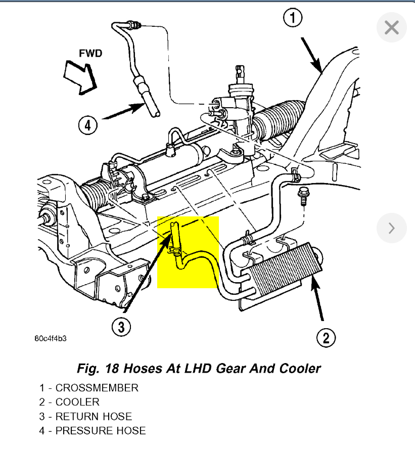

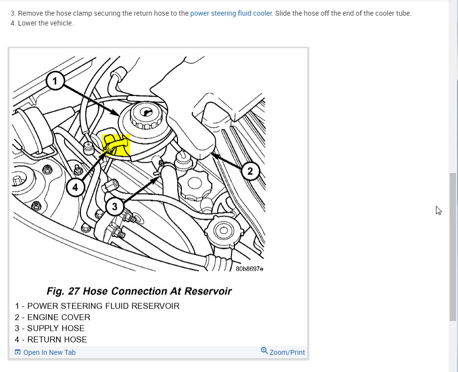

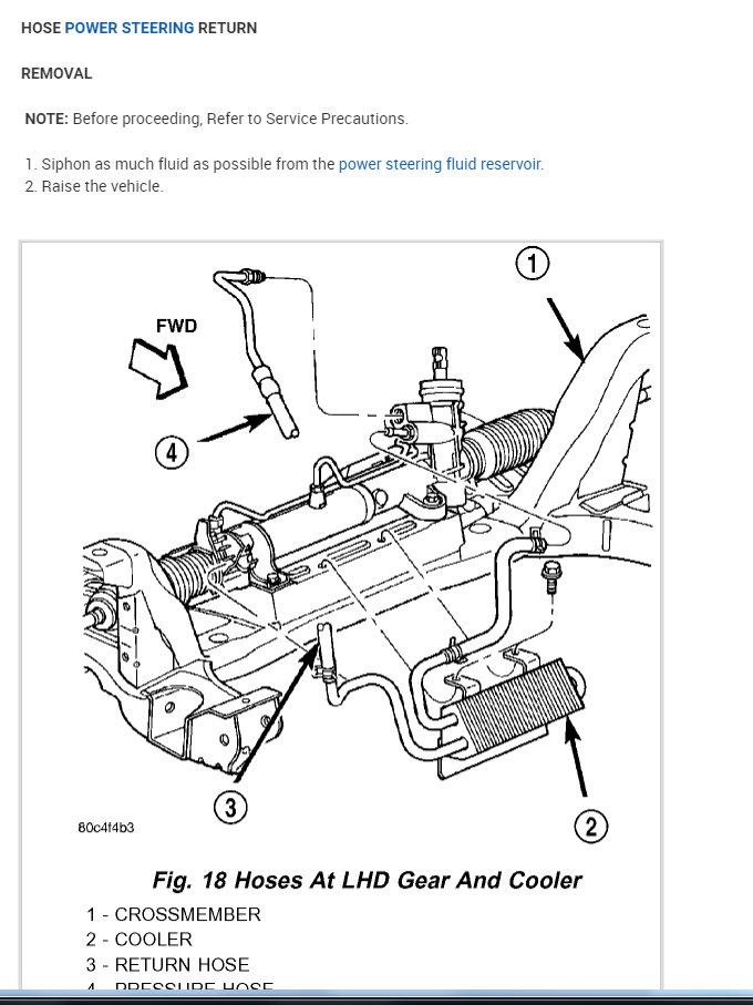

Where is the power steering fluid return line located?
Nov 3, 2019 at 2:53 AM
I attached the documents that you should need. Let me know if you need more information. Check out the diagrams (Below). Please let us know if you need anything else to get the problem fixed. Thanks
