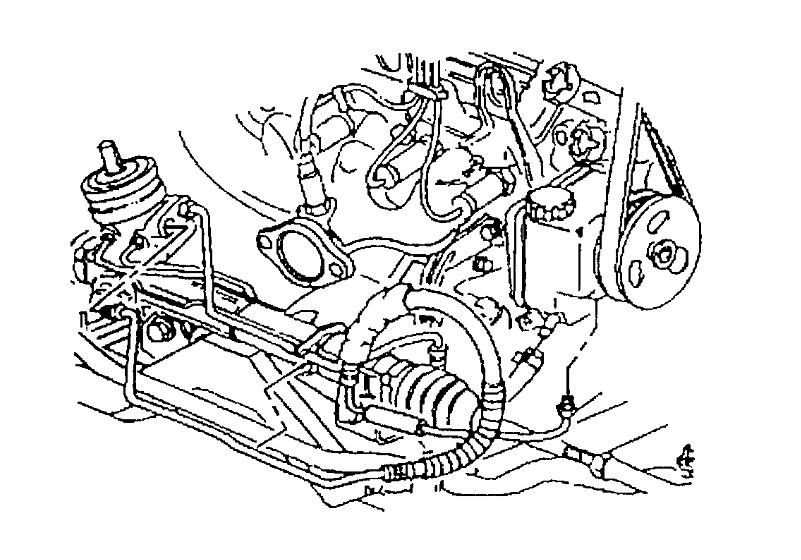

Where is the power steering fluid reservoir and do I need to flush it out before filling it with new fluid? The car is making "the noise" and that's why I think it needs to be flushed out?

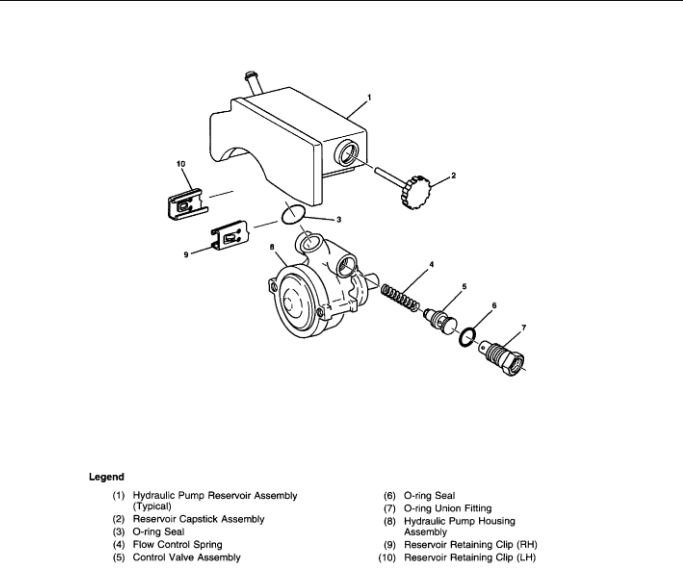

Now where is the power steering fluid reservoir? I can't seem to spot it.
Apr 25, 2020 at 5:18 AM
Good afternoon,
The tank is part of the pump itself. the pump is located at the back bottom of the motor. You will need small hands to get down there.
You need to flush the entire system of all fluid to get the dirt and debris out of the system.
https://www.2carpros.com/articles/power-steering-fluid-flush
Do not be surprised if it does not work. It sounds like the vanes are bad from lack of fluid. The pump may have to be replaced.
