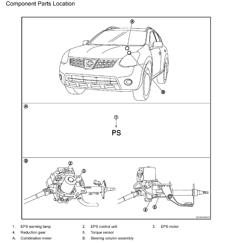

I couldn't find a power steering fluid reservoir in my car (Nissan, Qashqai, 2008) Would it be possible that there is no reservoir?

Yes there is no power steering fluid reservoir because the steering is electric. Check out the diagrams (Below). Please let us know if you need anything else to get the problem fixed.
