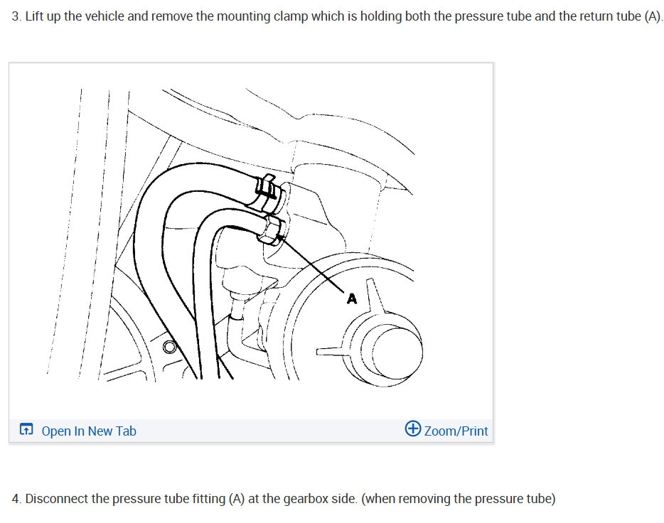

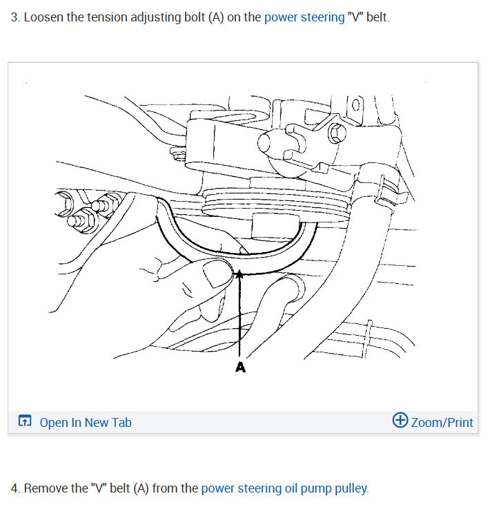

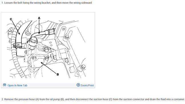

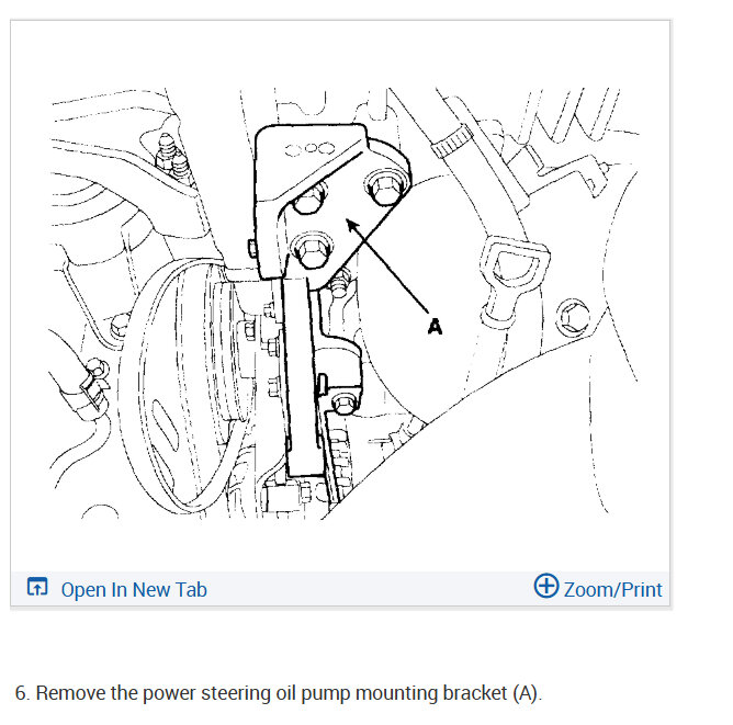

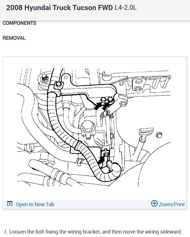

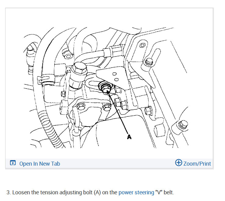

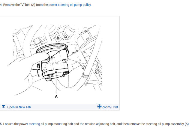

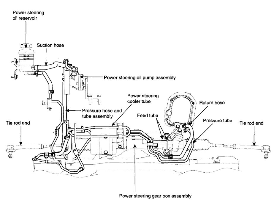

Please watch the video you uploaded; I can see what you are trying to show? Typically leaks like this can be either the front pump seal or the main pressure hose.
Dec 4, 2024 at 3:18 AM
RWARREN35
Is it expensive to change both?
Dec 4, 2024 at 4:15 AM
  • 55,834 POSTS
No it is not too bad, most people replace both anyway, here is how the job is done. Check out the images (below). Let us know how it goes.
