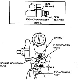

Located on the power steering pump reservoir I have a control valve actuator. The o-ring(s) are leaking. I wish to replace valve (if available), along with the required o-rings. Would like to know how valve is retained (threaded, etc) and best way to remove/replace? There is what appears to be a banjo fitting actuator fits up against (I am assuming with o-ring in-between). Power steering line attaches to this same banjo fitting. Do I need specialty wrench to remove actuator due to space restrictions (thin "nut-type" fastener) on part? Please give wrench type or part number, if possible. This is natural aspirated LX T-Bird, not supercharged version. Thank you, Andrew

The control valve unscrews. You remove the return line, then unscrew the valve. The actual valve and spring may come out so be sure to catch them. Then change the o-rings and reassemble.
