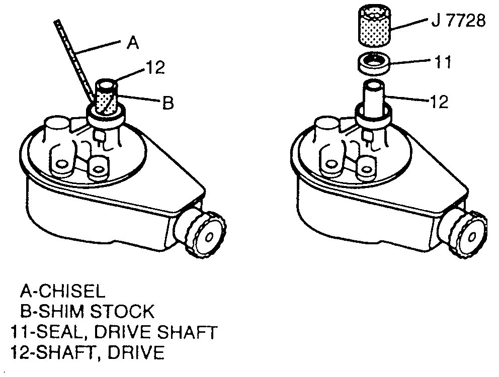

My power steering pump started squealing and had a minor leak. Stop Leak worked for a little while. Now it leaks out completely after fifteen minutes of driving. UV dyed to find the leak ,using gravity to find the leak, i cannot find a exact spot because the dye is on the connections where the hose meets the coupler, and everywhere around it, it pools under the driver side carriage off the transmission off the rods under the fan closer to the radiator.no hose leaks (checked while running). Also the squeal is gone, but impossible to turn unless i fill it. Can someone help me find out? where else i should be looking/testing? be specific i am a novice.

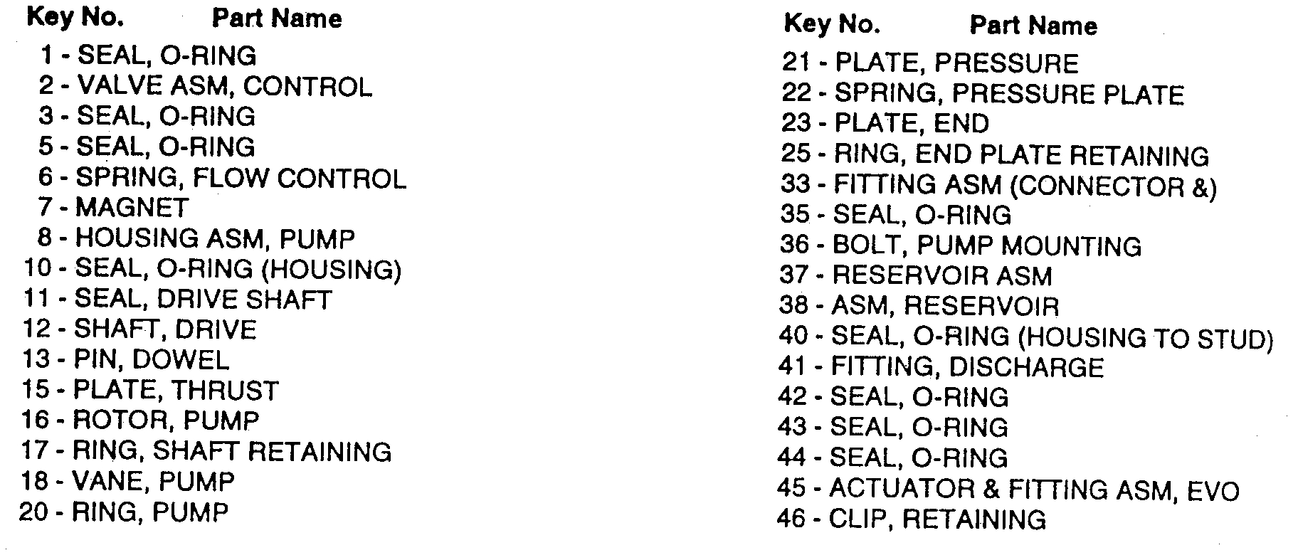

If the connections you are referring to are near the pump, and the pump is wet, I have a feeling either the pump's crank seal is leaking, or one of the other o-rings is bad.
Take a look through this. It shows an exploded view of the pump as well as how to replace the seals.
See Pictures 1 and 2
^ Tool Required:
- J 7728 Shaft Oil Seal Installer
- Or Equivalent
NOTE: Remove or disconnect the power steering pump from vehicle.
See Picture 3
DISASSEMBLE
- Protect drive shaft (12) with shim stock.
- Seal (11) by cutting with a chisel.
ASSEMBLE
- Lubricate seal (11) with power steering fluid.
- Seal (11) using J 7728.
- Install or connect the power steering pump.
______________________________________
Now, to determine if this is the problem, clean the entire area including the pump and pulley. Next, have a helper start the vehicle and pay attention to where the fluid starts to leaf from.

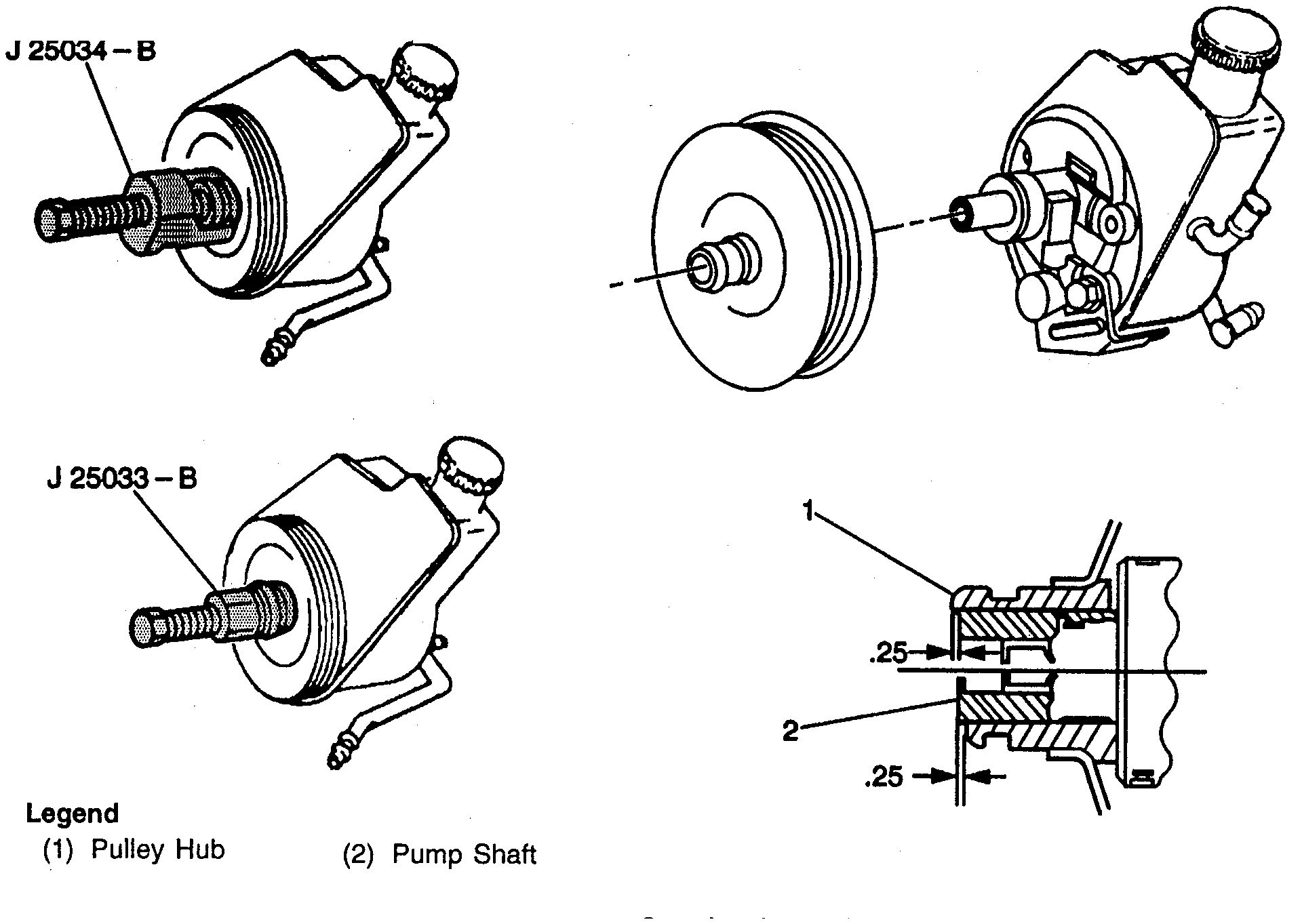

If you have to remove the pump, here are the directions in general for removal:
https://www.2carpros.com/articles/power-steering-problemshttps://www.2carpros.com/articles/how-to-replace-a-power-steering-pump

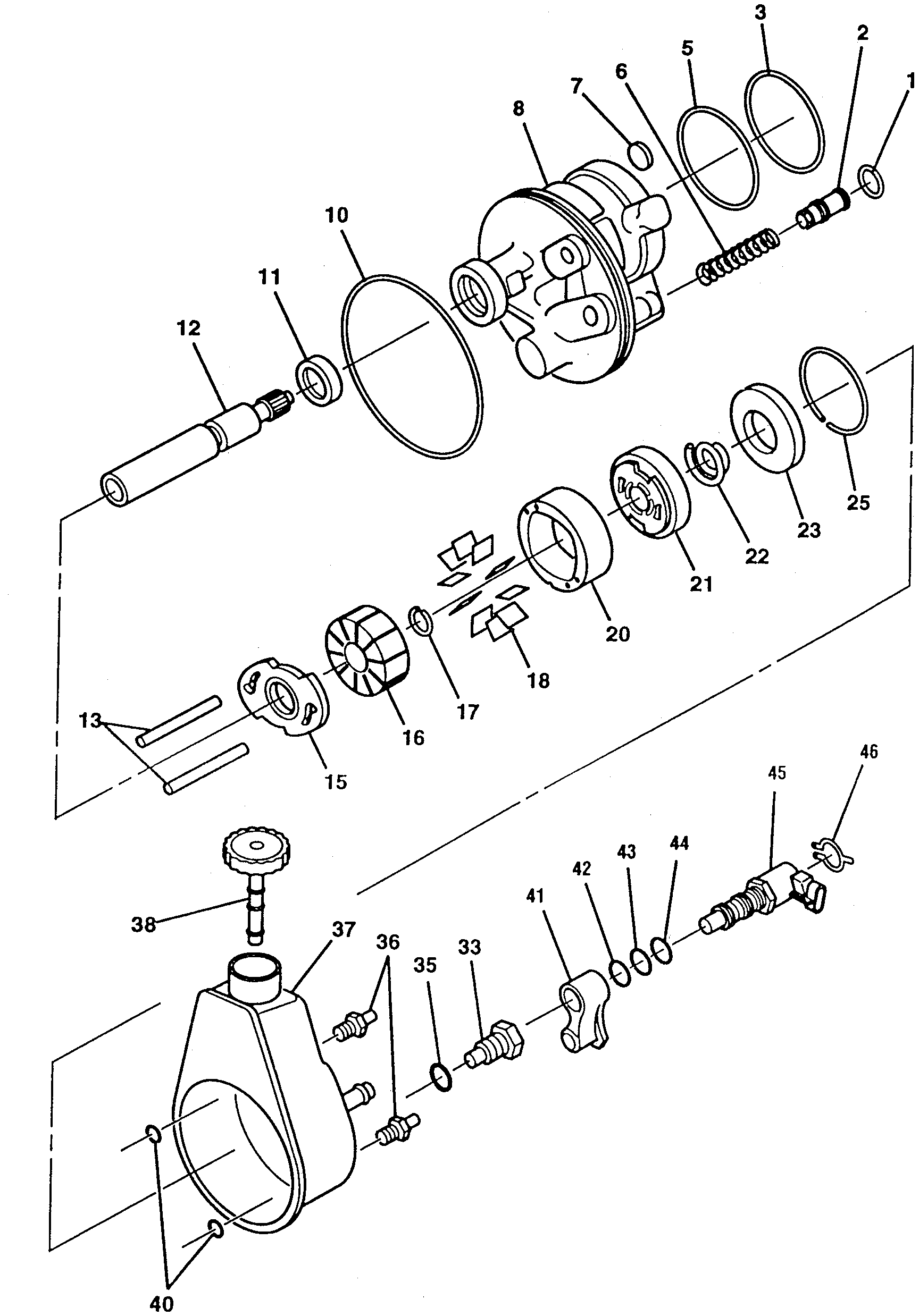

Here are the specifics.
POWER STEERING PUMP
Picture 4
^ Tools Required:
- J 25034-B Power Steering Pump Pulley Remover
- J 25033-B Power Steering Pump Pulley Installer
- Or Equivalents
REMOVAL
NOTE: Place a drain pan below the pump.
Remove or disconnect the following:
1. Hoses. Cap the hoses.
2. Unload the tensioner assembly.
3. Drive belt.
4. Pulley.

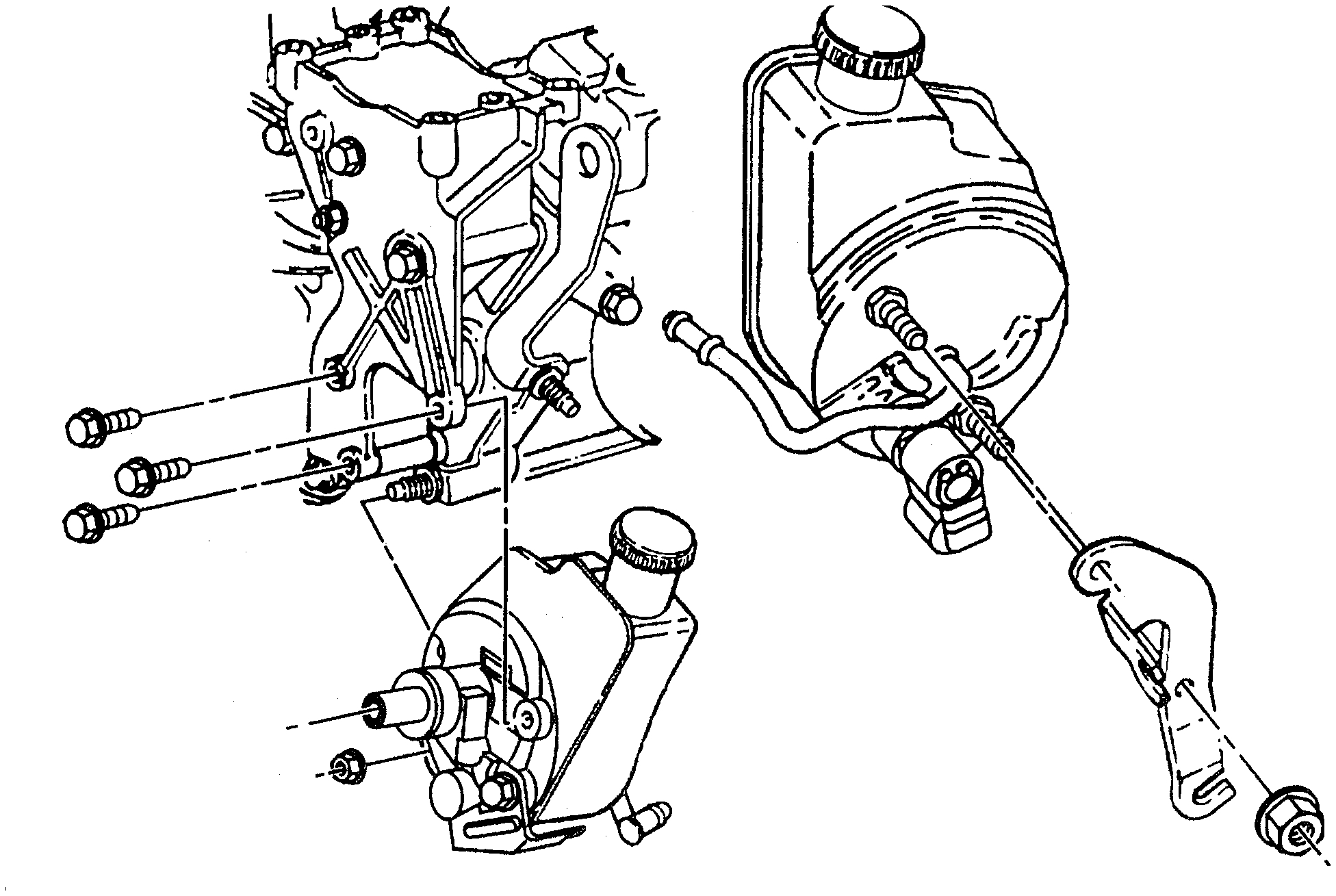

Picture 5
- Install J 25034-b. Be sure the pilot bolt bottoms in the pump shaft by turning the nut to the top of the pilot bolt.
- Hold the pilot bolt.
- Turn the nut counterclockwise.
5. Front mounting bolts.
6. Rear mounting nuts from studs.
7. Electrical connector from EVO actuator.
8. Pump.
INSTALLATION
CAUTION: Always use the correct fastener in the proper location. When you replace a fastener, use ONLY the exact part number for that application. The manufacturer will call out those fasteners that require a replacement after removal. The manufacturer will also call out the fasteners that require thread lockers or thread sealant. UNLESS OTHERWISE SPECIFIED, do not use supplemental coatings (paints, greases, or other corrosion Inhibitors) on threaded fasteners or fastener joint interfaces. Generally, such coatings adversely affect the fastener torque and joint clamping force, and may damage the fastener. When you install fasteners, use the correct tightening sequence and specifications. Following these instructions can help you avoid damage to parts and systems.
Install or connect the following:
1. Pump.
2. Front mounting bolts. Tighten to 50 Nm (37 ft. lbs.).
3. Rear mounting nuts to studs. Tighten to 50 Nm (37 ft. lbs.).
4. Pulley.
- Place pulley on the end of the pump shaft.
- Install J 25033-b. Be sure the pilot bolt bottoms in the shaft by turning the nut to the top of the pilot bolt.
- Turn the nut clockwise.
- Install pulley flush +/- 0.25 mm (0.010 inch) with the end of the power steering pump shaft.
CAUTION: Do not use arbor press or Internal damage to the pump will result.
5. Drive belt.
6. Load the tensioner assembly.
7. Hoses.
8. Electrical connector to EVO actuator. Fill and bleed the system.
