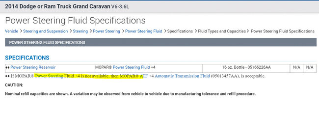

Flush the system. Regular power steering fluid in this vehicle will end up damaging the seals in the rack and pinion and the pump.
Chrysler has a power steering fluid +4 but the ATF +4 can be used. See the pic below for recommendations. Note: You don't have to purchase Mopar fluid. Just make sure the product you get replaces the OEM fluid.

There certainly are some products that can be used in place of others. However, going from what I read in the manual, they don't want you to use it in this vehicle.
Always read the cap to make sure you use the correct type. On some, they have an electric hydraulic pump that requires yet another type. LOL
