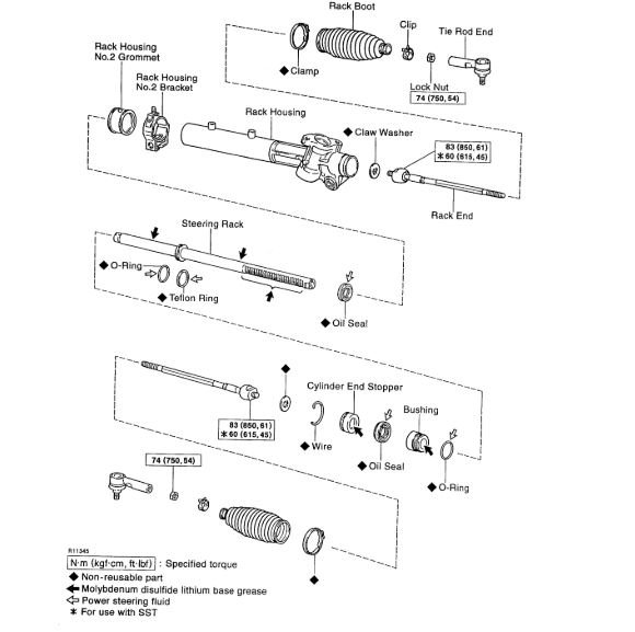

Not all the time but more and more when I turn to the right more at slow speeds it's like the power steering stops for a second. When backing up and cutting my wheels to the left the same thing.but the power steering pump is full of oil and works fine any other time. I am worried the problem could be more dangerous than the power steering pump.Can you please give me some sort of idea what it is? Thank you
Jun 9, 2019 at 11:11 AM
Good afternoon,
Make sure the belt is tight enough. It could be loose causing this issue.
The other possibility is the rack and pinion assembly. There may be a pressure issue internally causing this as well.
