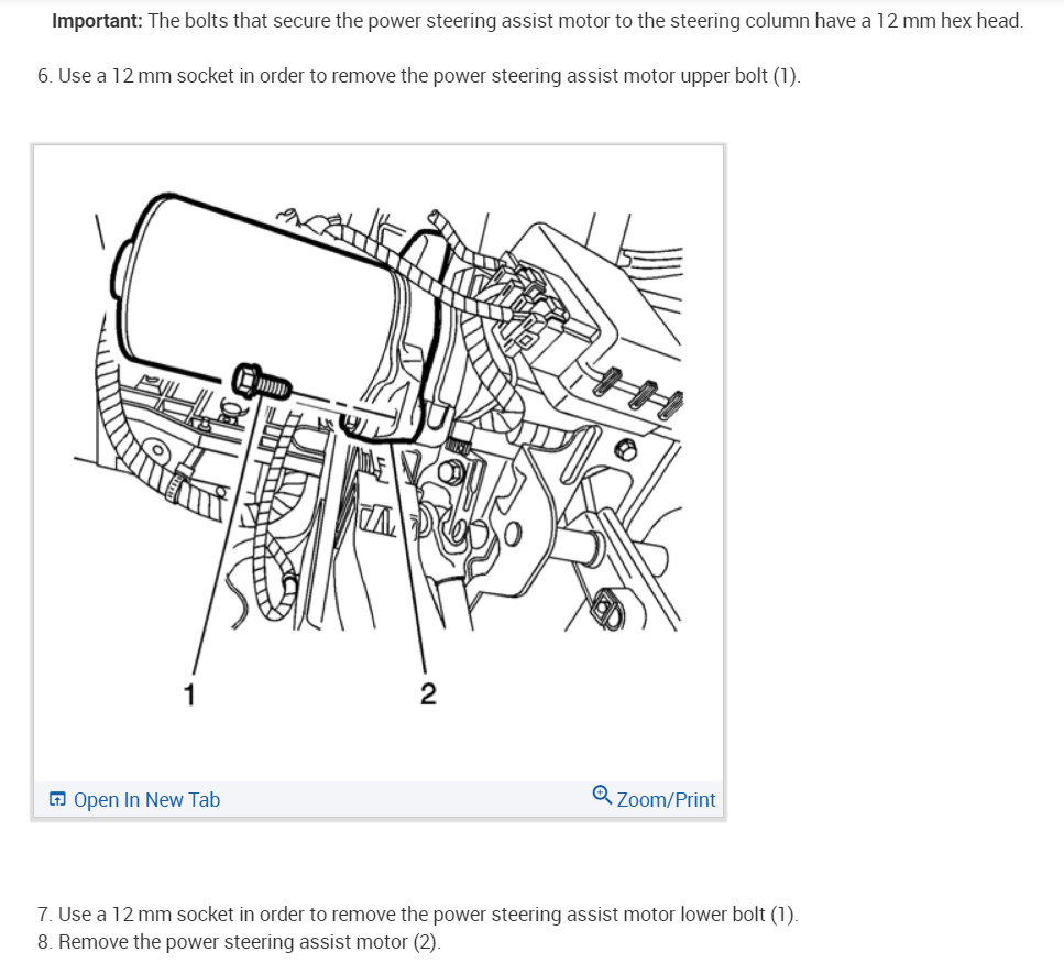

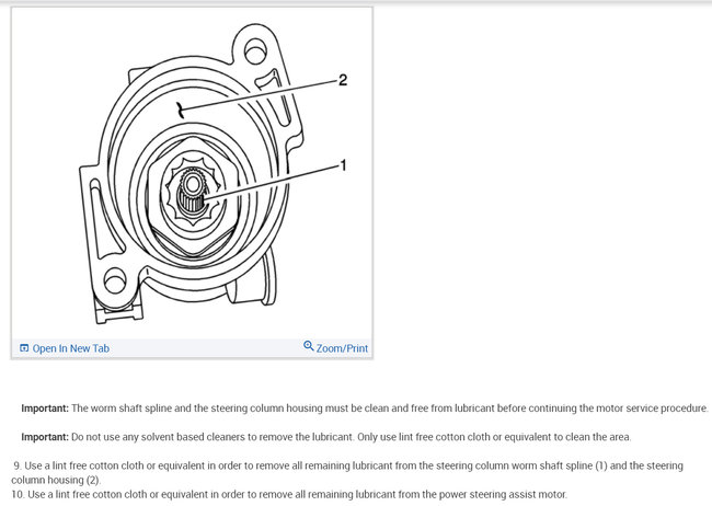

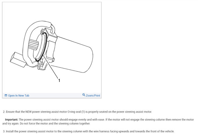

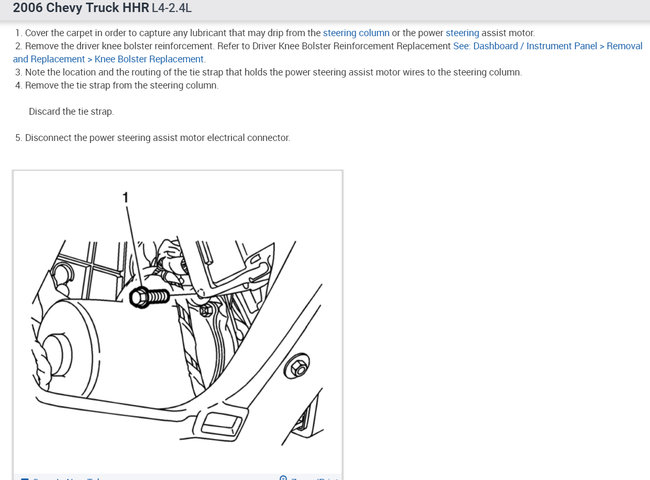

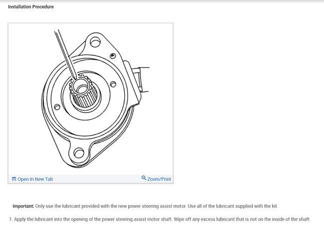

The steering motors are common on these cars, but we should run the codes to see what comes up. here is a guide to help us. Also I ave included instructions to replace the steering motor so you can see how the job is done.
Check out the diagrams (below). Please let us know what you find.
