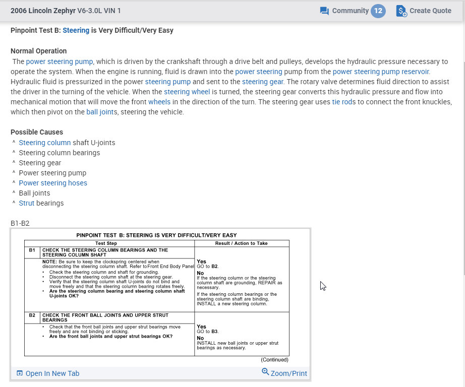

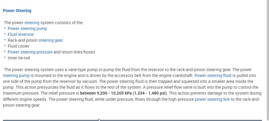

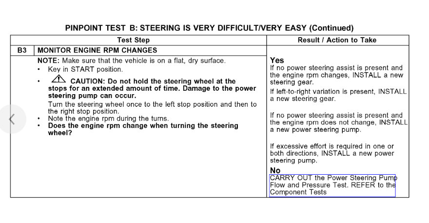

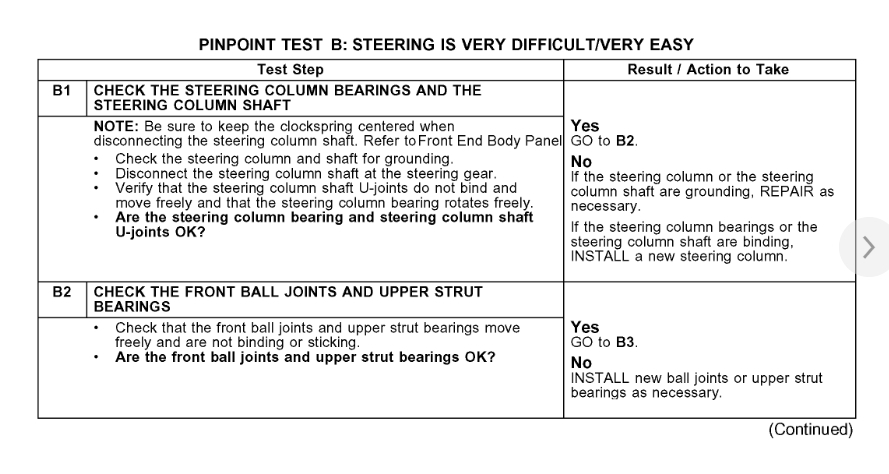

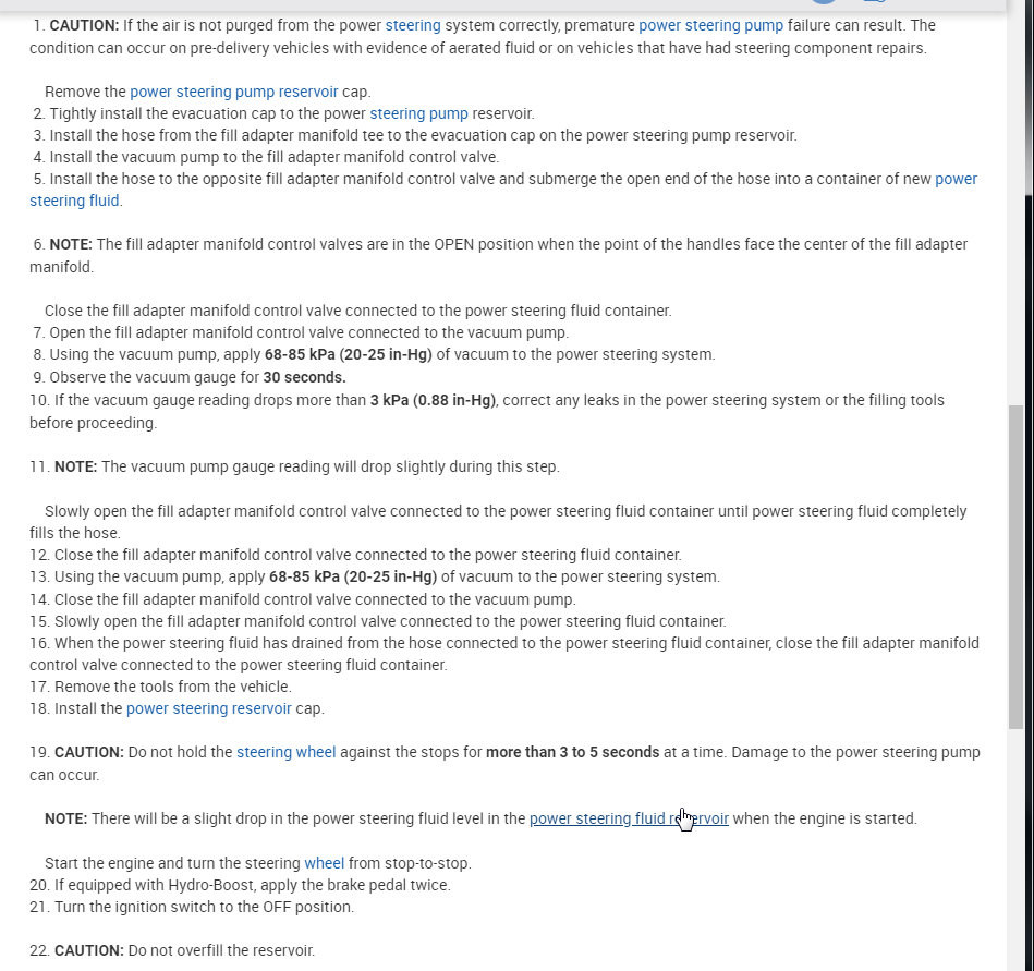

Hi. Last night when i was about 2 blocks away from home i noticed my steering wheel getting hard. When i got home and turned off my car i saw a puddle of oil. Right away i imaged it was power steering fluid. Opened the hood and checked fluid container and was empty. From the top of the engine there wasn't any signs of oil being splattered. I haven't had a chance to check bottom since i don't have a jack on me to lift it the oem jack bent on me the last time i used it. So i was wondering if it failed on me was it because the pump went out or would it be the rack and pinion? How would i be able to find which if the 2 are the cause. Also, if i could get information on how to remove and replace them please.

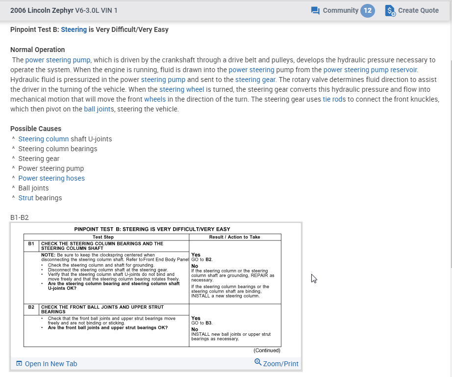

More than likely the steering got hard if there was low or no fluid in the pump. As for where the leak is coming from, clearly we will need to fill the reservoir and then operate the power steering while someone is looking for where the fluid is coming from. It could be the pump or rack, but it could also just be a line or fitting. Clearly the only way to know is to look for it.

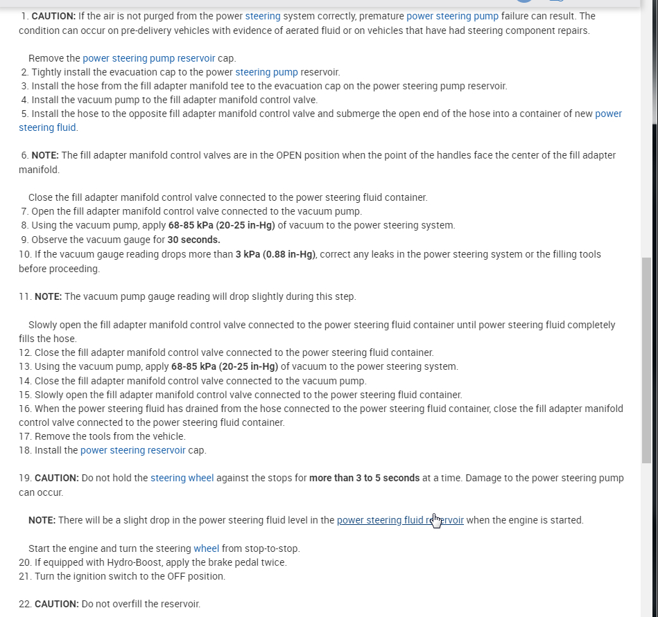

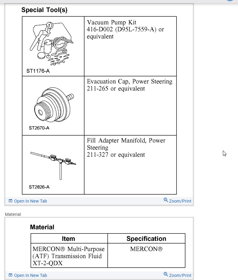

However, don't replace any parts until you find it and also don't put the pump or rack in it until you fix the leak and fill the system and remove the air from the system.
Let me know if you have questions. Thanks
