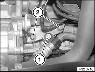

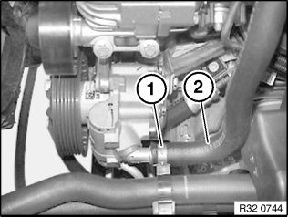

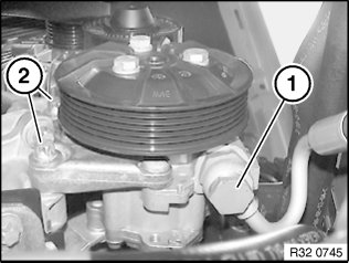

I have tried to send all directions but have been unsuccessful. Here are the basics for replacement. If you need torque specs, let me know.

Release hose clamp (1) and detach intake pipe (2) from vane pump.
Installation note:
Markings on intake pipe and vane pump connection must match up.

Release bolt (1) and remove bracket with refrigerant line.
Unfasten screws (2).
Installation note:
Replace aluminium screws.
Observe screwing sequence!
pic 3
Release banjo bolt (1) and disconnect pressure line.
Installation note:
Replace all sealing rings (D).
Make sure pressure line is laid without tension and with sufficient spacing to adjoining components.
