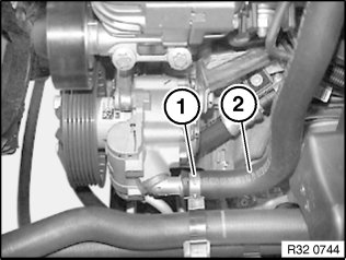

I have tried to send all directions but have been unsuccessful. Here are the basics for replacement. If you need torque specs, let me know.
pic 1
Release hose clamp (1) and detach intake pipe (2) from vane pump.
Installation note:
Markings on intake pipe and vane pump connection must match up.

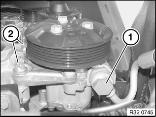

pic 2
Release bolt (1) and remove bracket with refrigerant line.
Unfasten screws (2).
Installation note:
Replace aluminium screws.
Observe screwing sequence!

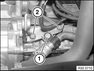

pic 3
Release banjo bolt (1) and disconnect pressure line.
Installation note:
Replace all sealing rings (D).
Make sure pressure line is laid without tension and with sufficient spacing to adjoining components.
