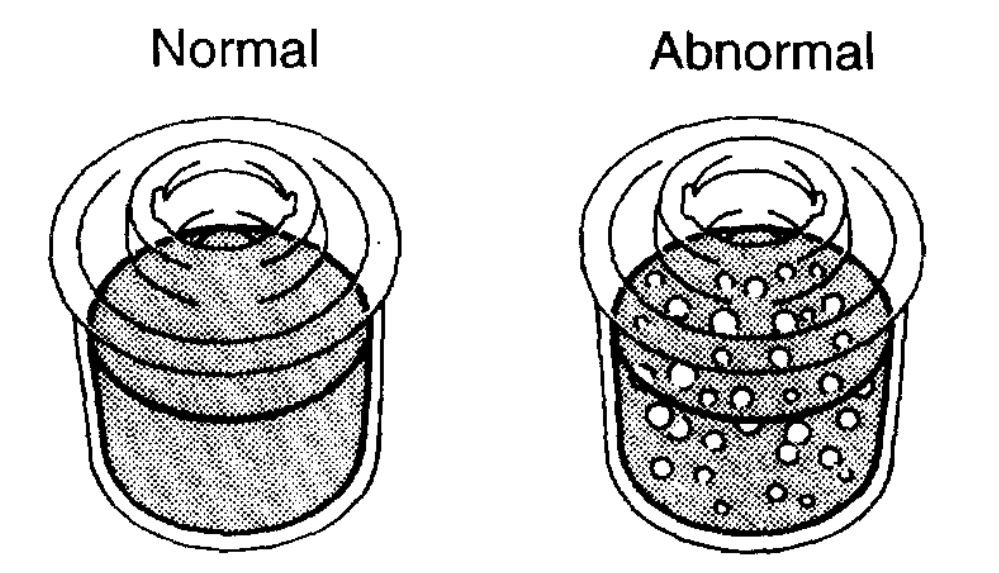

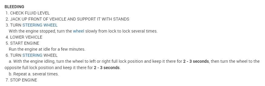

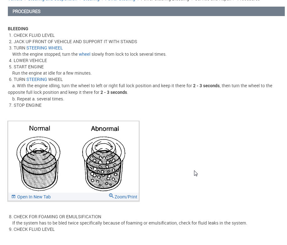

Noise in the power steering is either air or a faulty pump so I think you are correct with bleeding it.
Here is the process from Toyota. There are other ways but let's just do what they suggest.
Run through this and let me know what happens. Thanks

Good afternoon,
That is the way you bleed the power steering pump of air. You need to turn it left and hold it all full turn for about 5 seconds and then turn it right and do the same.
https://www.2carpros.com/articles/power-steering-problems
Do this procedure at least 3 times to get rid of the air.
Does the steering feel okay?

No screen as this is a plastic reservoir. removed the fluid from inside it and removed it, cleaned it out as much as i can and out it back, out in more fluid, Bled it more , gotten much better, maybe there was dirt and maybe the fluid is just bad. Added more fluid and the foaming is less now. If noise was at 100% before the whine is about 40% now, am gonna suck the fluid out again and put in some more. What ATF that isn't too expensive i can use? Since most of it gonna go to waste. I will suck it out of reservoir , add more and start it and do it over and over until it is clear.

I have no more foam and the noise is better, but whenever I put in new fluid in the reservoir, start the car, turn the steering 5 times right and left then suck the fluid again it doesn't look that bad. is it possible it is not moving? but if it Is not moving the steering would have been hard correct?
