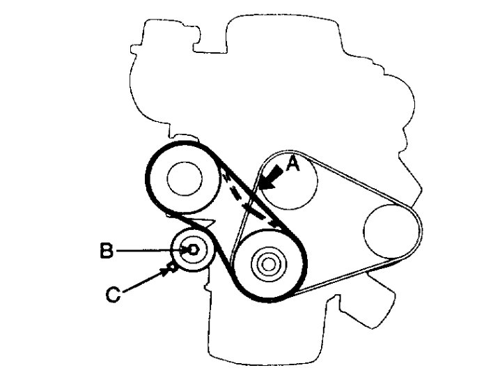

Power steering belt squeals when first turn car on initially for a minute. want to adjust the tension because the belt seems fine. how do I do that?

if the belt is in good condition adjust as follow:
Adjustment
1. Loosen the tension mounting bolt (B).
2. Turn the adjusting bolt (C) to obtain the proper belt tension, and then re-tighten the mounting bolt (B).
3. Recheck the deflection of the A/C compressor belt.

To get to it? Wheel off and inner cover?

Yes, to have complete access you must remove the wheel and the inner cover.
