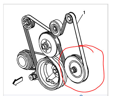

In pic 1, is the circled item where the belt is coming off? If that is the case and the belt is loose, I suggest replacing the belt tensioner.

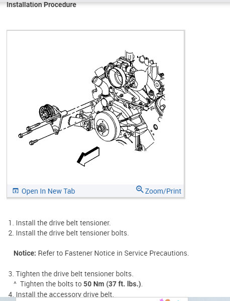

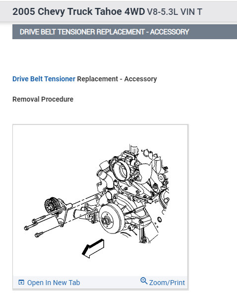

The last three pics below are the directions for the removal and replacement of the belt tensioner.
