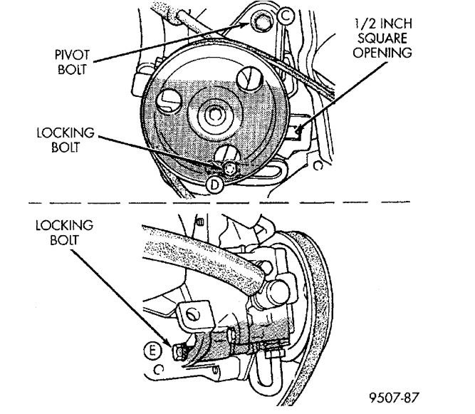

Power steering belt keeps coming off car.
Jan 3, 2019 at 7:35 AM
Good afternoon,
The first thing that needs to be checked is the belt alignment. look at all the pulleys with the belt on and check and see if anything is not in alignment. it could be the pulley on the pump or the idler pulley.
did you install the belt or did a shop do this for you?
