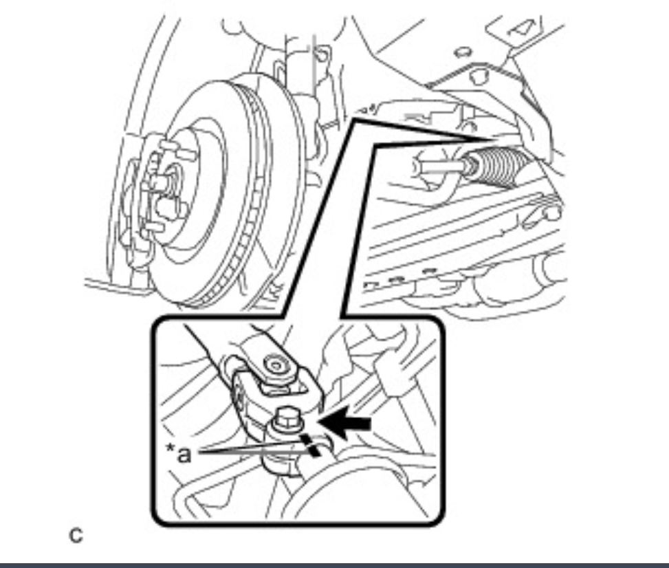

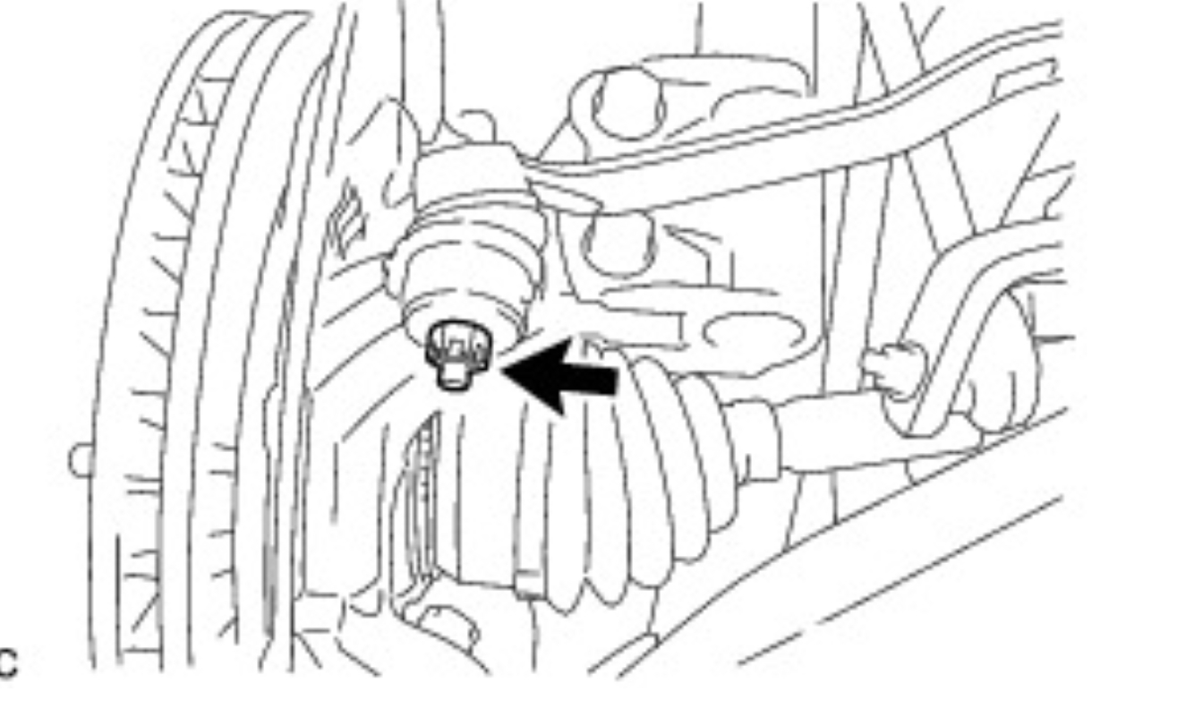

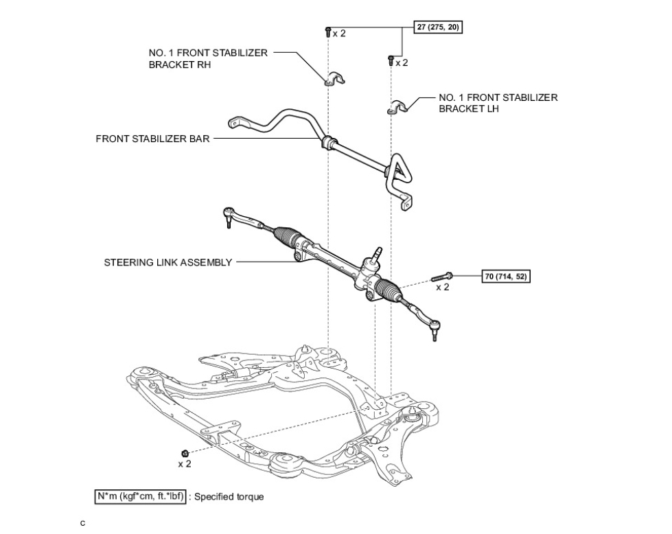

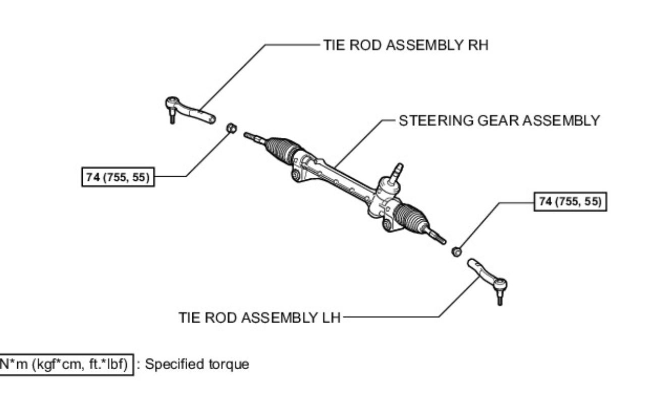

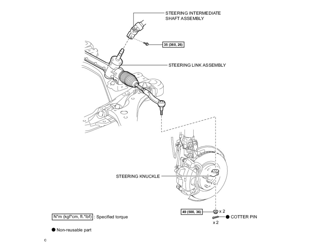

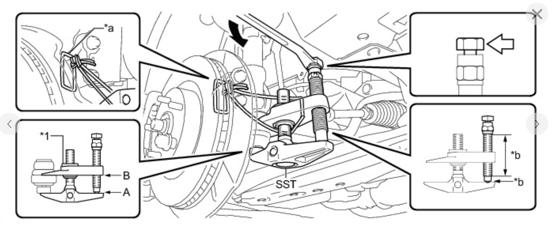

As soon as I turn on vehicle while on park my steering wheel automatically turns all the way to the right and stays there. I would have to force it back to the left and it will go right back to the right as soon as I let go. could that be the reason why my steering is doing that? I think ti needs a new steering rack.
Feb 14, 2019 at 2:48 AM
Good evening,
I attached the procedure for you below of the replacement of the rack assembly.
Yes, it is an internal failure of the rack itself.

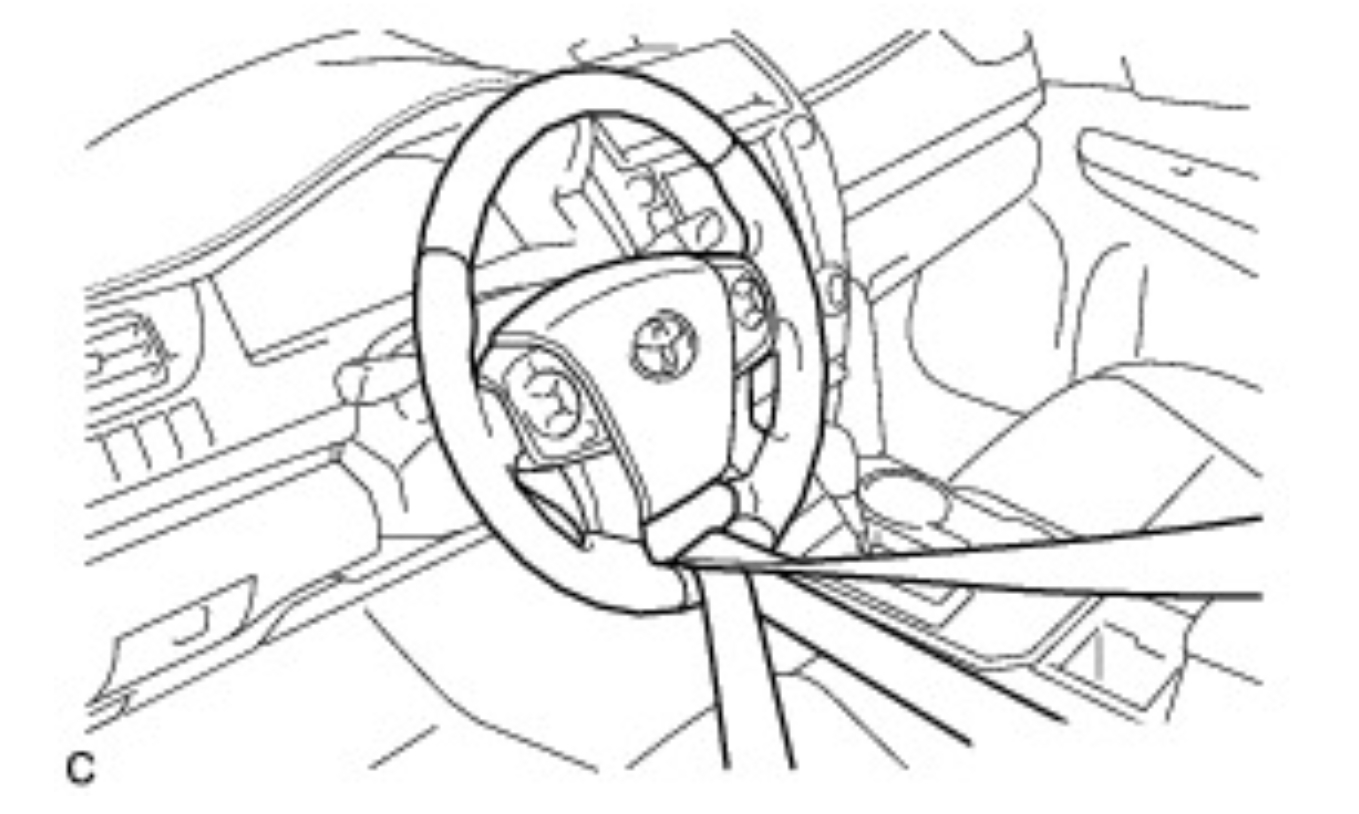

SECURE STEERING WHEEL
Secure the steering wheel with the seat belt in order to prevent rotation.
HINT:
This operation is useful to prevent damage to the spiral cable.
SEPARATE STEERING INTERMEDIATE SHAFT ASSEMBLY
Put matchmarks on the steering intermediate shaft assembly and steering link assembly.
Text in Illustration
*a Matchmark
Remove the bolt.
Separate the steering intermediate shaft assembly from the steering link assembly.

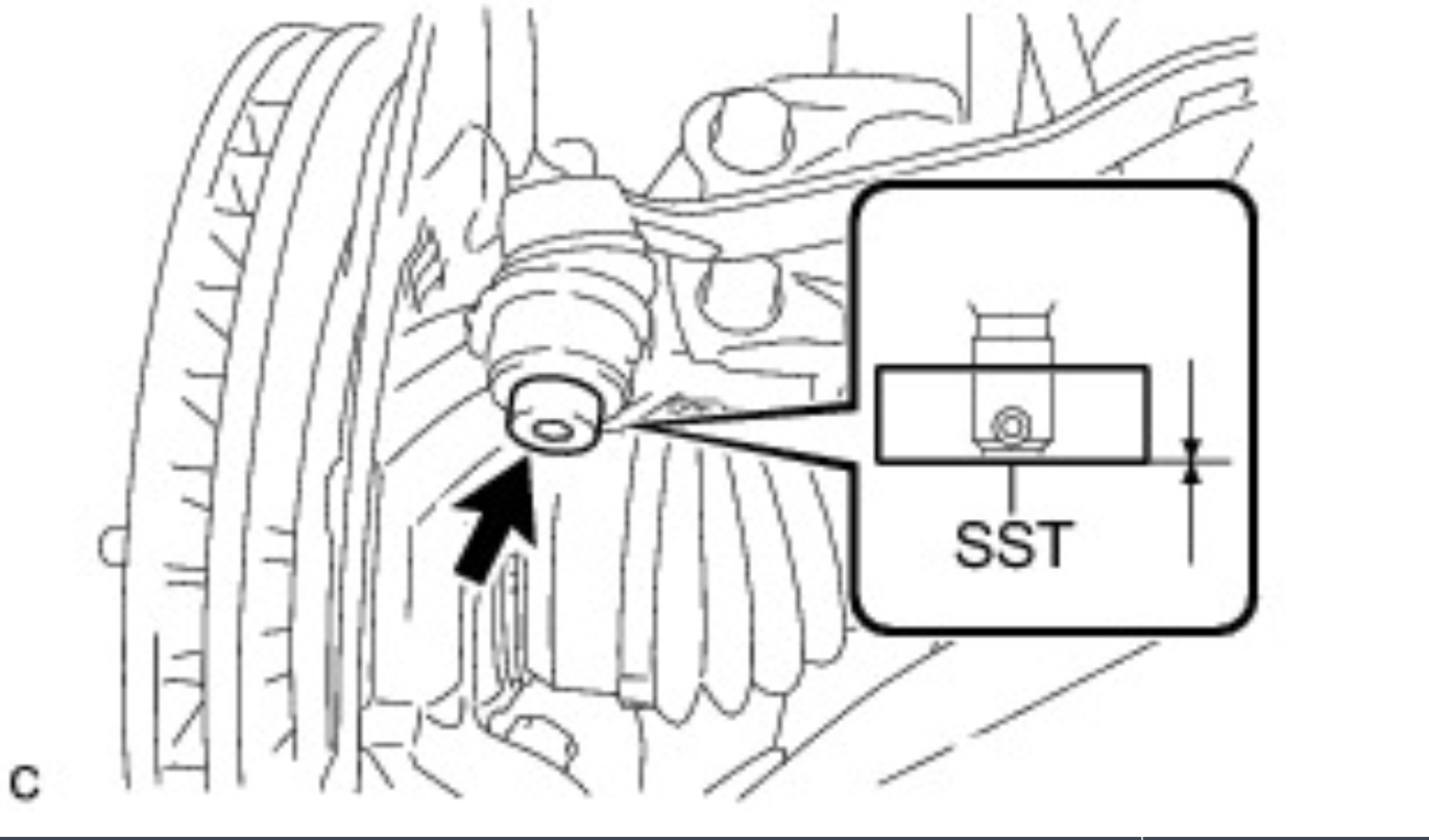

SEPARATE TIE ROD ASSEMBLY LH
Remove the cotter pin and nut.
Install SST to the tie rod assembly LH.
SST : 09960-20010
09961-02060
NOTICE:
Make sure that the lower ends of the tie rod assembly LH and SST are aligned.
Secure SST using a string.
NOTICE:
Be sure to tighten the string firmly to secure SST to the steering knuckle to prevent SST from falling off.
Using SST, separate the tie rod assembly LH from the steering knuckle.
*1 Center Nut - -
*a String *b Grease Application Area
Place the wrench here. - -
SST : 09960-20010
09961-02010
CAUTION:
Apply grease to the bolt threads and the tip of SST.
NOTICE:
Install SST with the center nut so that A and B shown in the illustration are parallel. Otherwise, the dust cover may be damaged.
Be sure to place the wrench on the part indicated in the illustration.
Do not damage the front disc brake dust cover.
Do not damage the ball joint dust cover.
Do not damage the steering knuckle.

REMOVE NO. 1 FRONT STABILIZER BRACKET LH [ FRONT SUSPENSION: FRONT STABILIZER BAR: REMOVAL+ ]
REMOVE NO. 1 FRONT STABILIZER BRACKET RH
HINT:
Perform the same procedure as for the LH side.
REMOVE FRONT STABILIZER BAR [ FRONT SUSPENSION: FRONT STABILIZER BAR: REMOVAL+ ]

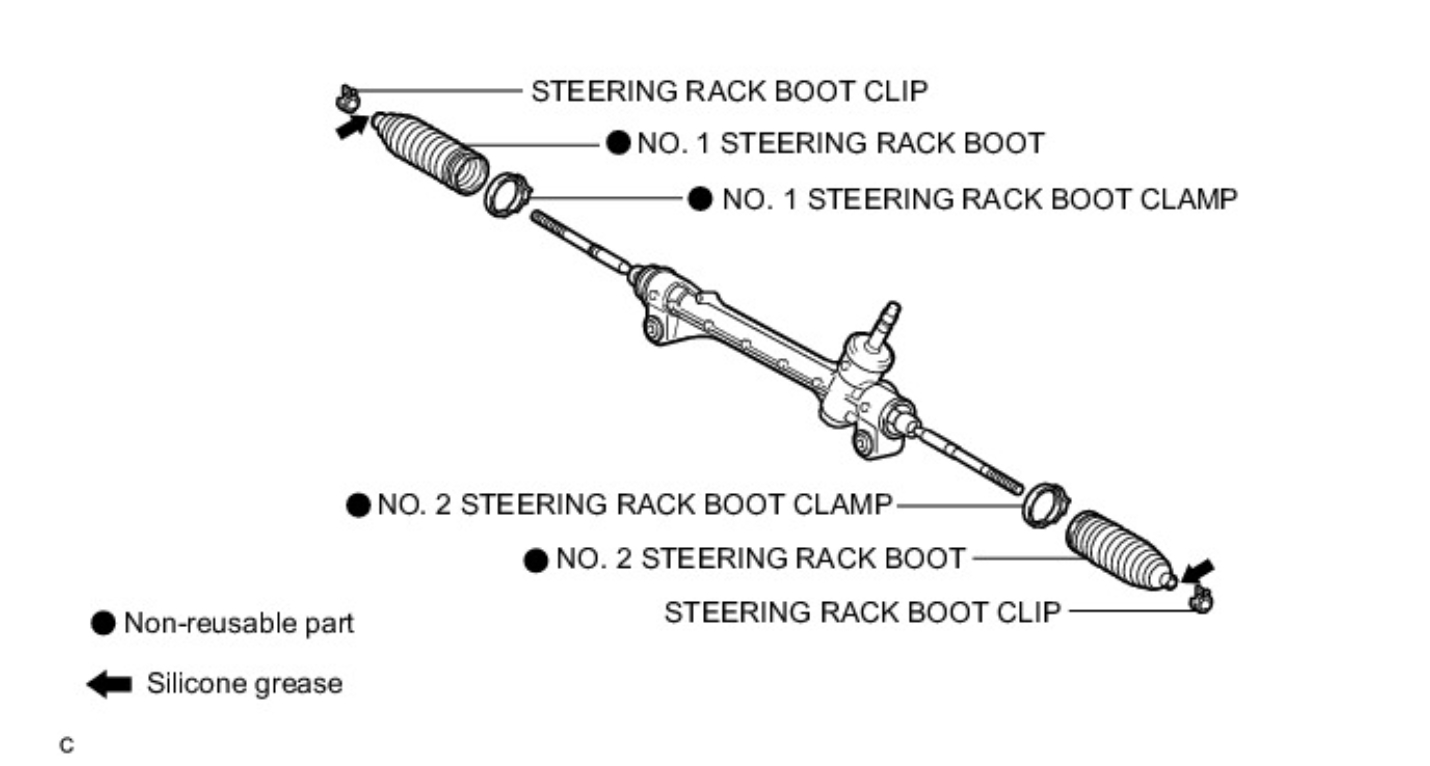

REMOVE STEERING LINK ASSEMBLY
Remove the 2 bolts, 2 nuts and steering link assembly.
NOTICE:
Keep the nut from rotating while turning the bolt because the nut has its own stopper.
SECURE STEERING LINK ASSEMBLY
Using SST, secure the steering link assembly in a vise.
*1 Protective Tape
SST : 09612-00012
HINT:
Tape SST before use.
REMOVE TIE ROD ASSEMBLY LH
Put matchmarks on the tie rod assembly LH and the steering rack end sub-assembly.
*a Matchmark
Remove the tie rod assembly LH and lock nut.
REMOVE TIE ROD ASSEMBLY RH
HINT:
