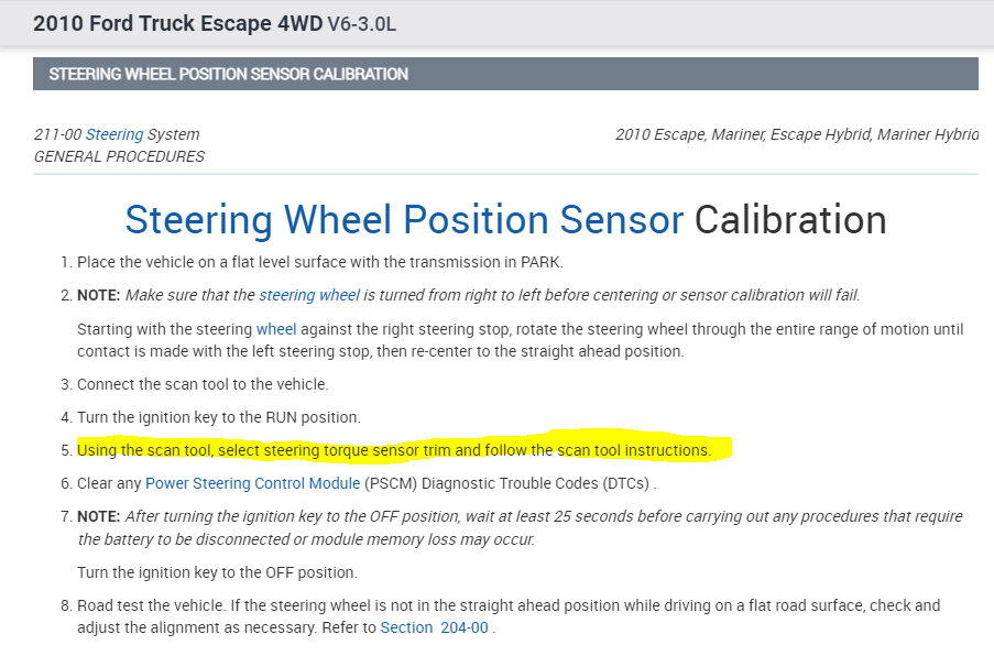

Have replaced the torque sensor. Was sporadically having Stability Control light. Do I need to calibrate the new sensor?
May 15, 2023 at 11:29 AM
  • 110,244 POSTS
With the engine running and a properly installed sensor, the steering wheel should stay centered. Is that happening? If it is off, the wheel will turn all the way in one direction or the other based on how the sensor was installed.
If it does center, then it needs to be calibrated. If you look below, I attached the directions. It will require a scan tool that can communicate with the power steering control module.
Let me know if this helps or if you have questions.
See pic below.

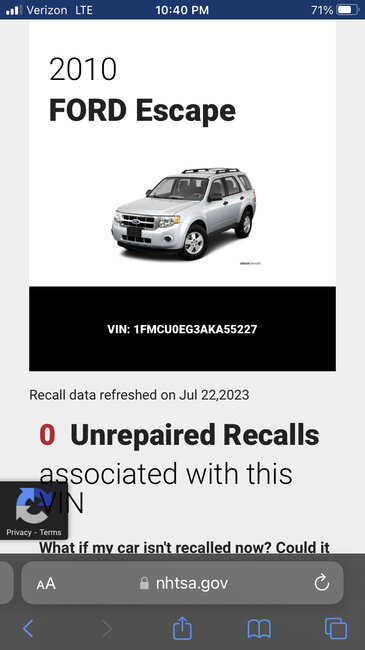

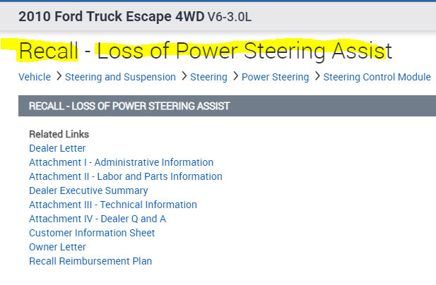

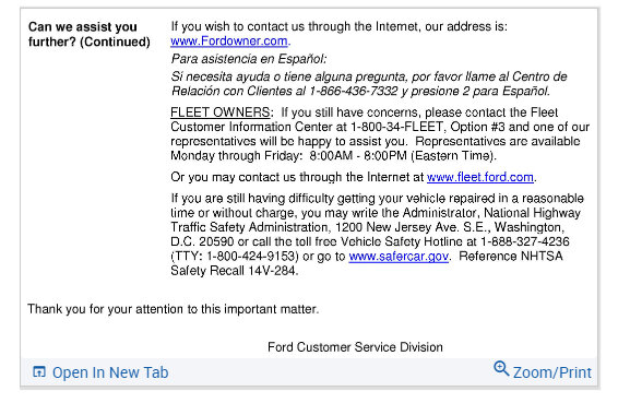

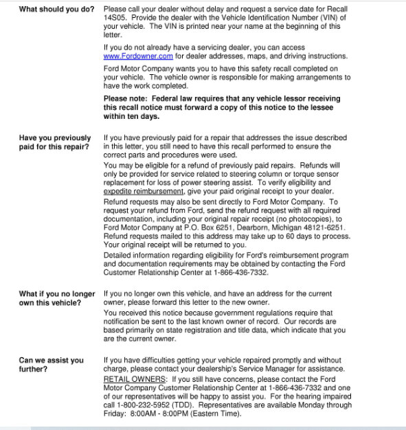

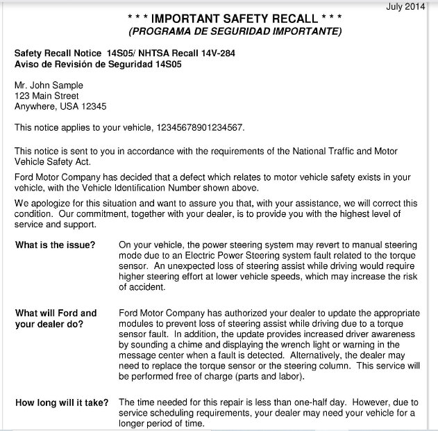

I found a recall on the unit. See pics below. Do you remember having this done? It is specific to loss of power assist.
If you are referring to the power steering control module, it likely needs programming.
Let me know if the recall was done on your vehicle.
Jul 21, 2023 at 12:48 PM
EDGE62
  • 7 POSTS
I looked for a recall before and found none. Crazy, that recall is my vehicle. Did another search but found none. It drives a bit stiff when turning, but the fault message is gone.
Jul 21, 2023 at 3:51 PM
  • 110,244 POSTS
Have you tried contacting a dealership? They may have a way to find specific information based on your vehicle's VIN number.
