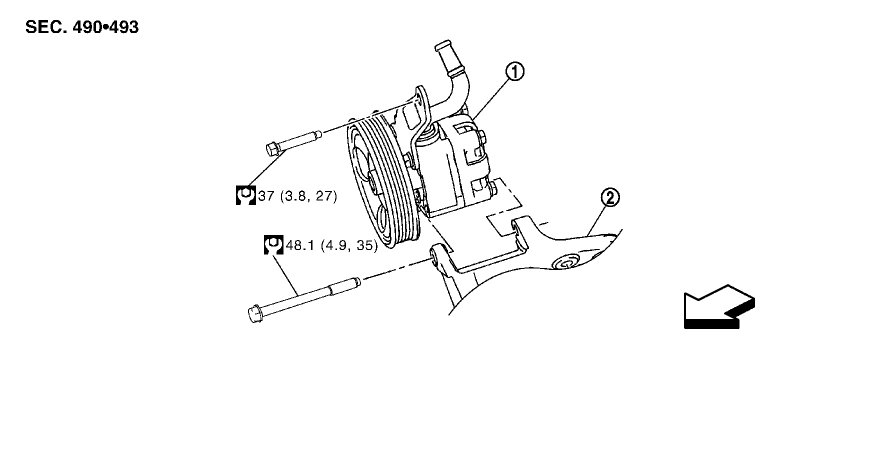

1. Power steering fluid bubbles when car is parked and running. Dealer replaced rack and pinion but says some turbulence is normal as fluid returns to resivor.

First the air is getting into the power steering system becasue the pump is bad allowing air to be sucked in while in operation.
Here is a guide to help you see what needs to be done:
https://www.2carpros.com/articles/how-to-replace-a-power-steering-pump
Here is what it will be like on your car (diagrams below).
