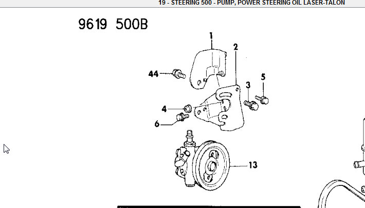

My son bought the vehicle listed above for his first project vehicle. It came without a steering pump and the replacement he bought did not have the anchor bolts.
We are trying to find out what size the bolts are so we can replace them.
Mar 12, 2021 at 12:56 AM
Take a look at the first attachment below for which bolt you are looking for. I then attached each listing that has the size for some of them but the Mopar part number for each one as well.
Please let us know if you need a different bolt and we can get that as well.
