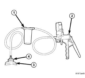

I started having symptoms like my power steering was about to fail because there was no power steering unless in higher rpm. I replaced the power steering pump. My power steering is now very weak when not moving. On dry pavement it is very hard to turn the wheel. When moving it is not bad and almost seems to be working fine. I jacked up the front of my vehicle and moved the wheel back and forth with no noise. When on dry parent it whines. I already flushed the system and replaced the pump. This is my second power steering pump since May. Thank you

If you are hearing noise, either the pump is bad or there is air in the system. I'm not sure if you bled the new pump. Here are the directions. It requires specialized tooling to do. The attached pics correlate with the directions.

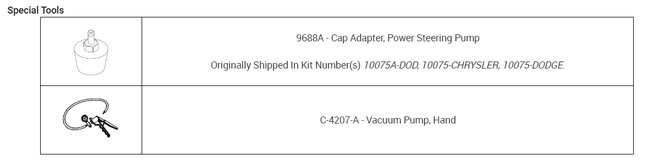

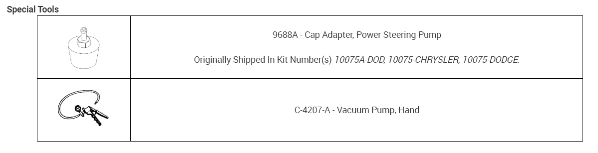

Special Tools
Pic 1
9688A - Cap Adapter, Power Steering Pump
Originally Shipped In Kit Number(s) 10075A-DOD, 10075-CHRYSLER, 10075-DODGE.
C-4207-A - Vacuum Pump, Hand

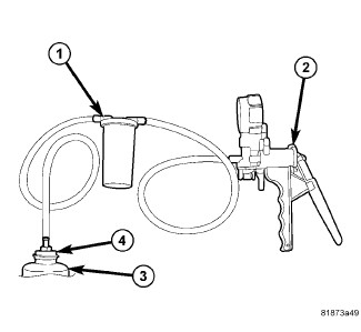

Tightly insert Power Steering Cap Adapter (4), Special Tool 9688A , into the mouth of the reservoir (3).
CAUTION:
Failure to use a vacuum pump reservoir (1) may allow power steering fluid to be sucked into the hand vacuum pump.
Attach Hand Vacuum Pump (2), Special Tool C-4207-A or equivalent, with reservoir (1) attached, to the Power Steering Cap Adapter (4).
