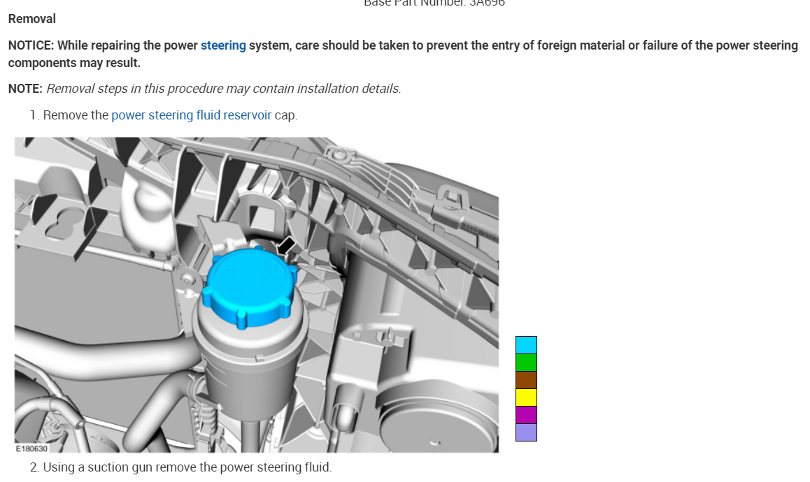

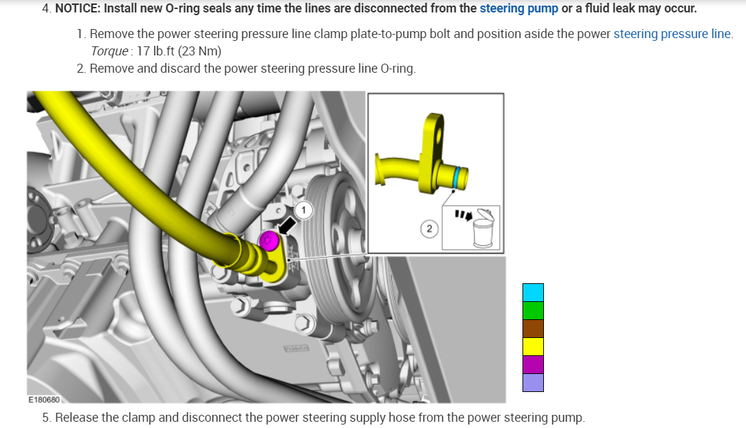

There is no leaks, no whining, belts good but there is no power steering at all and the fluid is good.
Aug 30, 2023 at 2:36 AM
  • 55,616 POSTS

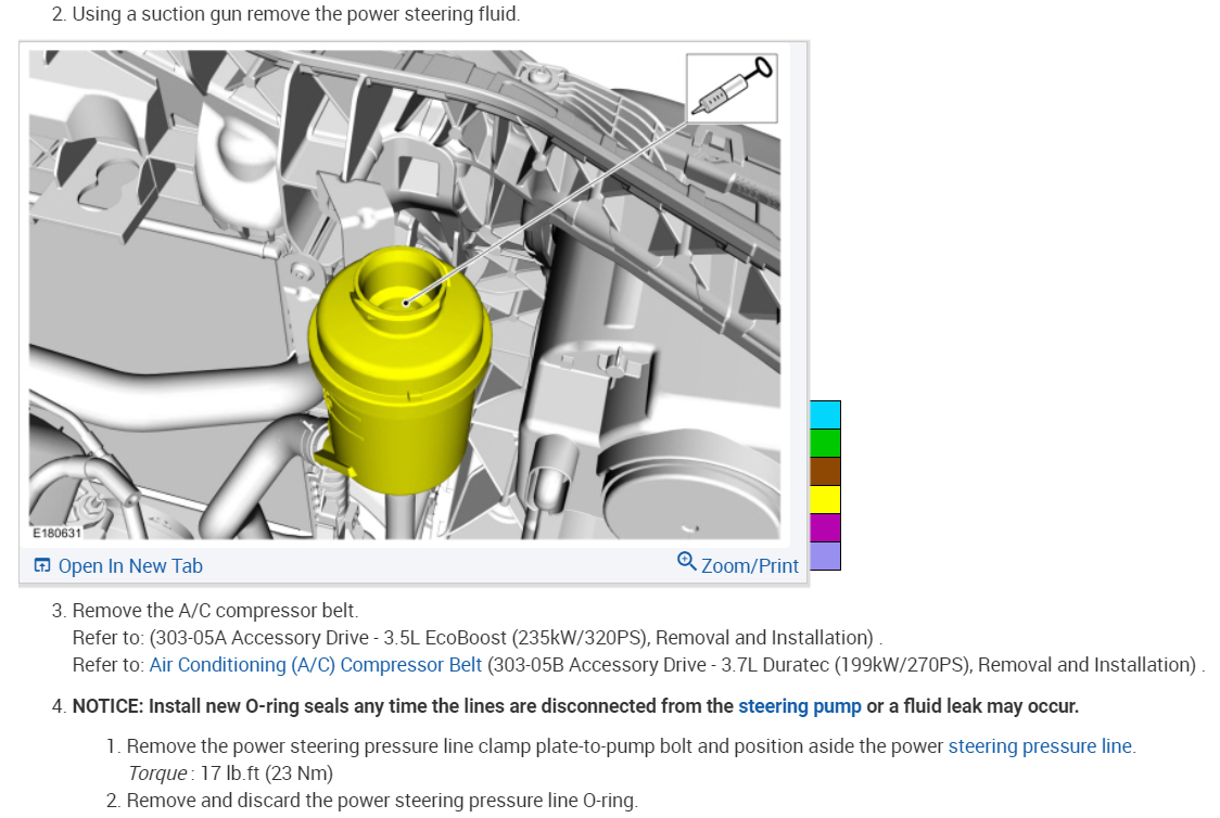

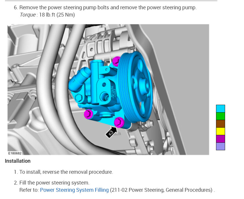

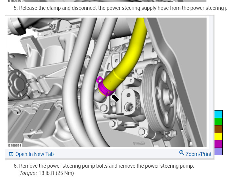

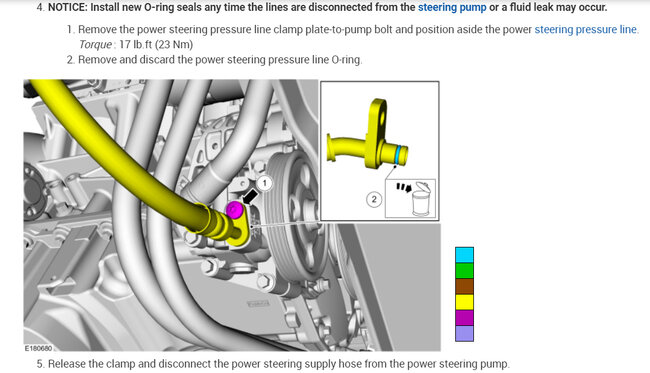

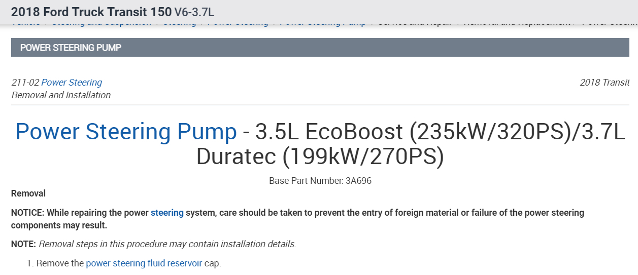

If the power steering so not working in either direction it means the pump has gone out. Here is how to replace it, also here is a guide that may help as well.
https://www.2carpros.com/articles/power-steering-problems
