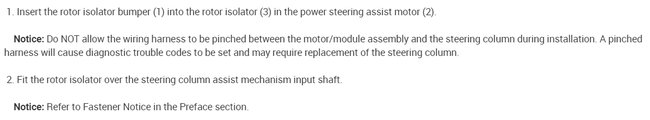

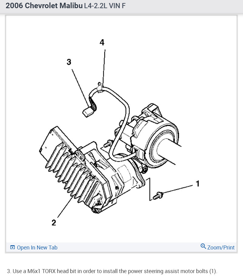

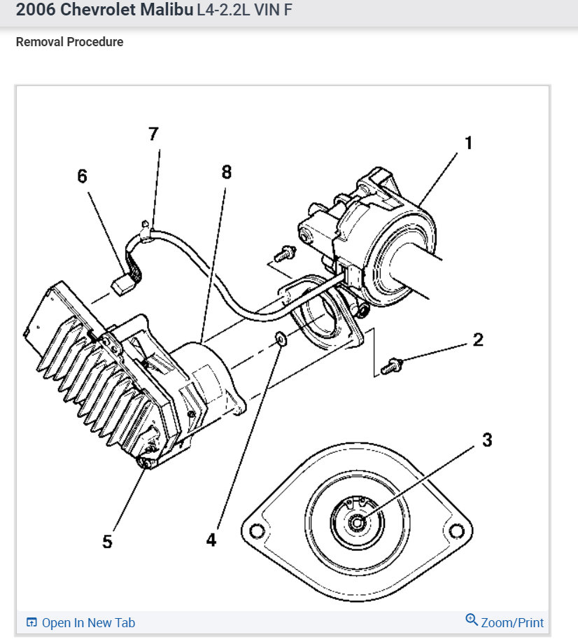

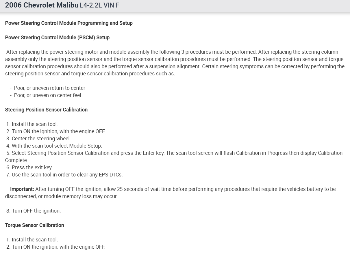

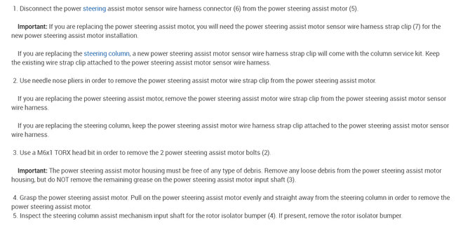

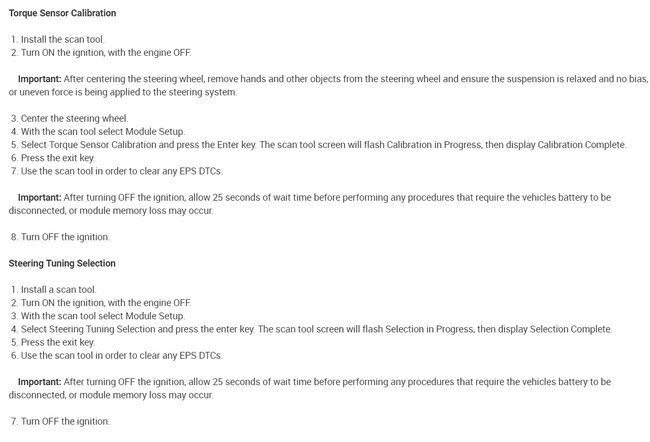

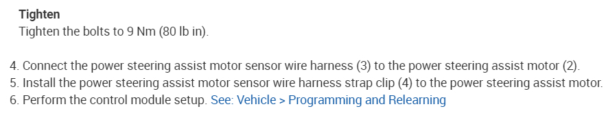

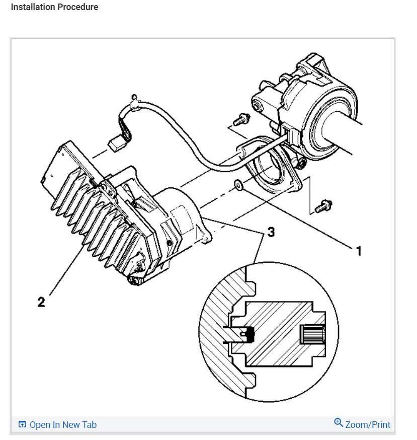

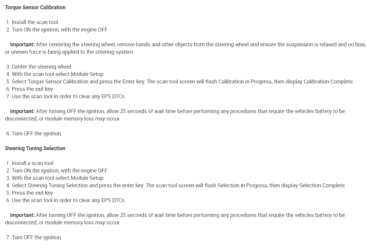

  • 54,832 POSTS
What happens on these is the steering motor goes out. Here is how to replace it. It might fix the speedometer as well. Check out the diagrams (below). Please let us know what you find. We are interested to see what it is.
Nov 27, 2019 at 2:43 PM

  • 5 POSTS
He came over today and did a quick diagnostic. Throwing a speed sensor fault. Along with a couple others. He went ahead and reset everything. Which fixed the power steering as well as the dashes in the message center. Speedometer still doesn't work. So I am going to replace the speed sensor and see where it all stands.

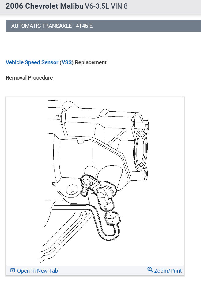

  • 54,832 POSTS
Sounds good, that is how the steering issue starts, you can reset it back it will probably come back. Here is the VSS sensor location in the diagrams below. Check out the diagrams (below). Please let us know what you find. We are interested to see what it is.
