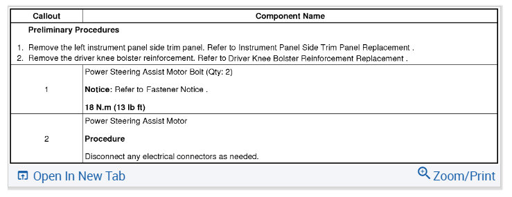

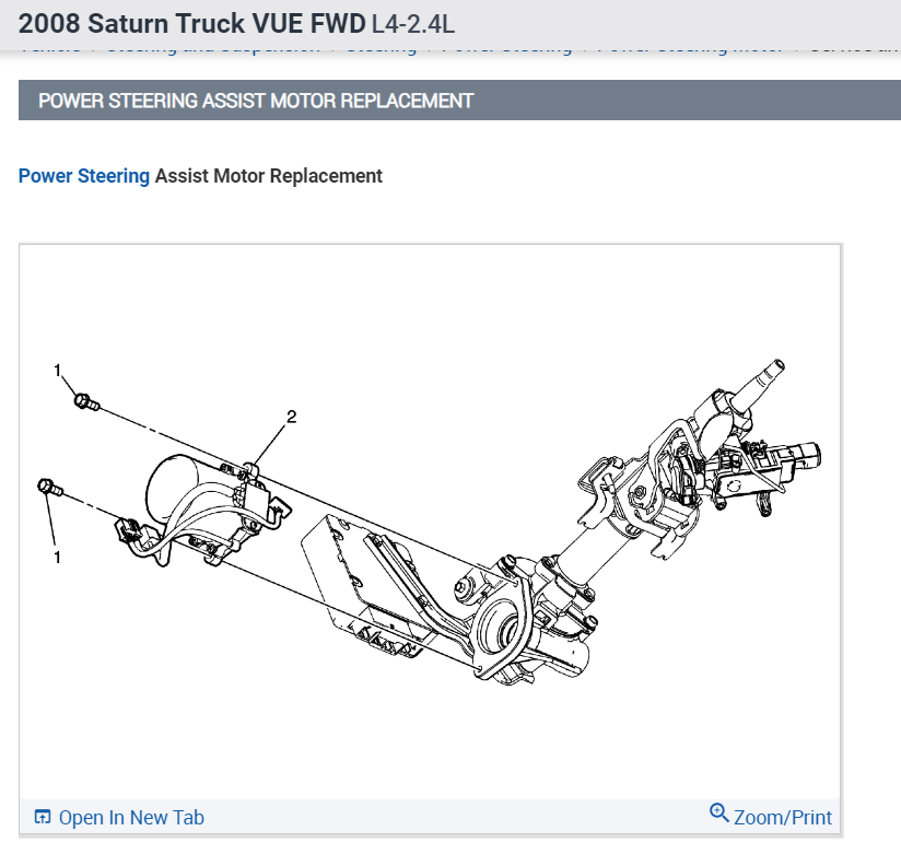

Can't find where to check and add power steering fluid.
Oct 30, 2023 at 7:37 AM
  • 55,224 POSTS
This car has electric power steering so there is no power steering pump or fluid to check. What kind of problem are you having? Here is what the system looks like, so you know how it works. Check out the images (below). Let us know what happens and please upload pictures or videos of the problem so we can see what's going on.
