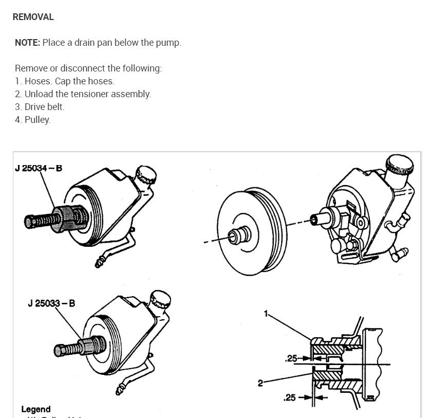

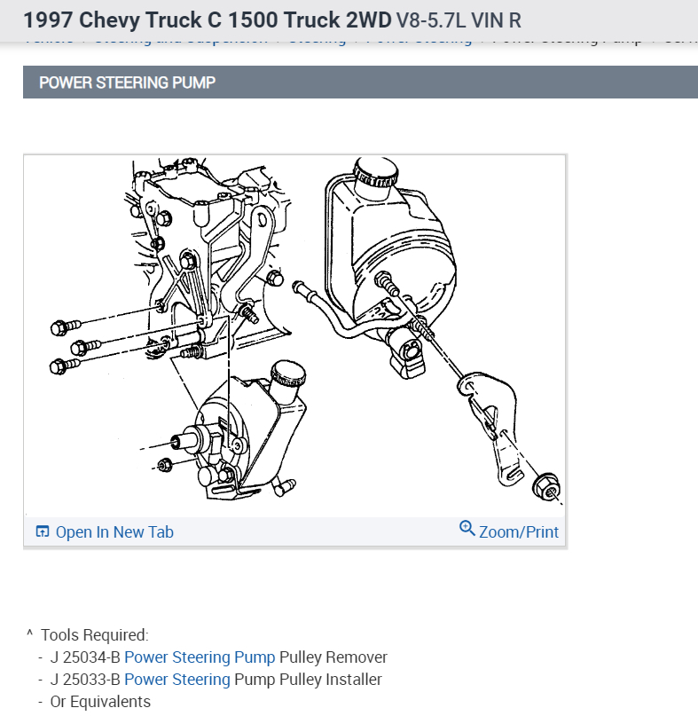

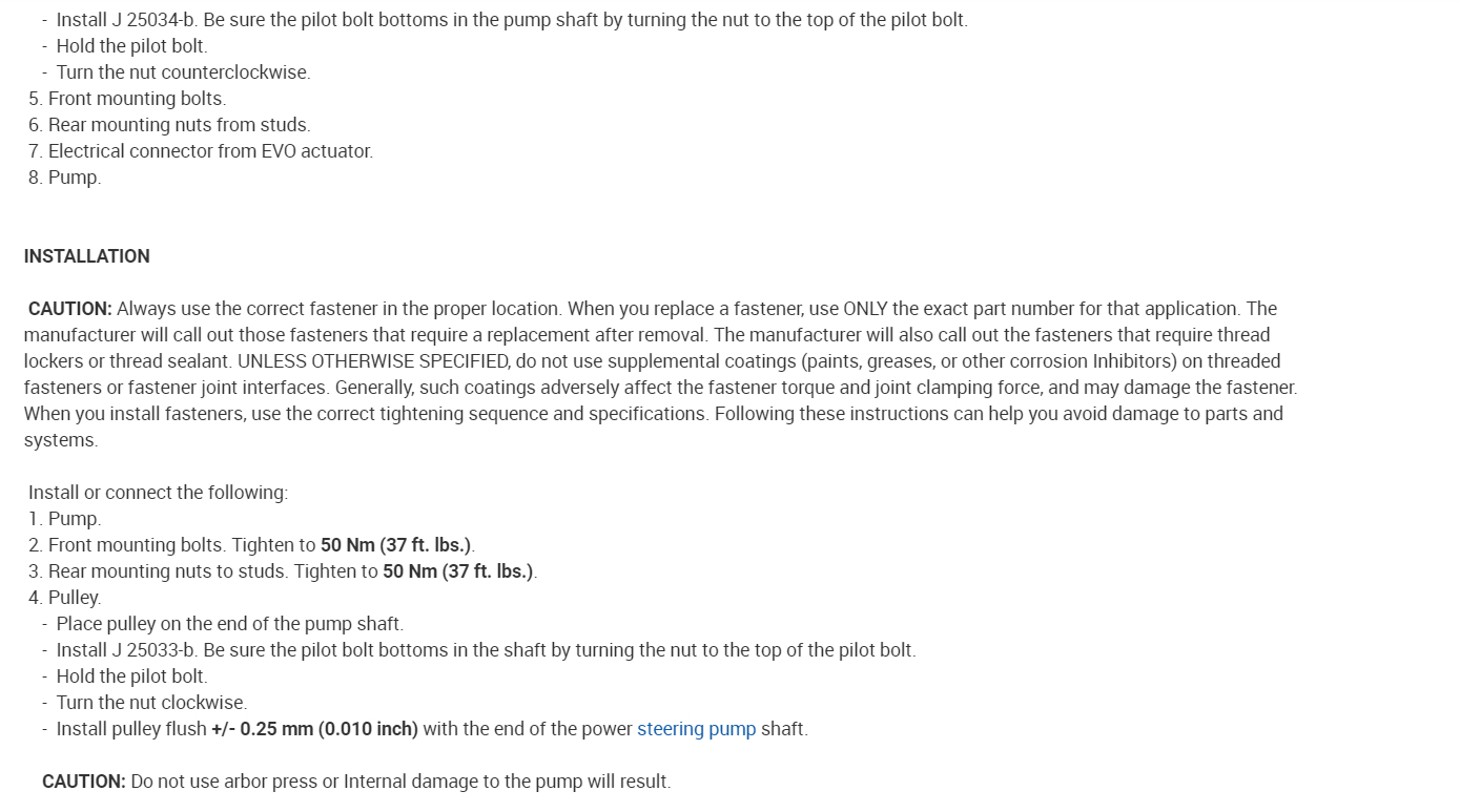

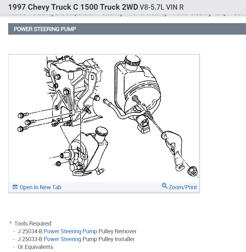

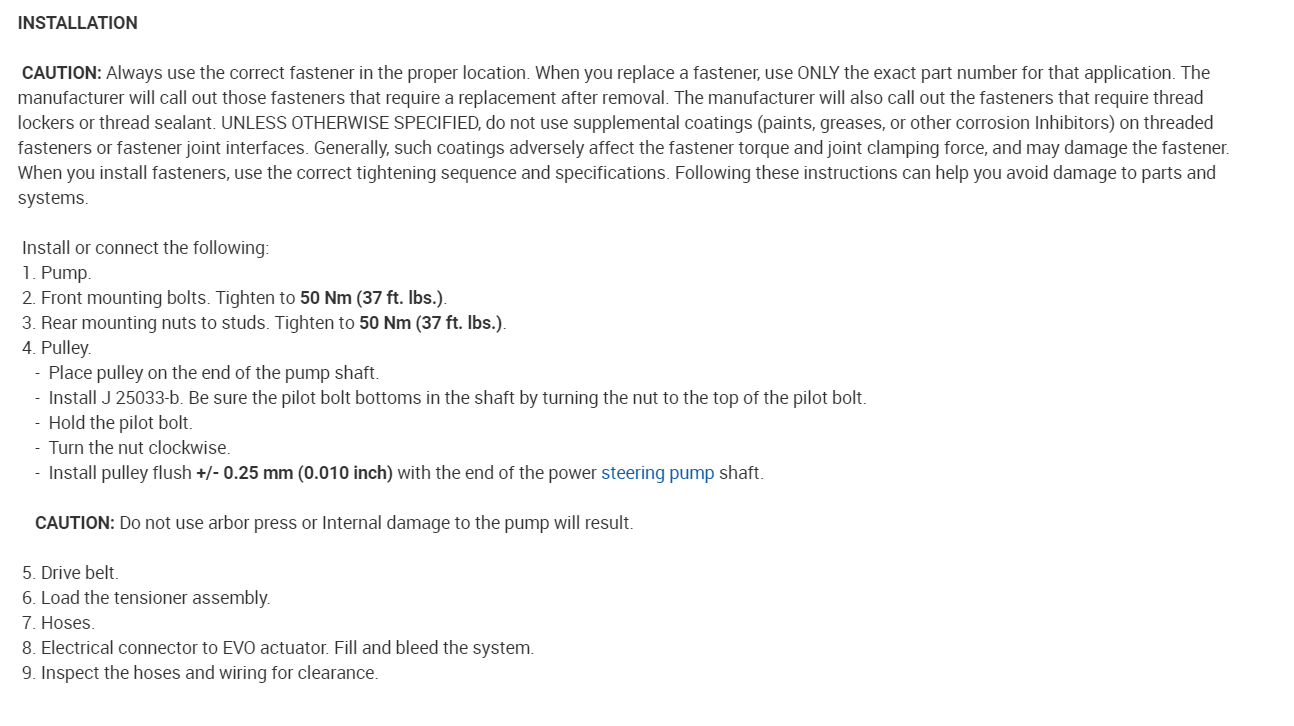

I replaced my power steering pump a couple months ago and the other night I about got stuck out in a pasture and I had to hit the throttle pretty hard to get out of the mud and after that no power steering. any thoughts?
Jul 9, 2023 at 8:08 AM
  • 55,858 POSTS
It sounds like you have a defective pump, can you hear the noise of the engine change when you steering the wheel? If not, I would say the pump is bad. Here is a guide to help and I have included how to change the pump out in case you need it:
https://www.2carpros.com/articles/power-steering-problems
and this will show you how to remove the pump pulley:
https://youtu.be/MtHG4y_rdMI
