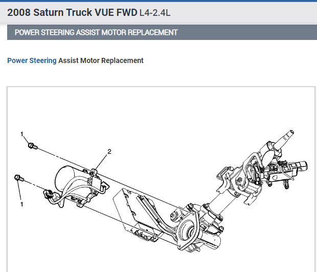

Works fine over 20 mph. What is the problem and how do I fix it?
Jan 23, 2020 at 8:57 AM
DANNY L
  • 5,648 POSTS
Hello, I'm Danny.

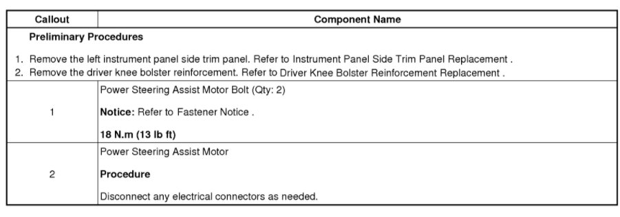

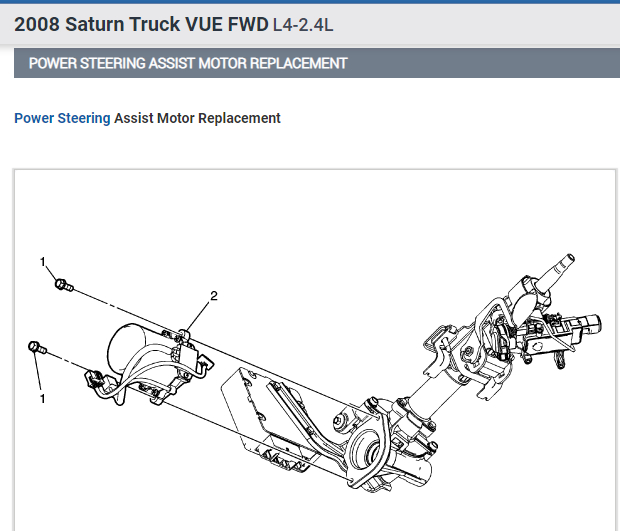

It sounds like you are having an issue with the power assist electric motor. This helps assist steering at lower speeds. Here is a tutorial showing how to test electrical wiring if needed:
I've attached two picture steps below for power steering assist motor replacement for your car. Hope this helps and thanks for using 2CarPros.
