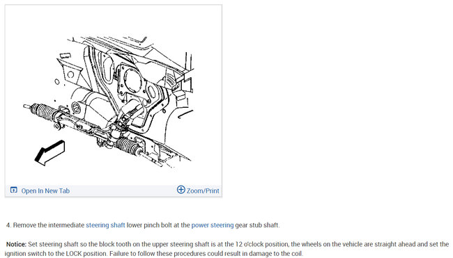

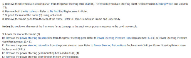

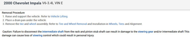

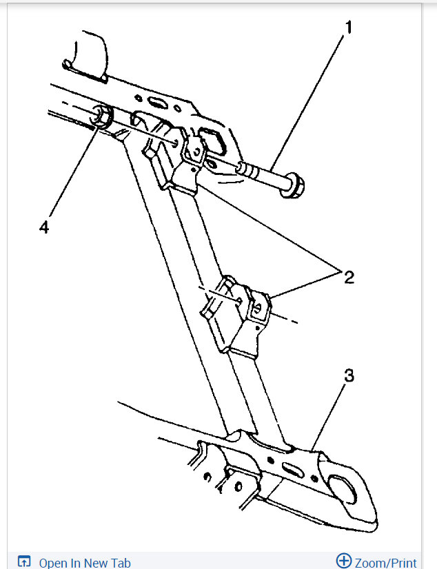

I would replace the steering rack because the selector valve that is worn and bypassing which pushes the seal out, nothing you can do. here is how the job is done, and you will need to get a wheel alignment once completed. Check out the images (below). Let us know how it goes.

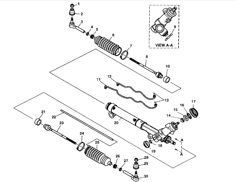

I'm not sure which seal you are referring to. I attached an exploded view of the rack and pinion below. Do you see the seal in the picture? If so, what number is it in the legend provided in pic 2?
There is a pressure flow valve. The flow control orifice is a component of the pressure line fitting. A pressure relief valve inside the flow control valve limits the pump pressure. However, that should have been included with the new pump.
Oct 16, 2024 at 12:23 PM
BENDATBOY
It's is #15. Yes, the pressure relief valve was included in the new pump. I removed it last night to see if maybe there was some debris in it but no such luck.
