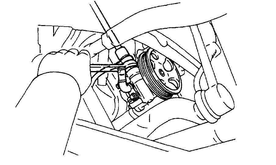

is it possible you can shoot me a diagram and instructions to removing and replacing the power steering pump? this is a 4 cylinder Highlander the power steering is on the side of the engine. thank you in advance.

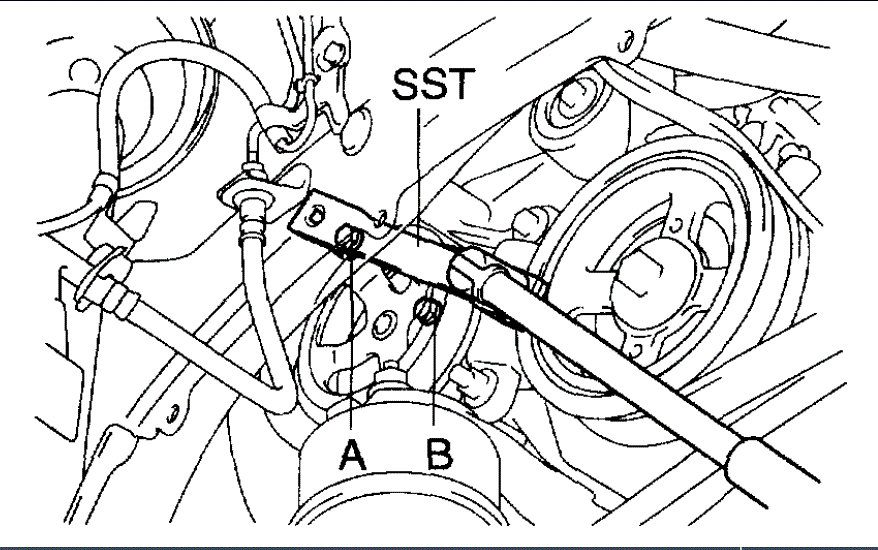

Okay, I attached the procedure for you.
I would bleed it again as it may just have some more air in the system.
I attached a YouTube video for you as well. It is a little blurry but is on point.
https://www.youtube.com/watch?v=Pkpt7KPvC1A
NOTICE:
When using a vise, do not over-tighten.
When installing, coat the parts indicated by the arrows with power steering fluid.
1. REMOVE FRONT WHEEL RH
2. DRAIN POWER STEERING FLUID
3. REMOVE FRONT FENDER LINER RH
4. REMOVE FRONT FENDER APRON SEAL RH
5. REMOVE FAN AND GENERATOR V BELT
SST 09249-63010
6. SEPARATE OIL RESERVOIR TO PUMP HOSE NO.1
a. Remove the clip and disconnect the oil reservoir to pump hose No.1.
NOTICE: Take care not to spill fluid on the V belt.
7. SEPARATE PRESSURE FEED TUBE ASSY
a. Separate the connector from the oil pressure switch.
b. Using a spanner (27 mm) to hold the pressure port union, remove the union bolt and gasket.
8. REMOVE VANE PUMP ASSY
b. Using SST and a deep socket (14 mm), loosen the bolt A.
SST 09249-63010
c. Remove the bolt B and vane pump assy.
Oct 2, 2020 at 9:27 PM
