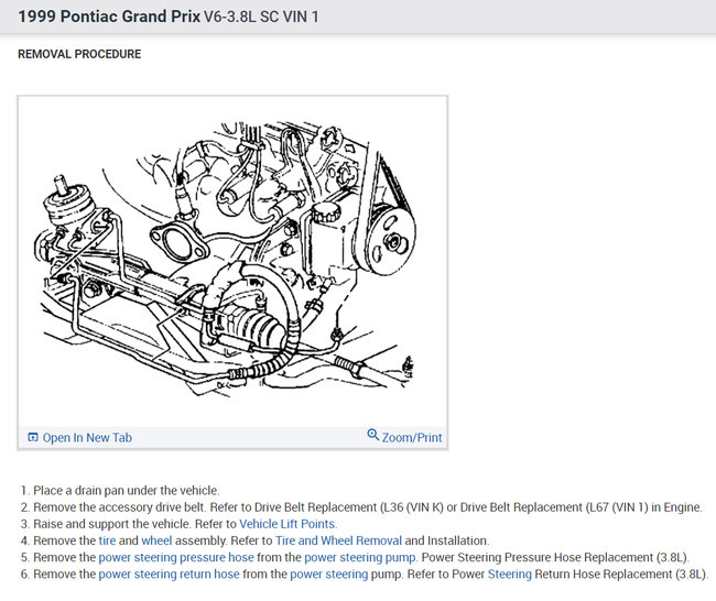

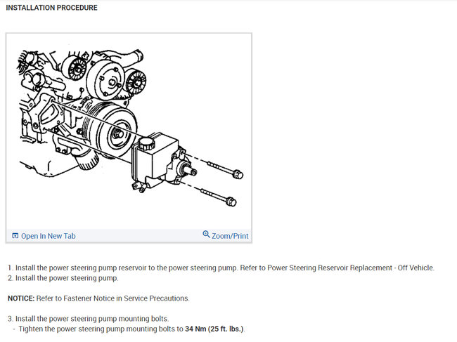

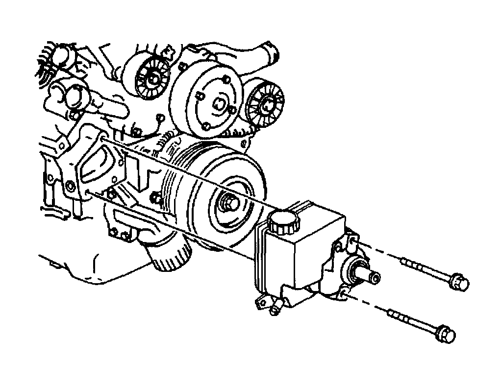

Power steering pulley came off. Pump is shot so now the belt is too big. I cannot afford a pump right now. Please tell me how to make this so I can drive it. I literally live in my car. At twenty three years old in a state where I know nobody. Possibly a shorter belt that will just go around and pass the power steering.
Aug 23, 2016 at 10:00 AM
SATURNTECH9
  • 30,869 POSTS
I do not see a belt listing for a belt without power steering. Also a shorter belt wont always work with the way the belt threads around the pulleys with one missing. Also running it without the power steering pump etc. I would have to say would not be good for your rack and pinon. It is designed to work with fluid and pressure. Not like a manual rack and pinon would work without all that. I get the bad situation, but I honestly do not see your idea really working out. Check out the diagrams (Below). Please let us know what happens.

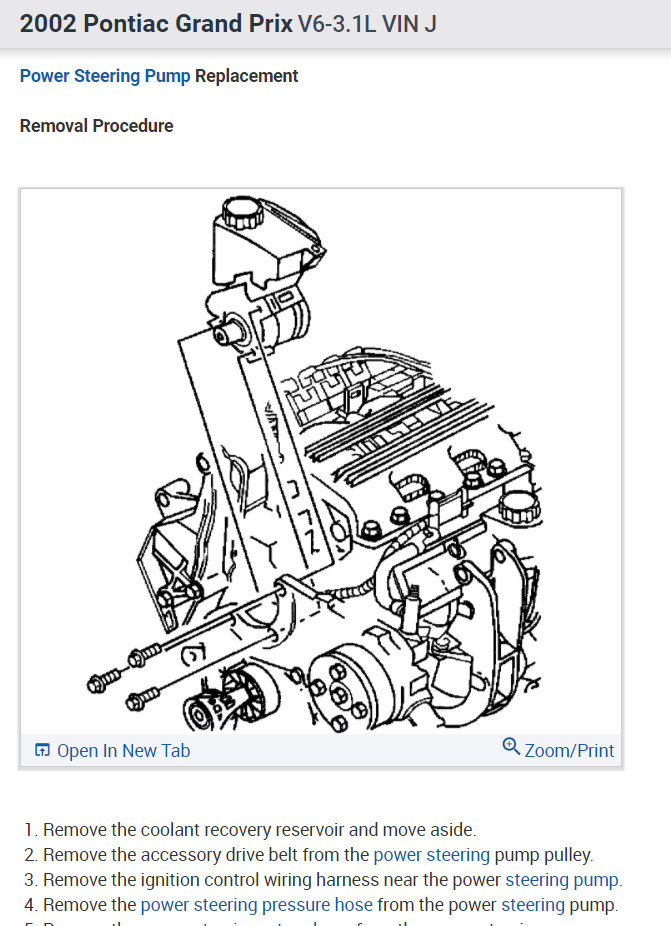

I replaced my water pump and I'm having a problem getting the power steering pump aligned to install it.
Dec 23, 2020 at 4:59 AM (Merged)
  • 110,244 POSTS
Do you mean the belt won't align or the pump itself will not align?
_________________________

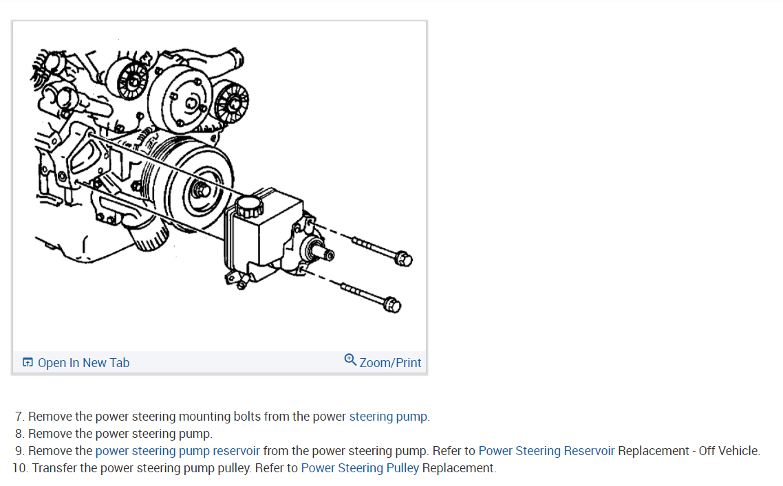

Here are directions for removal and replacement. See if anything here helps. The attached pictures correlate with the directions. Also, let me know if you remove the PS pump pulley.

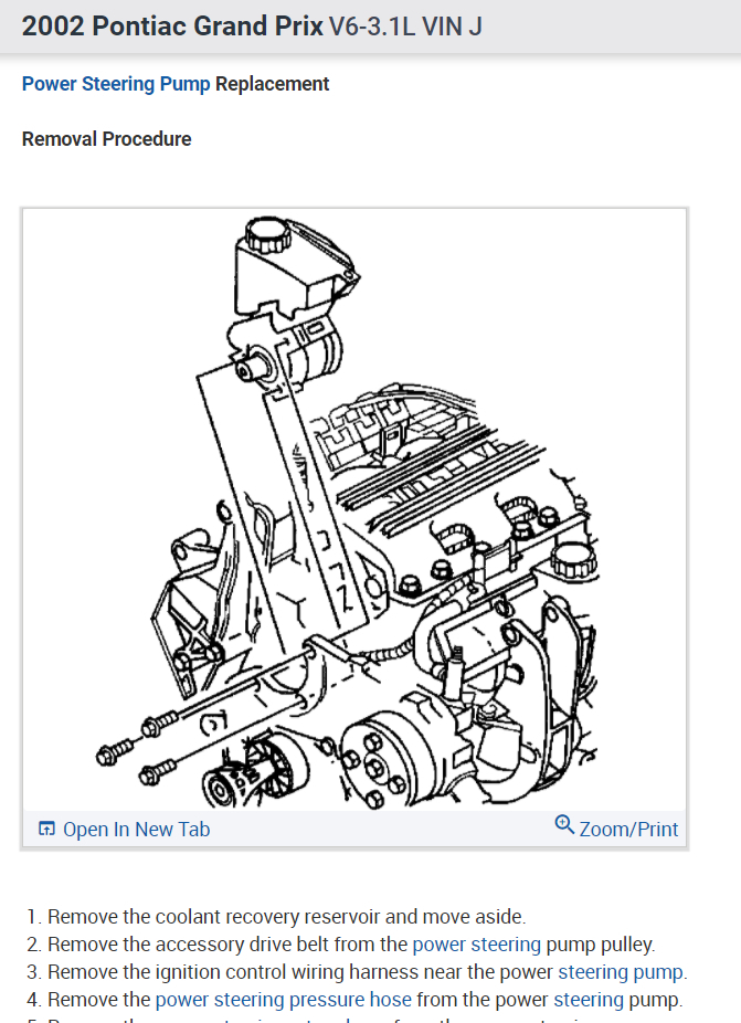

2004 Pontiac Grand Prix V6-3.8L SC VIN 4
Power Steering Pump Replacement
Vehicle Steering and Suspension Steering Power Steering Power Steering Pump Service and Repair Procedures Power Steering Pump Replacement
POWER STEERING PUMP REPLACEMENT
NOTE: The content of this article / image reflects the changes called out by TSB: 05-02-32-004.
Removal Procedure
1. Remove the accessory drive belt.
2. Raise and support the vehicle. Refer to Vehicle Lifting.
3. Remove the tire and wheel assembly.

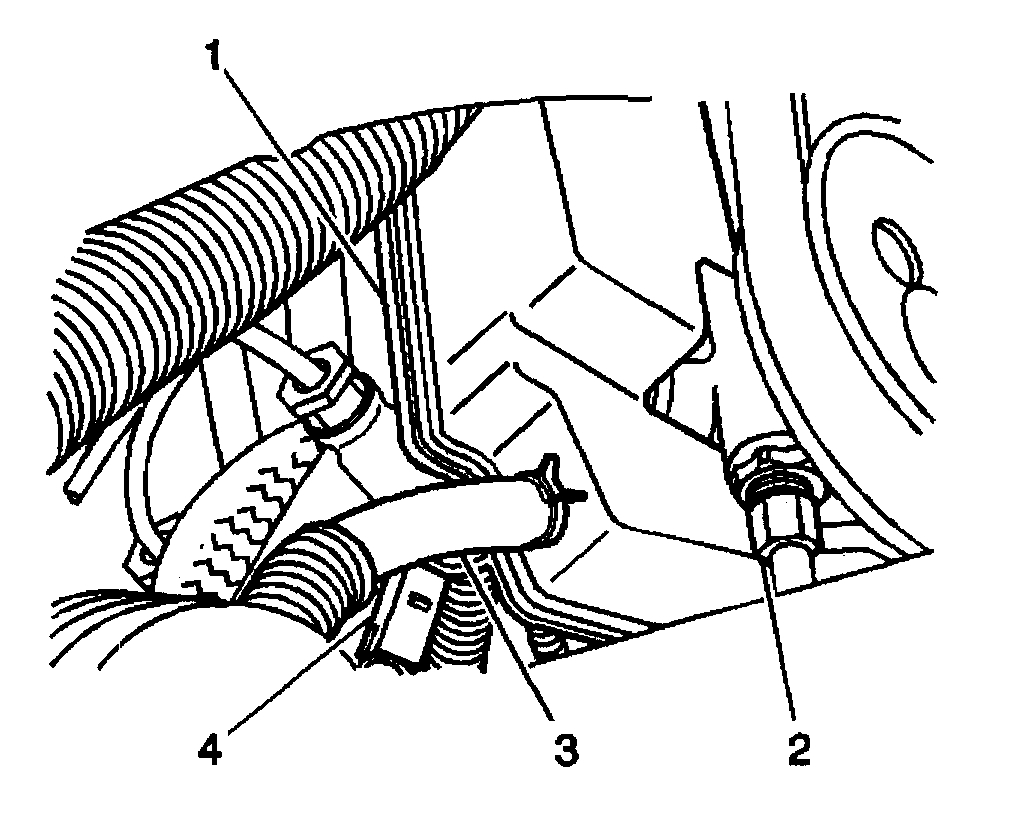

4. Disconnect the power steering pressure hose from the power steering pump.
pic 1
5. Disconnect the power steering return hose from the power steering pump.
pic 2

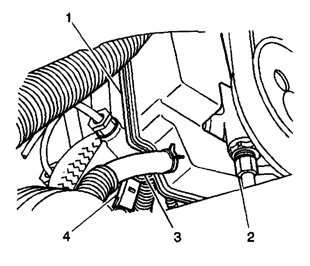

6. Disconnect the harness connector (4) from the power steering pump (1).
pic 3
7. Remove the power steering mounting bolts from the power steering pump.
8. Remove the power steering pump from the engine.
9. Remove the power steering pump pulley from the power steering pump.
10. Remove the power steering pump reservoir from the power steering pump.

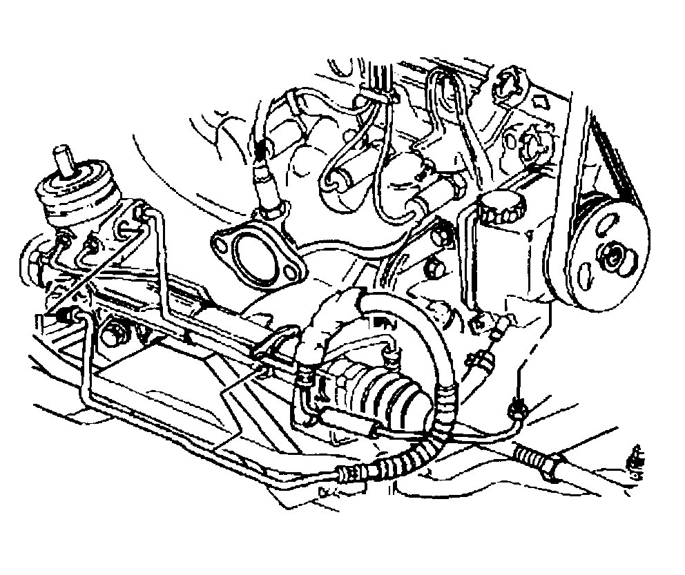

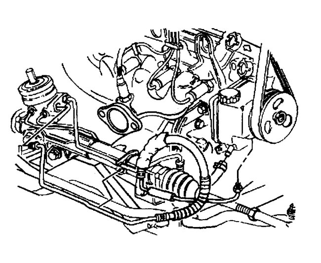

Installation Procedure

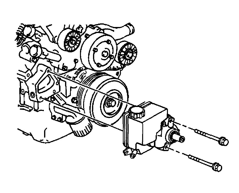

1. Install the power steering pump reservoir to the power steering pump.
2. Install the power steering pump pulley to the power steering pump.
pic 4
3. Position the power steering pump to the engine.
Notice: Refer to Fastener Notice in Service Precautions.

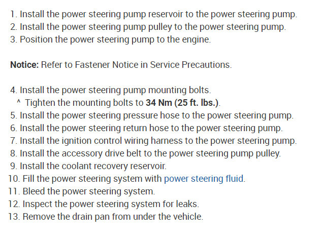

4. Install the power steering pump mounting bolts.
Tighten the bolts to 25 Nm (18 ft. lbs.).
pic 5

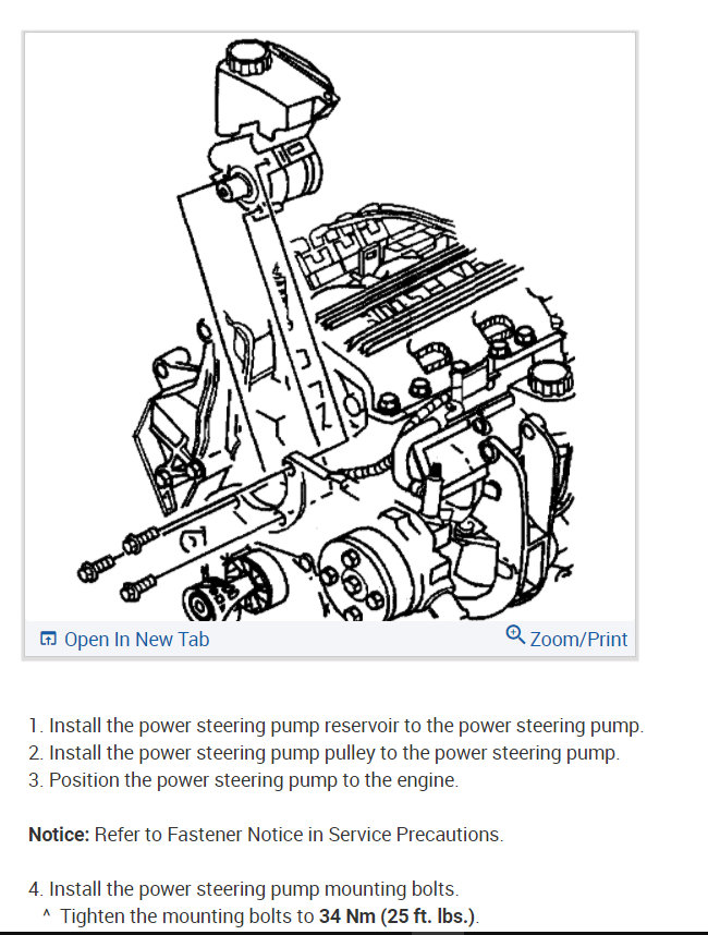

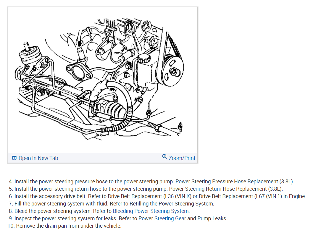

5. Connect the power steering pressure hose to the power steering pump.
6. Connect the power steering return hose to the power steering pump.
pic 6
7. Install the harness connector (1) to the power steering pump (4).
8. Install the accessory drive belt.
9. Fill the power steering system with fluid.
10. Bleed the power steering system.
11. Operate the power steering system and inspect for power steering system leaks.

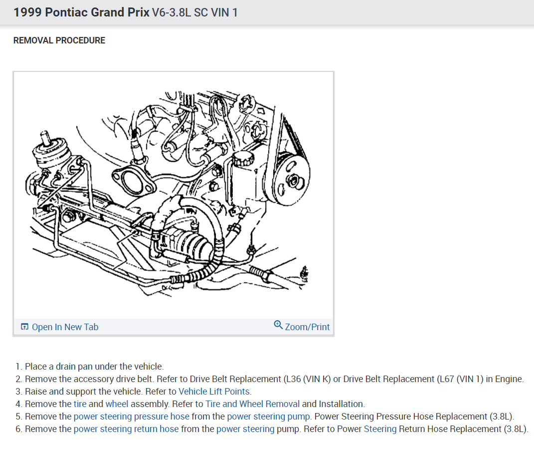

pulley comes off together with the pump. the hardest part of the job is getting the hoses off the rack at the bottom. i lower the cradle to acess the hoses.
you will need a puller for the pulley change when they are out. you can rent the puller at the parts store
