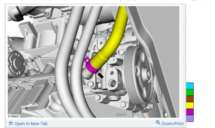

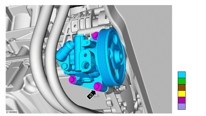

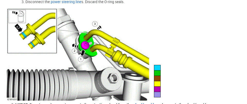

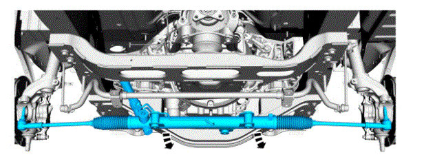

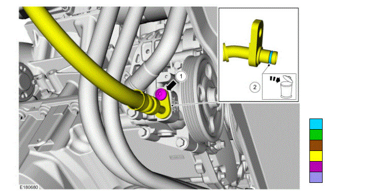

I tried a bottle of Lucas oil stop leak and refilled the power steering fluid, but it did nothing. There is no sign of leak.
Aug 31, 2020 at 12:34 AM
Good morning,
The stop leak was a bad decision. That stuff just swells the seals to try to get it to work again. The problem is it swells them so much that they break and then you have damage to the pump and the steering gear itself.
https://www.2carpros.com/articles/power-steering-problems
I would flush the system first to get rid of that stuff and see if it is any better.
https://www.2carpros.com/articles/power-steering-fluid-flush
If not then the pump and gear should be replaced.
https://www.2carpros.com/articles/how-to-replace-a-power-steering-pump
I attached pictures of the pump and the rack assembly for you.
Aug 31, 2020 at 12:57 AM
